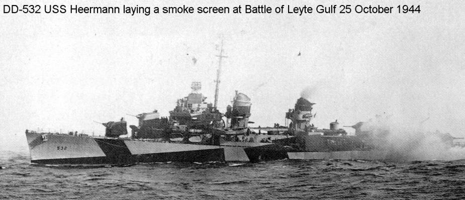

Hi, and sorry to bother you. If this is not the correct place to ask this question, I apologize. My wife’s grandfather served on board a Fletcher class destroyer (the Heerman) and my wife and I would really like to build a 1/200 scale model to present to her father in honor of his memory. I am planning to build her as she appeared during the battle of Layte Gulf/ Taffy 3, and I was hoping for some confirmation on what fire director/ fire control radar she carried at the time? I have a photo supposedly taken during said battle, was told that sometimes wartime sensors intentionally altered photos (attached to this post). I was told people in this forum would likely be able to help me?

USS HEERMANN (DD-532) would have had the Mk 4 radar on her Mk 37 director. She wasn't updated to Mk 12/22 radar on the Mk 37 director until the overhaul she had after the battle and completed in early January 1945. This a famous photo of HEERMAMM and has been published often. If this photo had been censored, the radars would have been totally masked out. The air search radar was the SC-2 family and the surface search radar was a SG-1 radar.
