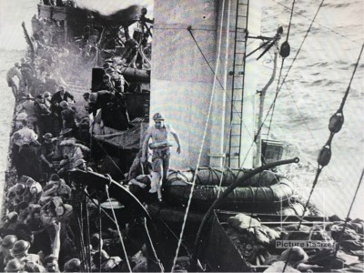

Hello all,
I am continuing my 1/35 scale build of the HMAS Waterhen and wanted to ask the experts about this photograph. I am currently constructing the intakes behind the forward funnel. In this photo of the chook you can see what looks to me to be a heap of tarps stored on top of the intakes in the bottom right of the image with the two carley rafts behind them. Does anyone know anything about what was stored on the intakes like in this image. Did it have rafts stored on top of that with the tarps below - they were in the process of abandoning her.
And can anyone tell me the size of the two carley rafts stored behind. I am going to get them 3D printed and wanted to get the right ones.
Many thanks, Will

This is your best bet for the Carley Rafts - :cool_2:
https://www.shapeways.com/product/Z8ENZ ... d=63997272
Micro Master ( very , very good Shapeways designer ) _ I recommend you choose the very BEST printing material you can choose
as it makes a big difference , when you come to make the model and paint it .
The size was standard for Destroyers , it only was made larger with Battleships and Cruisers
( Simon will know the size for you - and work out a 1/35 scale size from that , for you )
Now , as regards your question -
I can actually help you as I have HMS Walpole line drawings PDF's which were supplied by the NMM , Greenwich
on top of the intakes , which were ventilators - was stored 1 Carley raft , then later 2 Rafts ( as seen in the photo )
( 1 used to be mounted on a frame at an angle to the aft funnel ) -
if you have any further questions PM me and I will try to help
kind regards
David

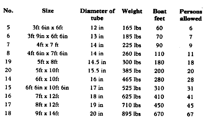

PostPosted: Sat Feb 17, 2018 2:57 pm
Posts: 345
The photo shows 2 different sized carley floats, If you require accuracy, the only way is to do a foot size calculation, based on the image.
You will never know the exact size of the floats used.
The John Ashton report will pretty much explain everything about carleys, there were 11 different sizes.

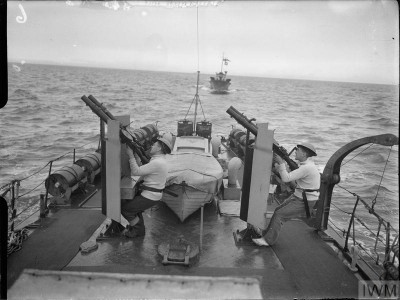

In relation to a previous enquiry about secondary armament mounted in HMAS Waterhen`s bridgewings.
Since that posting, a fine image has come into my possession which clearly shows that at the time off her loss in 06.41, she was fitted with twin guns in the bridgewings.
The attachment shows the reduced image, and the cropped area in question, the guns appear to be twin Lewis fitted with radiator shrouds, a shield appears fitted.
These splinter shields may have been fixed, but would more likely have been part of the pedestal as shown in the IWM shot.
Hope this answers the question, which until now was never known for sure, Waterhen Wartime shots are rare.

I think you will find David, that the pedestal bases in the IWM image are bolted to the deck, but the gun pedestal assembly rotates on the C.P.
The guns including the shield rotate as one, including the gunner strapped to the assembly.
The IWM guns differ from this twin gun which is independent from the fixed plate shield, and is bolted on the deck in front of the guns.

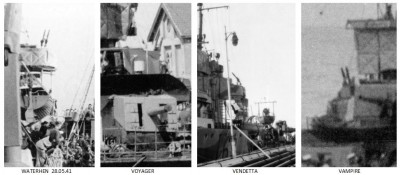

PostPosted: Tue Jun 19, 2018 5:49 pm
Posts: 345
On further study, I agree Will.
Whilst serving in the Mediterranean, all 4 RAN V/W`s were fitted with twin Lewis on lightweight pedestals in the bridge gunwings.
No shields fitted, with the exception of Vampire which did have shields.
Other images of Vampire show that her twin Lewis initially had no shields, they were fitted later and were probably fixed to wing platform in front of the guns.

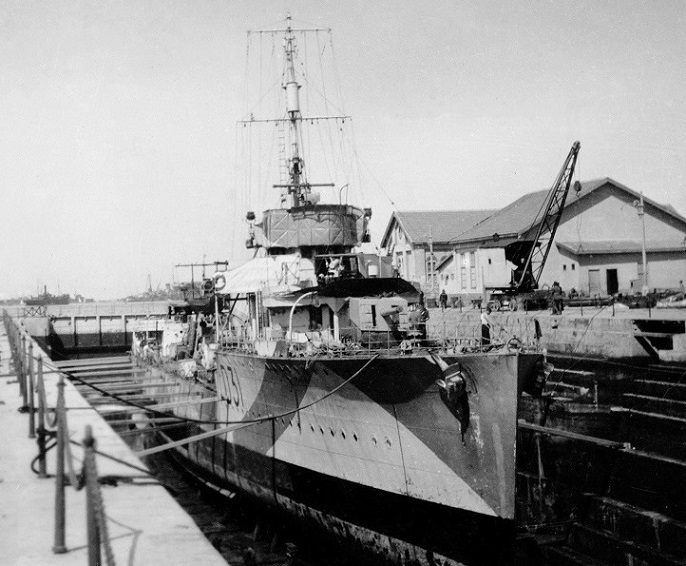

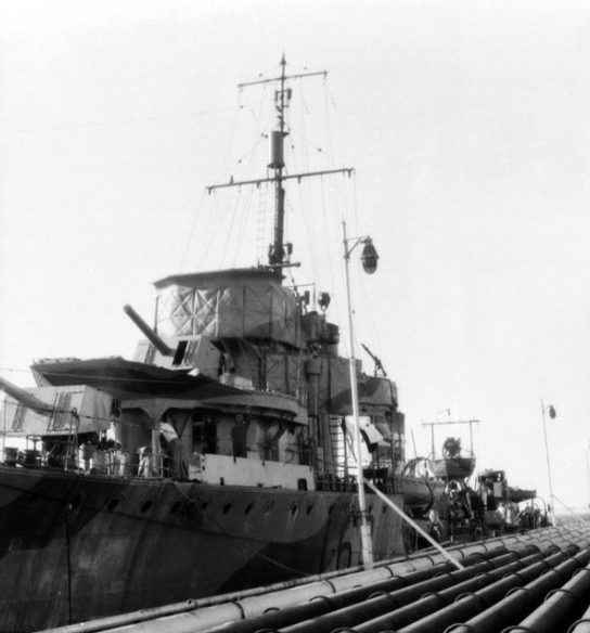

PostPosted: Wed Jun 20, 2018 6:37 pm
Posts: 345
Here you go Mike,
Voyager in Alexandria DD 41, NHSA hi-res cropped and reduced.
Vendetta, AWM shot. The original image is reversed and the location is incorrect, whilst wearing this scheme she was never in Napier.
Dated approx. mid 41 somewhere in Med.

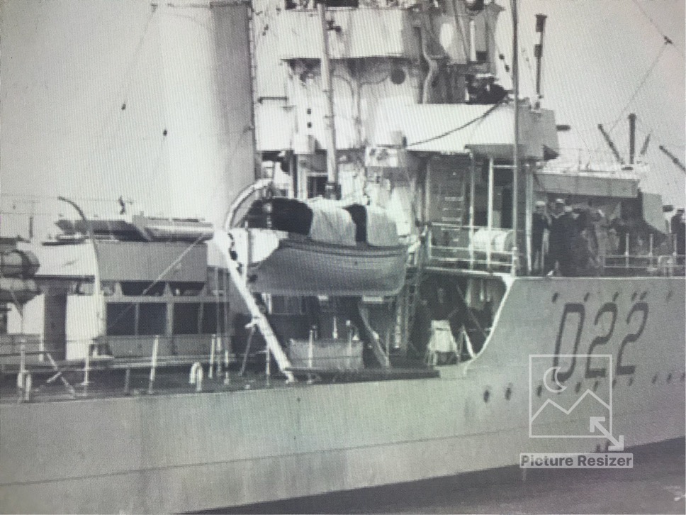

PostPosted: Thu Jun 21, 2018 7:32 am
Joined: Sat Jan 14, 2017 4:51 pm
Posts: 162
Location: Hill End, NSW, Australia

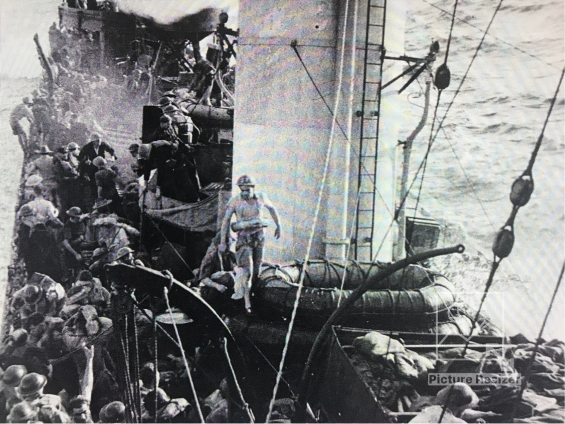

Great pictures Brett,
do you have any of the Waterhen. I put her name in the search engine and come up with the same photos but I just now did a search "stern of the HMAS Waterhen" and got this great photograph. Does anyone know what is sitting on top of the air intakes, is it a pontoon of some kind. The structure beneath it is canvas sided with tarps inside - you can see it in one of the photos taken onboard as she is sinking but the pontoon like thing is not there,
cheers, Will

PostPosted: Thu Jun 21, 2018 7:37 pm
Posts: 345
Perhaps a correction to the date of the Voyager DD image, just working through this issue with Michael B at the moment.
The pennant flag Superior may have changed from `D` to `I` in the 3rd quarter of 40, somewhat difficult to pinpoint exactly.
If correct, the image is dated before 1940 3rd quarter, Never trust captions.
A larger but less crisp drydock image of the Voyager was/is contained within the archives, the search engine does not grab it, typical, so long haul to find.
BTW Will, you will find a better image of Waterhen you posted, in the ship history section, it contains the chook and also Vendetta.

Thanks for that Voyager photo Brett. I am sure that you will tie down the exact date of the docking from Australian sources but as general point the Mediterranean Fleet War diary reports the repainting of the Med Fleet into the patterned camouflage as seen on Voyager at the beginning of August 1940 (7th August 1940 diary entry re 5th August 1940 order to the Fleet) so the photo could be mid/late 3rd quarter of 1940.

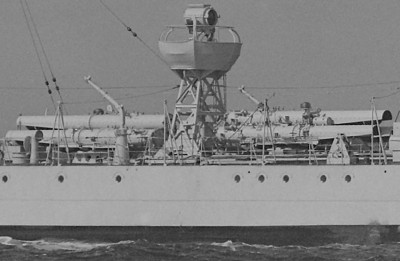

PostPosted: Thu Jul 12, 2018 5:35 pm
Posts: 345
Waterhen`s aft set of TT landed in Jan 41, 12 pdr and single Breda mounted in place, refitted at Port Tewfik.
Lewis guns fitted late 39, Quad Vickers fitted early 40 replacing single 2 pdr.

Thanks for that Brett. What type of weapon was the aft set of TT you mentioned?,
Cheers, Will
PostPosted: Thu Jul 12, 2018 7:55 pm
Posts: 345
Torpedo tubes
