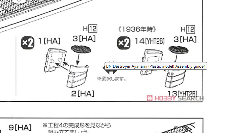

Early and late war main masts. A shame that they did not include PE torpedo loading gantries.
As to the funnels, it appears that sprue T2B offered the as-built, taller funnels. These were cut down by approx. 1 meter during the 1936 refits. (Instructions courtesy on HobbySearch Japan.)

Great point as always Dan, thank you!
I only now noticed that the PE fret lacks funnel caps as well. Really weird selection of parts here.

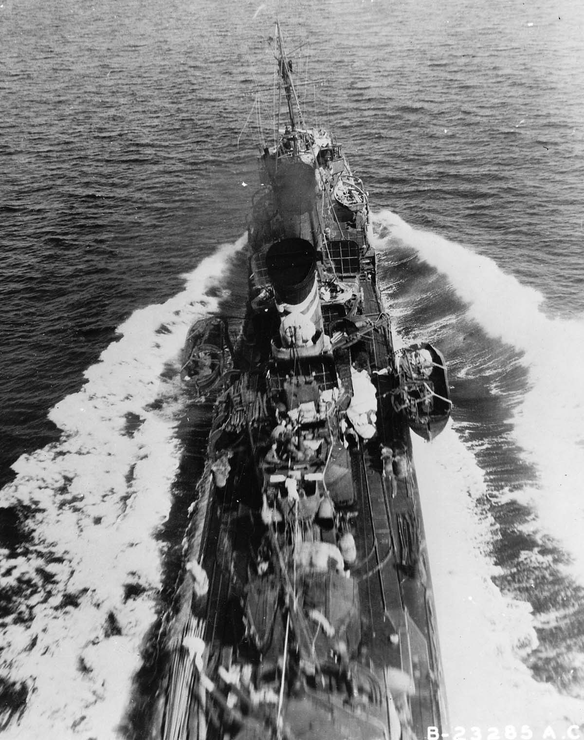

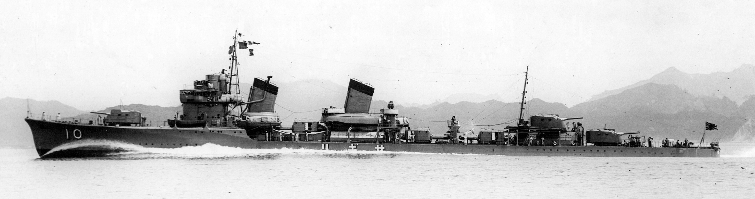

Sorry, didn;t see this until now.
1). The WoW layout is more correct, particularly around # 1 turret. The brown decking is linoleum.
2) Most Japanese sources indicate that the Type I s entered the war with a twin 13mm mount in front of funnel #2. Please see the Shinonome photo below. (btw, Shinonome is in drydock to repair collision damage to her torpedo reload girders.) Fubuki's last dockyard visit was in April, 1942 for maintenance, so I think it unlikely that her AA fit changed before being sunk.
3) The davits for the small motor launch aft on the starboard side should be moved forward slightly in the Tamiya kit, so that #2 TT mount can rotate and fire. See the Shirayuki photo below. Side views show the boat to be raised OVER the height of the tubes, so there was clearance.
HTH.
