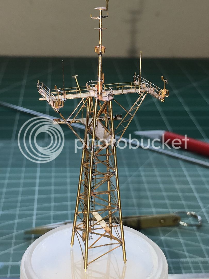

I use two soldering stations. One for tinning the other for assembly.
The Hako 936 is a great all around soldering station with different tips available. Right down to a needle fine tip that I use for soldering nano LED's.
The American Beauty resistance soldering station is now a tool I must own. I borrowed it from a friend to use on this project. It would not be possible to build it with out it.
I had never used one before now and didn't think it was anything I needed because I had the Hako. Boy was I wrong. I now fully recommend it for anyone building photo-etched assemblies.
It makes things possible that that would have been difficult if not impossible before. The one in the picture has what the call the pliers end. The one I used has the probe end which are tiny and act like tweezers
Here is another item that is nearly done I used both irons for. This is the main mast of the OHP.
I knew that they had to be soldered just for strength as I have a hbit of breaking assemblies I glue together and as there were so many parts to these it was a must.
Thanks
Tom

steel_tiger1 wrote:I use two soldering stations. One for tinning the other for assembly.
Thanks
Tom
Tom or anyone else, how did you get that second platform into the mast?  I'm guessing following PONTO's picture instructions was a mistake as I'm unable to slip it in as suggested and possibly looking like it will have to be dismantled, slip the platform in and then somehow reassemble but the more I think about it this could turn into a nightmare.
Gerry
steel_tiger1
Posts: 46
Joined: Sun Jun 12, 2016 6:56 am
Re: Calling all Oliver Hazard Perry class FFG fans
Post by steel_tiger1 »
Gerry I don't remember exactly. But I am pretty sure I just followed the directions.
