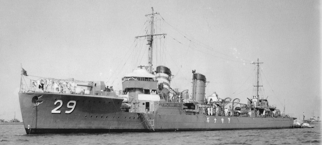

And another...........

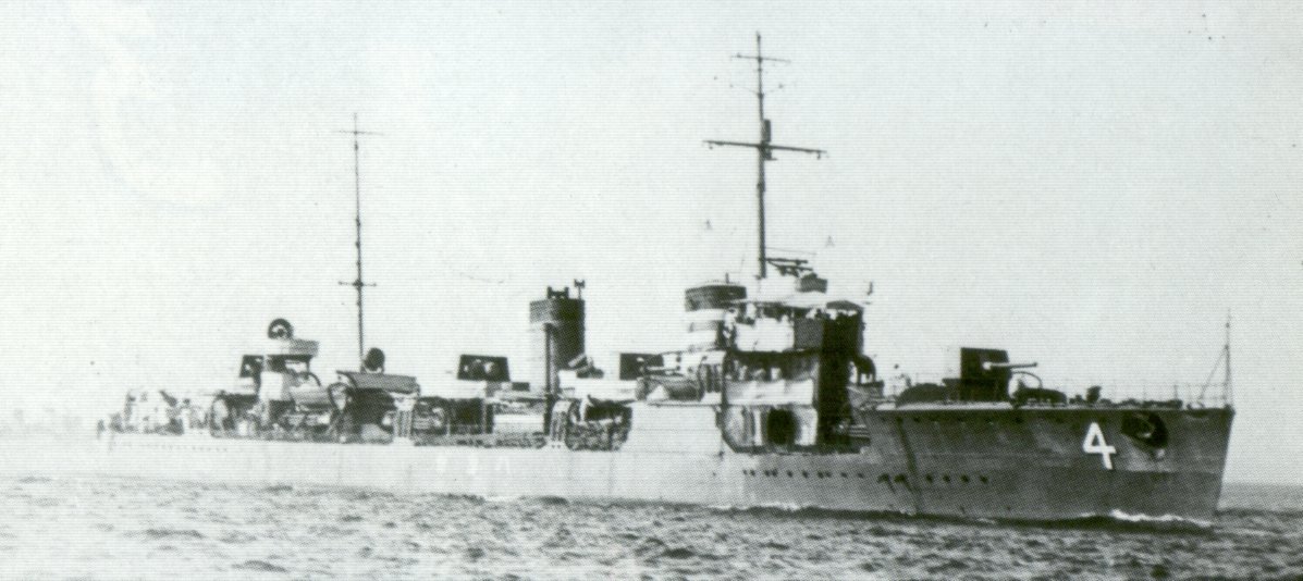

Perhaps he is. I tried to attach a photo scan (Minekaze or Kamikaze class, not sure). but I don't think it's working.

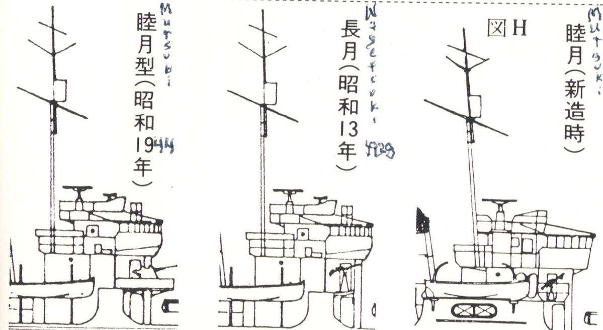

This set of three drawings of Mutsuki class DD may be relevant.
File comment: Mutsuki bridge detail

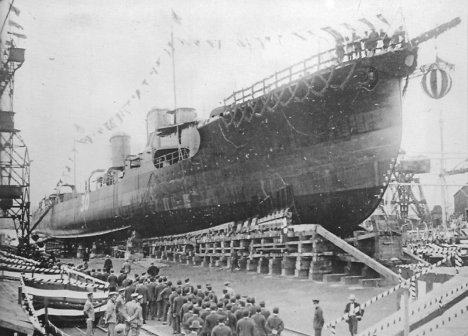

PostPosted: Tue Jun 30, 2015 12:03 pm
Posts: 8844
Nope, no cross-section info. available on the Mutsukis in my references.

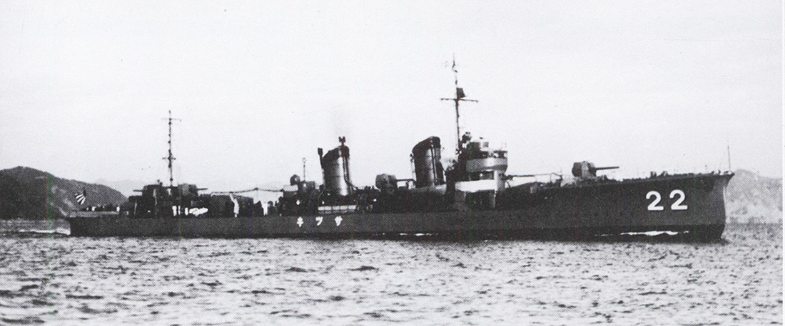

You may have better luck with the Gakken volume. It does carry several fit illustrations for Satsuki. What year?
Photos of her are slim. This is 1935, after modernization
