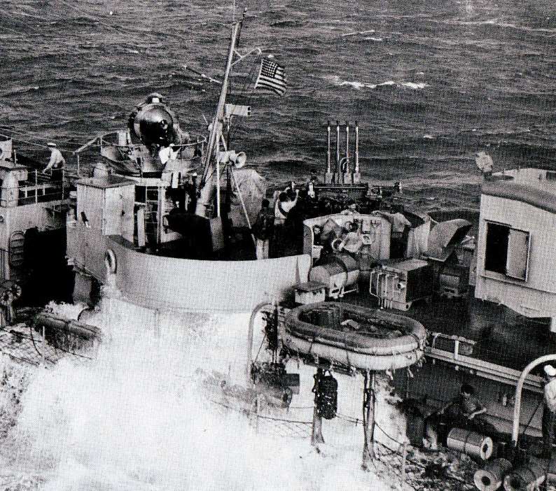

Thanks to Dragon's generosity (intentional or not) the Lafferty 1942 kit contains enough optional superstructure and funnel parts to build several early and late ships of both Benson and Livermore classes. So my Lafferty has become the Hobson in 1942 -43 camo, as pictured above. I have only two general pics of Hobson so I am relying mostly on my Buchanan book for detailing, although I realize details varied from ship to ship. On Buchanan's after superstructure (1942) with the quad 1.1 and Oerlikon there is, within the large splinter shield, and directly forward of the two guns, two tubs app. 4 -5 ft. in diameter, and 2 - 3 ft in height, and apparently nothing fitted in them yet at the time the photo was taken. Dragon would have you install a Mk 51 designator in each. I thought these target designators were only used with Bofors, but I may be mistaken. Were the Mk 51's used with the quad 1.1's, and were there two of them? I know the Oerlikons didn't require them.
- Posts: 3880
Yes the Mk 51 was used with quad 1.1-in mounts. The question is which BENSON-GLEAVES class units actually had a Mk 51 director and when was it installed. The layout of tubs on the aft deckhouse shows the plan to install two twin 40-mm mounts and two Mk 49 directors as planned in late 1941.
The reason that the 40-mm mounts weren't installed on destroyers until 1 July 1942 was the lack of a director. The planned Mk 49 director development was delayed and the MK 51 director was an interim measure as was installing a quad 1.1-in mount. But, the Mk 51 directors weren't available for installation until 1 July 1942. So virtually all BENSON-GLEAVES units didn't have a director for the quad 1.1-in mount as completed. However, particularly for Atlantic-based units, Mk 51 directors started to appear on BENSON-GLEAVES units in September-October 1942. I think most (but not all) of the quad 1.1-in mount equipped destroyers involved in Operation Torch had a Mk 51 director installed. However, for the the Pacific-based quad 1.1-in mount BENSON-GLEAVES units it is uncertain if they ever got Mk 51 directors installed. It is hard to see in photos if a Mk 51 director was installed among the clutter on the aft deckhouse. Part of the reason is several units were lost early before a yard period and most others were upgraded with twin 40-mm mounts during their first yard period. Even the East Coast BENSON-GLEAVES units started to be upgraded to twin 40-mm mounts in early 1943.
However, please note that there was only ONE Mk 51 installed ... directly in front of the mount. Also, something that doesn't show-up in DML kits and was a common install on units with quad 1.1-in mounts, was a ready-use ammo cabinet where that other portside director was to be mounted just forward of the 20-mm gun. In the September 1942 photo of HOBSON, I don't see a director or the ready-use cabinet. The attached image shows an Operation Torch GLEAVES class unit (unknown which one) with a quad 1.1-in mount and a Mk 51 director (covered in canvas) and the ready-use ammo cabinet. By Operation Torch, HOBSON "likely" had a Mk 51 director installed. She may have repainted into Ms 22 as well, but not as likely.

Thanks for the info Rick
. As there is no structure higher than the splinter shield visible, whatever is there is up to speculation. On the side of practicality, leaving the empty tub on the port side would be a waste of space. Maybe replacing it with a double ammo locker would be more practical. BTW, could the 1.1's use the same type of ammo locker as the Oerlikons?
- Posts: 3880

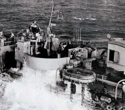

I assumed, but don't know for sure, that the cabinet forward of the portside 20-mm gun was for "ready-use" 1.1-in clips. Cabinets were used on the main deck on some destroyers for 20-mm magazines, so it could be for 20-mm magazines. So I wouldn't worry about what it is used for and photos don't show very well the layout on the deckhouse once the cabinet was installed. I have posted several images in this thread showing the deck layouts as completed (minus the cabinet) for units equipped with the quad 1.1-in mount.
I posted this image because it is the best one I have seen for this area showing a lot of the layout on the aft deckhouse.
