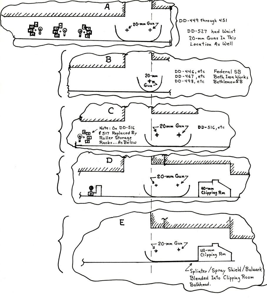

PostPosted: Sat Dec 03, 2011 4:00 pm
Joined: Thu Nov 20, 2008 10:52 pm
Posts: 377
Location: Tuscon, AZ
Happy Holidays all.
Got another fletcher question. I picked up a 1/350 tamiya fletcher for 5 bucks. and see it is a round bridge early. I am curious as to the armament config for the De Haven and Strong in 1943 in Kula. Ive looked at DH and navsrc but cant really see. also what equipment is on the bridge wings??
I think Strong ---- and De Haven
had this
51 ----- 51
52 ----- 52
single 20mm P/S ---- twin 40mm P/S
53 ---- 53
TT ---- TT
single 20mm P/S ----- 2x single 20mm P/S
TT ---- TT
54 ---- 54
twin 40mm up top ---- twin 40 up top
55 ---- 55
twin 40mm ---- 3x single 20mm

PostPosted: Sat Dec 03, 2011 6:41 pm
Posts: 3841
$5 for a Tamiya FLETCHER is a great price!!! I thought my getting them for $12-15 at swap meets was a great price.
Actually, both STRONG (DD-467), lost on 5 July 1943, and De HAVEN (DD-469), lost 1 Feb 1943, were both still in the two twin 40-mm configuration with a fantail twin 40-mm installation. The 20-mm armament varied between the two however.
For reference, here is a good link with the general layout of these two as commissioned ...
... http://destroyerhistory.org/fletchercla ... &pid=46704 ...
De HAVEN arrived in the South Pacific in early December 1942 (@ Noumea), she and SAUFLEY (DD-465) were the 4th and 5th FLETCHERS to arrive in the War Zone. De HAVEN departed the East Coast (in October) with the then "standard" 20-mm armament of four 20-mm guns; two before the bridge on 01 deck and two amidships - one per side on the main deck. The authorized number of 20-mm guns kept going up for FLETCHERS in late 1942 and additions were made locally to several FLETCHERS. The few available photos of De HAVEN shows an interesting and maybe unique arrangement. She had TWO 20-mm guns added atop the pilothouse instead of the normal single 20-mm added on the centerline atop the pilothouse. These two 20-mm guns were mounted at "about" the location where the two Mk 51 directors were added later on FLETCHERS getting the forward twin 40-mm mounts. At the time of her loss it appears that she had only six 20-mm guns.
STRONG left for the Pacific in late December 1942, arriving at Noumea on 27 January 1943 during a month when nine FLETCHERS arrived in the South Pacific War Zone. She was one of several FLETCHERS that took part in the North Africa invasion by escorting convoys and returned to the East Coast for some updates prior to heading to the Pacific. During her duty to North Africa, she had the same four 20-mm configuration that De HAVEN had. Between updates on the East Coast and guns added locally in the South Pacific, STRONG had the max "authorized" eight 20-mm guns for FLETCHERS with the two twin 40-mm (one on fantail) configuration by the time of her loss. Her eight 20-mm guns were located; two before the bridge at 01 deck level, one on an elevated platform on the centerline before the bridge, one atop the pilothouse on the centerline, and two per side amidships on the main deck.

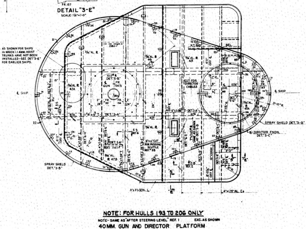

For either case, you will need to scratch build the lower twin 40-mm "tub" installed between 53 and 54 mounts. The kit comes with the fantail twin 40-mm installation. I will have to double check the data I have, but the 20-mm installation on STRONG I believe fitted the "standard" locations. The admidships main deck 20-mm guns were relocated from the earlier location seen on FLETCHER ... the had removed the aft 20-mm guns to go to the total of four 20-mm guns (like on De HAVEN) and when they then added them BACK, they were installed before the existing single 20-mm guns.
Somewhere among the 40+ pages in this thread I have posted images of the drawings/images for the elevated centerline platform and the 20-mm guns and bulwark layouts for the different configurations that would apply for these two ships. Scratch building those shouldn't be too difficult.

PostPosted: Sat Dec 03, 2011 8:39 pm
Posts: 3841
Eugene,
STRONG and TAYLOR were pretty close to being in the same configuration with the eight 20-mm guns being in the same locations.
Here is the drawing of the evolution of the waist main deck 20-mm gun locations on early FLETCHERS. On STRONG and TAYLOR, likely they just added the 20-mm gun forward of the "B" single 20-mm location instead of moving the existing mount forward as shown in "C".
Here is the elevated centerline platform and the centerline 40-mm mount "tub" between 53 and 54 mounts drawings.
