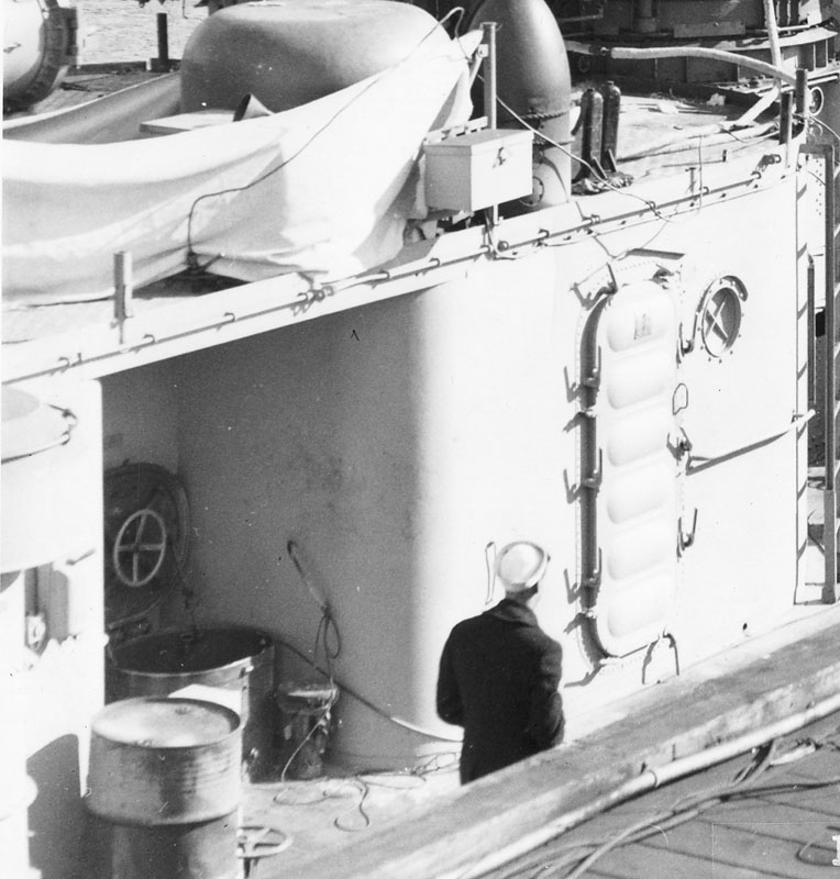

On the Sims-class midships deckhouse portside (the one which the torpedo tube mounts are installed on), there is a notch there. Does anyone know what is inside that notch? Her plans show a scuttle at the main deck level, but is there anything else there? Is there anything on the bulkhead sides, like portholes or other hatchways? My plans don't show anything there on the notch's walls.

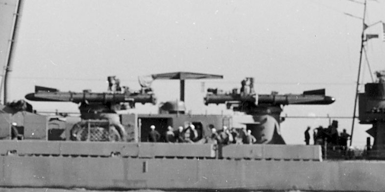

Does this port-side photo of DD411's torpedo tubes include the notched area that you're asking about? (I'm having trouble seeing it--is it something more obvious looking down on the area?)
Dave K
PostPosted: Wed Jan 28, 2015 10:15 pm
Posts: 404
Yup, that's it, the dark rectangle or square with the sailor's head right in the middle of it. Look at Torpedo Tube Mount #1, the aft end of it, and go straight down. Its also below and to the left (forward) of the mushroom vent atop the deckhouse. Its an inset area in the deckhouse. I'm interested in any bulkhead furniture, hatches, and the like that may have been in there. The scuttle at deck level I know is there as per the plans, but its such a significant area relative to the overall size of the deckhouse that I have to think there's something more in there.
Bob

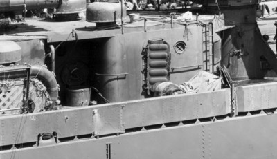

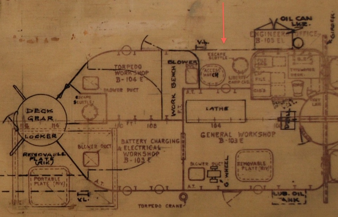

PostPosted: Thu Jan 29, 2015 1:24 am
Posts: 3318
This area is only on the portside. There is a hatch down to the engine room and an escape scuttle. Much of this deckhouse is taken up with workshops. See the attached from USS WAINWRIGHT's (DD-419) 1945 BGP. The inserted arrow points to the "notched" out area. None of the photos I have gives a clear view into this area to show what may be located on the bulkheads except for hand rails. According to the plans, there isn't any direct access to the workshops from this "notched space", so no doors. My guess is that this was done so that there was access to below decks with some shelter from the elements during rough seas.
PostPosted: Thu Jan 29, 2015 12:07 pm
Posts: 404
Many thanks! You're the best. I was able to pick out a porthole centered on the fore-aft bulkhead above the scuttle in a photo of Anderson, so I added that to the design. No doors though, is a welcome confirmation.
Thank you again!

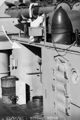

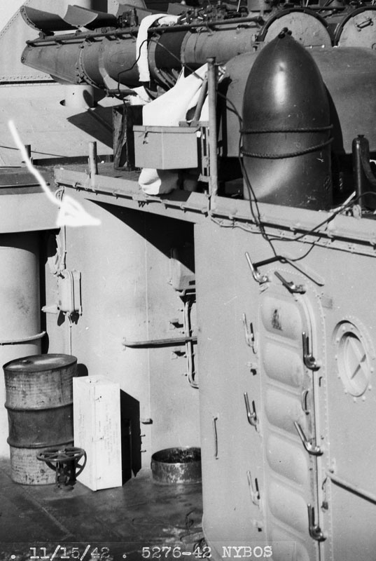

Here are two of the better photos I have of that area.
PostPosted: Fri Jan 30, 2015 12:36 pm
Posts: 404
Those are great, too. They'll help a lot, especially since they're 1942 photos before much was altered. In a number of the units, the deckhouse's roof line was built out as the war went on, so this helps a ton.
Thanks!
Bob

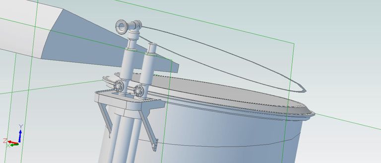

PostPosted: Fri Feb 06, 2015 6:29 pm
Posts: 404
Hi all,
I've been working on a Sims conversion and I'm wondering is anyone would like to check my work. I'm not a professional draftsman or anything, just a guy who fins this stuff fun. There's also a thread at the Virtual Ship Modeling part of the site, but I wasn't sure if any other Sims-o-philes had seen it.
Any comments on the parts? Where can I improve them? Given that this will be printed in 1/350th eventually, there is a practical limit to how far down the miniaturization scale I can take the little fiddly bits, and I've had to simplify a number of details, like the piping arrangements and the connectors anchoring the piping to the funnel, for them to have a chance at being printable.
The Photobucket album is here (http://s231.photobucket.com/user/aptiva ... t=4&page=1), and the most recent work is on these images:
http://s231.photobucket.com/user/aptiva ... sort=4&o=3
http://s231.photobucket.com/user/aptiva ... sort=4&o=5
http://s231.photobucket.com/user/aptiva ... sort=4&o=4
The funnel cap and gussets at the base of the funnel will be done in another CAD program after the rest of the details are nailed down, and there are pics of them in the other thread. The large mushroom vent in between the forward uptake legs will also be done. Is there anything else underneath the uptakes on the main deck level? My Floating Drydock plans really don't show anything.
Thank you for any pointers.
Bob
PostPosted: Mon Feb 09, 2015 12:35 am
Posts: 404
Here's the whistle platform with the large whistle installed. Thoughts? It seems that there were many little variations of the actual piping (this is getting to be a theme) so I just made a more or less generic piping arrangement and whistle. How does the whistle itself look? Is it reasonably accurate or acceptable given that there are some limitations to what can be printed?
Bob
PS. Please ignore the odd structures in the image. They're reference pieces which will be deleted in time.
