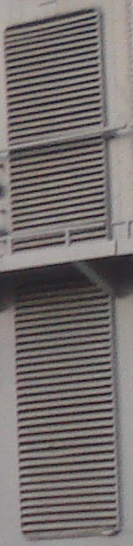

Dear Tony,
The grills looked something like the one in the picture. They had inclined blades (about 3/8" thick) at a distance of about 3/4" . There was also a vertical piece of metal in the middle oh each grill (can be clearly seen in the photo you posted)
The whole grill extended at about 2" from the surface of the funnel. The perimeter of the grill was welded to the funnel.
I cannot clearly see the grills at the pe gmm set nukemm has posted so I cannot help with that.
Why don't you cut 1mm wide strips of metal from a pe set and make the perimeter of the grills (sand the resin shaped "grills" off completely) and in order to make the horizontal grill blades use 1/700 step parts from generic inclined ladders ane atop the other so as to lessen the distance between the steps (two or three pieces of steps would do the job)
Ah, and somathing of minor importance, just to say things right:
The grills are the intakes of the forced draft blowers that provided combustion air to the ship's boilers.
