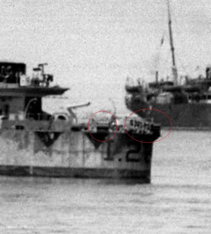

I am hoping this is an image of the HMAS Waterhen. Can anyone clarify and hopefully have a better quality copy of it?
Cheers Will
PostPosted: Wed Jan 11, 2023 6:58 am
Posts: 337
It is HMAS Voyager at Coffs Harbour, 8th Aug 1938.

Thankyou Brett,

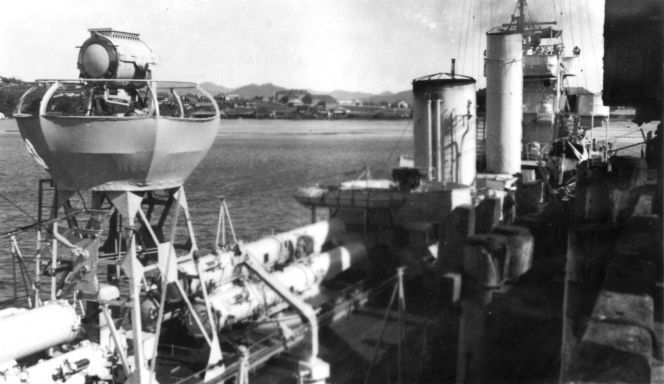

still gives some good detail for my Waterhen - was looking for what sort of equipment was inside the searchlight tower amongst other things,
Cheers, Will
PostPosted: Sat Jan 14, 2023 4:14 pm
Posts: 337
Will, the only equipment within the platform was the searchlight. From `as fitted` drawings it appears there were two sizes of that particular projector, 21" and 24" Waterhen was fitted with a 24" and it was still fitted when she went down. I do not know what Mk this WW1 vintage S.L. was, and full clear images of it`s layout are very hard to find. Here are two images of the projector, both are of V Leaders, there was an operator platform towards the base of the pedestal.
