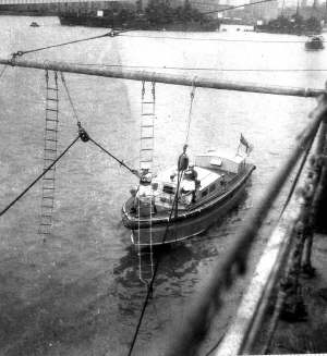

On Dreadnought, they are torpedo net booms - all of them would be rotated out and a metal net hung from them to catch incoming torpedoes. You'll see this on a lot of WWI and earlier ships.
On Bismarck, I believe they are just boat booms - can be rotated out and ladders hung from them to allow sailors to embark/disembark small boats without occupying the accommodation ladders.

its simply a boat boom.

They are rigged only, when at anchor ! It is nothing to walk out on them compared to enter up into the rigging of ship in the middle of a stormy night when rounding Cape Hoorn ...
Here are some detail-shots of the real thing (at the wall) and a French model of a pre-Dreadnought fitted with torpedo nets:
(sorry, the functions for inserting quotations and images don't seem to work at the moment)
( edit Jim B-- the images do now! :thumbs_up_1: )
