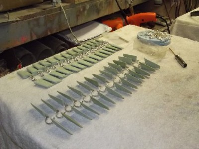

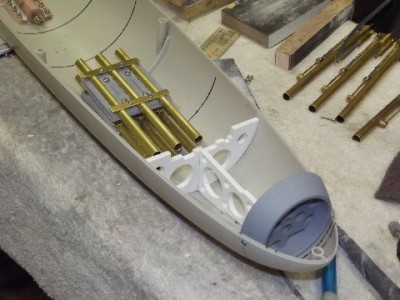

PostPosted: Sat Sep 22, 2012 6:30 pm
Posts: 271
A few more of David's work on the conversion kit. He plans to have the masters this weekend and then will start on the mast kit. Caswell will offer 2 kits for the Skipjack that David is developing that will cover both RC & static modeler markets:
Quote:
The 'R/C conversion' fittings kit will be all the items needed to convert the kit to function as a practical r/c model submarine -- included in that fittings kit will be the foundations I showed last night to mount a torpedo weapon system if the customer desires.
I will develop a separate 'detailing' kit that will include refined masts, scopes and antennas, detailed door and deck hatches, main ballast vent flanges, cleats, mooring lines, figures, and other small parts to make a more presentable display piece.
Details can be found on http://www.sub-driver.com.
