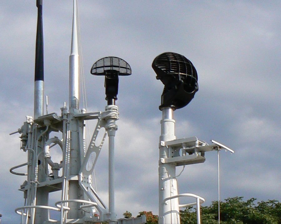

TROUNCE (AN/BPQ-2) used pulse coded signals to guide the Regulus I cruise missile, which had a range of around 400 miles and a 1 megaton nuclear warhead. Only a handful of submarines were either converted or purpose built to launch Regulus. The launching submarine had a TROUNCE antenna, as did a downrange guidance submarine. Again, a handful of non-Regulus missile launching submarines were used for downrange guidance.The AN/BPQ-2 apparently replaced the narrow beam SV-1 originally employed in tests. The SV radar was found to be difficult to track the fast Regulus because of the radar narrow beam. Note that these tests were all in the early 1950's.
The original SV-1 antenna was on an extendable mast near the rear of the conning tower fairwater deck. that originally had the omnidirectional SD radar. The SV-1 was installed on fleet submarines late in the war (primarily 1945) and had a large dish. This dish was much larger than the SJ dish. See photos of the SV-1 on Flasher and Pampanito:
File comment: SV-1 antenna (Right large dish). SJ is smaller dish antenna
File comment: SV-1 antenna (Left)

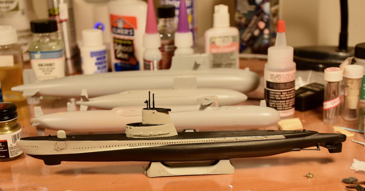

Still some final work to do on these models (like add the screws, decals, and mount them on a finished board)
File comment: EB Sail Guppy before paint
File comment: EB Guppy with paint

Is that Tullibee in the background 1/350? Scratchbuilt?
