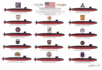

I then stumbled onto this print and I thought it may be cool to replicate it in 3-D, using models.
Before seeing this print, I had been informed that Greenling was 13’ 9” longer than Thresher or Permit and that the sail had been modified. Looking at the print, it looks to me like Jack, Flasher, Greenling and Gato were extended and Flasher, Greenling, Gato, and Haddock had larger sails. (I need to verify this).
The real print, available for $25, is 11”x17”, and if I use 1/700 scale, each ship would be 4-3/4” or 5” long and ½” wide, so the finished product would be about the same size, and when framed and covered with glass, would make a nice wall hanging.
To my knowledge, the only full hull 1/700 scale kit I am aware of is OKB Grigorov’s USS Thresher (http://www.freetimehobbies.com/OKB8700005.aspx), which is reasonably priced at $16.96, so I just ordered it. The kit, as is, will work for 9 of the 14 subs in the class. The remaining 5 will require 3 different modifications. The way I see it, I have a couple of different options.
The first is to buy 14 kits, build nine OOB and modify the others as needed. This would be fairly expensive, and at this scale, I think the required modifications for the remaining 5 would be difficult. It looks like the length was added to the front and tapering an extra ¼” onto a resin body would likely not be easy. The larger sails, I think, would have to be scratch built.
The other option is to use the model I just ordered, and the print, to scratch-build them. If I can find better plans, even better.
This is the way I’m leaning at the moment, if I do it, but there are several ways that I could do it. I’m thinking that I could use ½” diameter plastic tubing or wood, and using either a lathe, belt sander, or sanding wheel I could make the body of all of the ships. Or, I could just make a long one and short one, and use them for resin molds to make the actual models from. This would require making the tail and island separate, but again, I could make them all out of plastic or wood, or just make what I need for casting. The screw might be an issue, but if I can’t order them I may be able to use the one I will soon have as a template.
What would really be cool is if it was all out of wood with only brass screws and periscopes, etc., which I think I might be able to pull off, but I don’t know, I haven’t even seen the model yet, nor do I know if my buddy is even interested in it.
Any thoughts?
The Thresher was Portsmouth Navy Yard's first nuclear submarine design, and there were some ackward compromises made. Yes, the three later boats (SSN613, 614, 615) were 13 ft, 9 inches longer, as the original Thresher design was very tight. With the addition of more electronics and improved habitability, as well as some hull stability issues, more hull space was needed. Also, the original design had a very small sail, which limited the number of masts that were available for electronic interception and other Cold War functions. The snorkel mast is oddly placed, in front of the bridge cockpit. The original sail is short, and the sail planes were thus shallow, making depth control difficult at periscope depth. SSN 613-615 had somewhat larger sails to partially address this problem. Eventually, the Navy asked Electric Boat to revise the original SCB 188 plans to redress problems in several areas; this became the SCB188A, which was designated a separate class and took the name of the lead boat, Sturgeon (SSN 637).
Thresher (SSN 593) 278' 6" 3,750 tons (surface) 4,310 tons (submerged)
SSN 613-615 292' 3" 4,260 4,770
USS Jack 297' 4" 3,990 4,467
Jack was a one off and even longer, as she was equipped with in line contra-rotating propellers. The longer prop shaft to accomodate two propellers added to her length, as well as the gearing for the complicated "shaft within a shaft" for the contra props. That configuration didn't really give the speed increase hoped for, so it wasn't repeated.

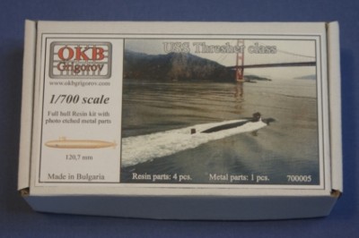

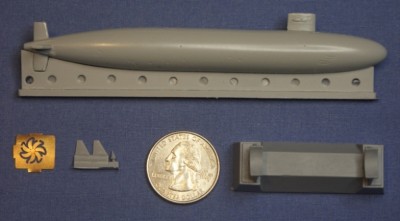

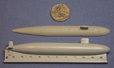

I received the OKB Grigorov 1/700 USS Thresher class kit and it is simple, but nice.
It compares favorably in size with the 1/700 JAG WL kit I bought from D-Boy (Thanks again D-Boy!) The sail is essentially the same size and the lengths are very similar.

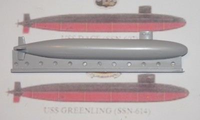

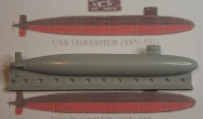

Below is a picture with the model sitting below USS Thresher on the 11”x17”print, as printed on my printer. The model is slightly bigger, but not by much, so would do nicely for recreating the print in 3D.
Below is a picture with the model sitting between USS Dace and USS Greenling on the 11”x17”print, again, as printed on my printer. The USS Dace was of the earlier design, shorter hull and sail, the USS Greenling of the later design. The differences are obvious.
After receiving you all’s feedback and now that I have seen the model, I have a little different perspective as to my options. First, I think duplicating the print with models will be more difficult than I first imagined, and since I think I have enough information to be able to scratch build USS Greenling, at whatever size I want, this may be the avenue I pursue.
Still, I like the idea of duplicating the print in 3D, and if I could pull it off, it would look really cool, so I am still giving that some more thought. Here’s what I’m thinking. Tell me what you think.

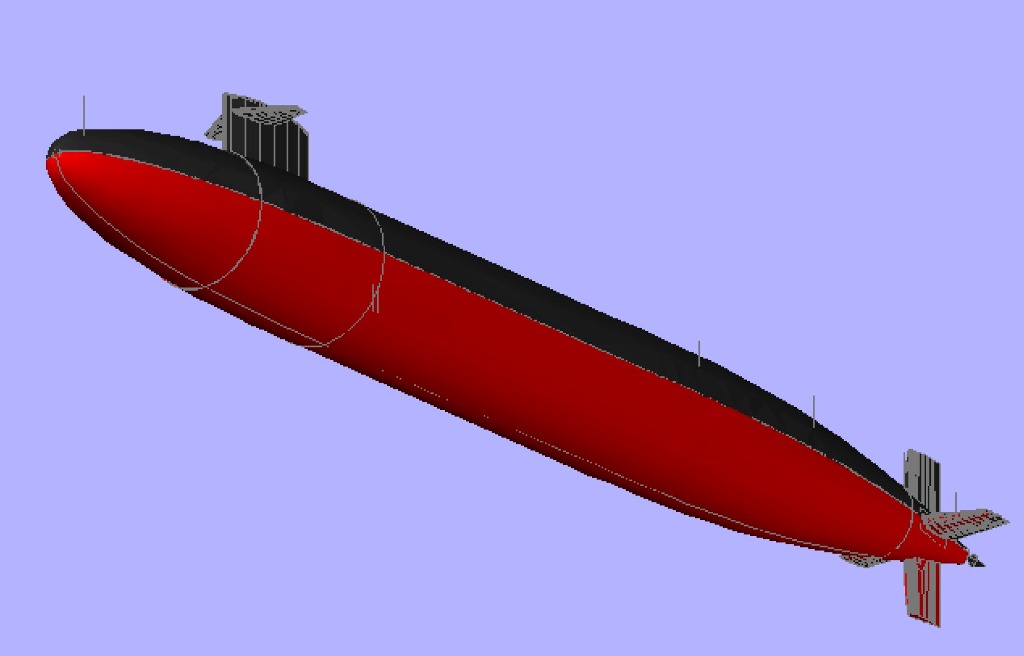

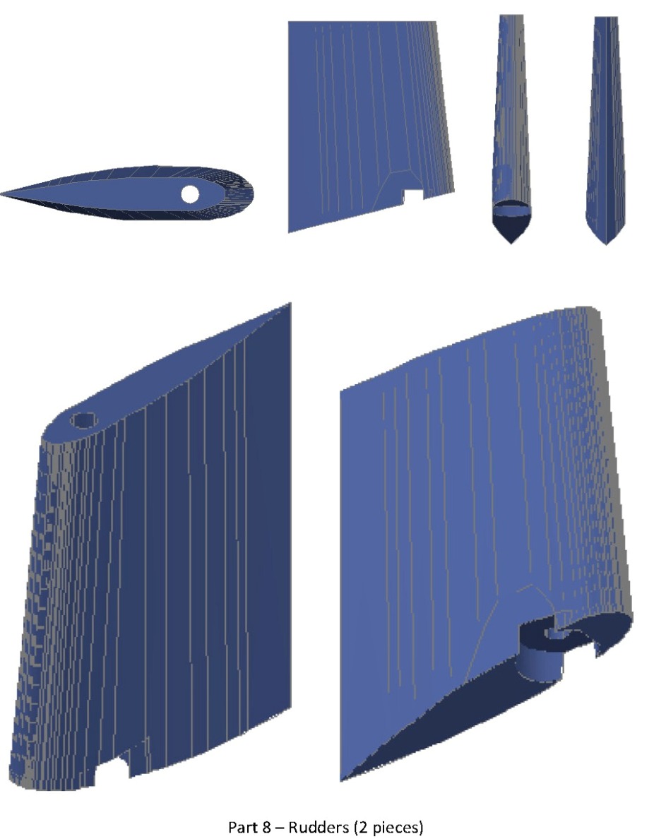

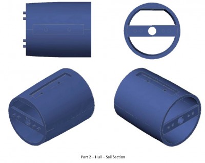

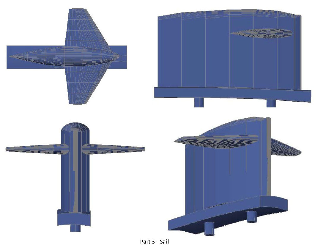

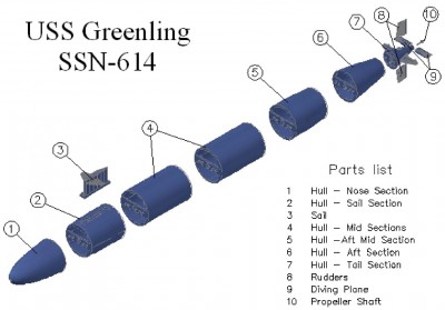

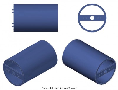

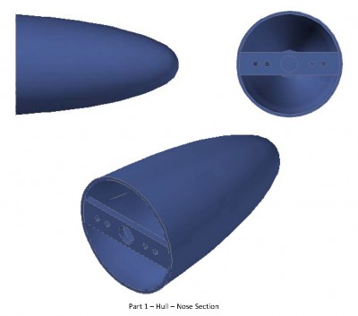

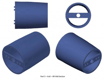

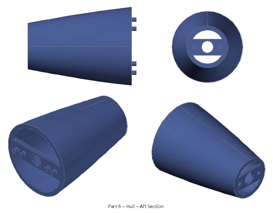

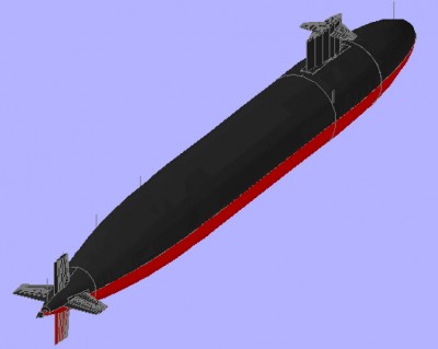

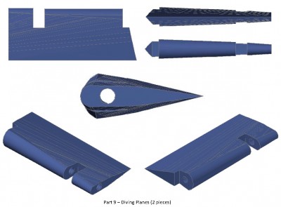

A lot has transpired over the last week with regards to my plans for building the USS Greenling for my friend. First, I obtained a decent set of plans for USS Permit. Second, between the plans, the print and photographs of Permit class subs, I was able to derive what I think are reasonable dimensions for Greenling's sail. Third, another friend of mine told me that he has access to a stereolithography (SLA) system and said that he could use it to make the small parts for me.
The SLA method uses an ultraviolet laser that solidifies a thin liquid photopolymer resin. After one layer is solidified the SLA elevator platform is lowered 0.05 mm - 0.015 mm (0.002” – 0.006”) and the process is repeated. This continues until the whole part is completed. The advantage of this is that the parts can be generated straight from 3D AutoCad drawings, which I have recently learned to do. I therefore "built" a solid model of Greenling using AutoCad Civil3D, and it was a LOT of fun. I then dissected the model to make parts no larger than 4". And it was a LOT of fun too.
I’ve started a build log on the Subcommittee forum and at the risk of doing something improper the results are shown below as well. More detail of the process I went through is provided on the Subcommittee forum at http://s181686668.onlinehome.us/phpBB3/ ... 658#p67658. Due to the 10 pic limit per post here, Part 10, the propeller shaft, is not included. I hope you enjoy the images.

And of course, after I reassembled her, I had to “paint” her! :eyebrows:
