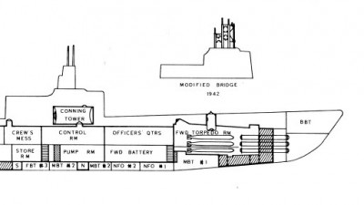

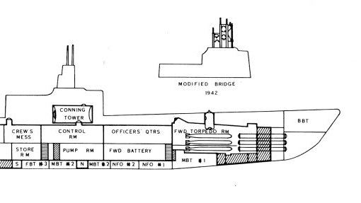

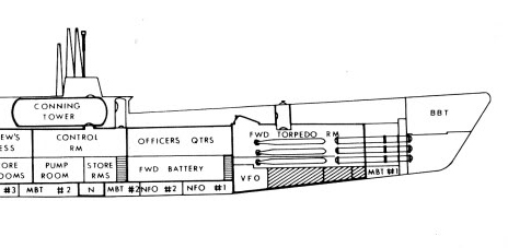

I am also not aware of any Tench class kits. The lower bow on the Tench class has a distinctly different shape than the Gato/Balao class subs.
The Tench class had a modified bow to accommodate additional torpedo loadout as well as rerouting the bow ballast tank risers so they no longer entered and exited the pressure hull.
See below diagrams.
