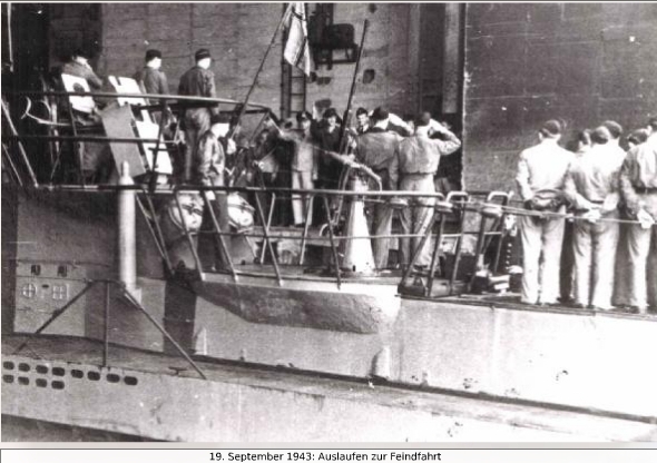

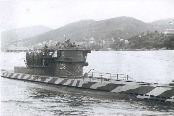

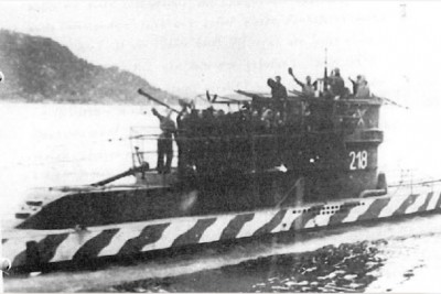

any type VII D with a wintergarten like this?
PostPosted: Thu Sep 26, 2019 11:21 am
Posts: 1778
I don't think so: reloading the mine shafts below the Wintergarten would become impossible, so the sub would loose a good deal of its purpose.
But then again, the Type X minelaying subs were used hardly as mine layers, but mostly as humble large transport submarines. It may be that one or another Type VIID has been used in a similar role, thereby overriding its original purpose. So let's have a look: Yes, there were some boats in this config! See below, three images of U218:

nice pic,trial only I guess? also were there more type VII D/F considered or they just ordered what they needed without planing that much?
PostPosted: Fri Sep 27, 2019 3:08 am
Posts: 1778
Questions, questions! I don't know the answers on those.
