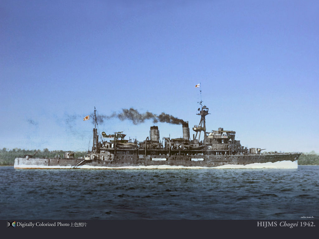

Nor are there early wartime photos of her, at least at my access. If you are willing to go with Chogei as guide in terms of fit at that time (highly likely), then yes, she would have had the director atop her bridge. Definitely too early for radar.
Colorized photo of Chogei earlly 1942:
http://www.combinedfleet.com/Jingei_t.htm
http://www.combinedfleet.com/Chogei_t.htm

Thanks Dan. Looks like another case where a certain amount of modeler's license may be needed.
I'd seen that colorized photo of Chogei but had not realized the bow wave was a Measure 5
fake; rather well done!

The photo of the Ch?gei in 1942 looks like it has a director on top of the bridge.
The same photo (posted above, colorized) shows a degaussing cable, or what looks to be one.
And there is a 1946 photo of the Jingei with a Type 21 Radar on the forward Mast.
MB

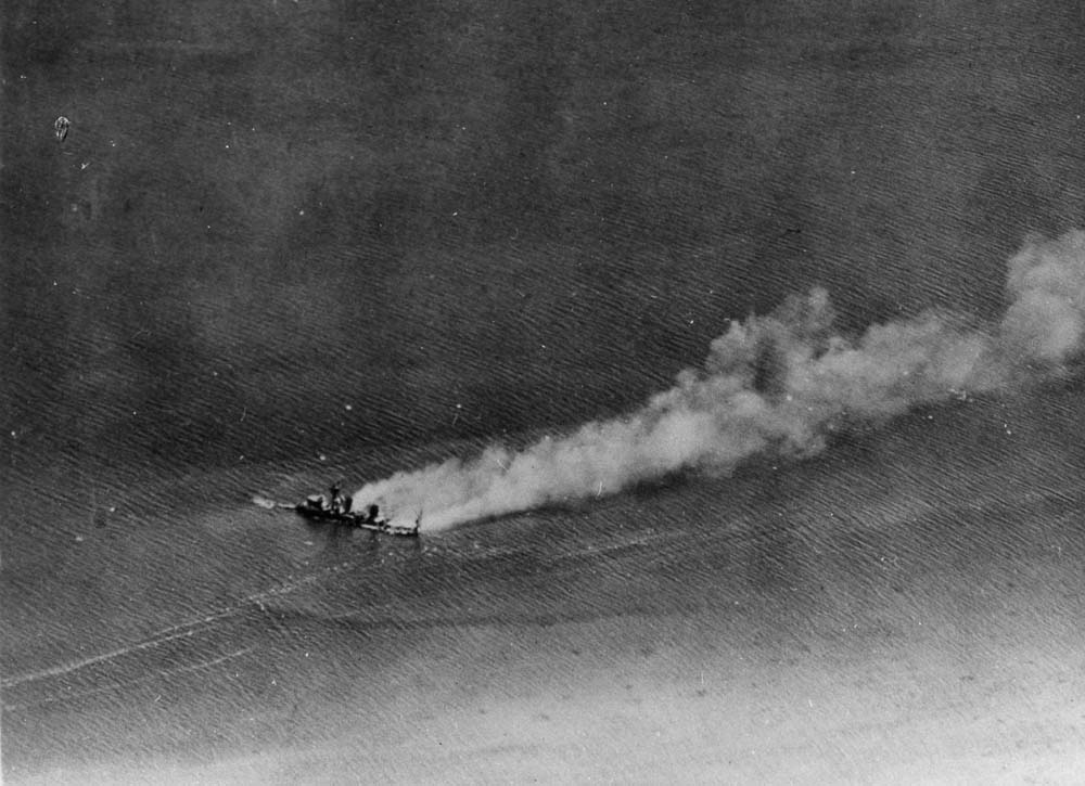

berend
- Posts: 84
- Joined: Thu Apr 04, 2013 4:26 pm
Re: Calling all IJN Jingei Fans
Jingei sunk, top view from CVE Lunga Point log 1944 - 1945.
Berend
Berend
- Posts: 9116
Great photo!
