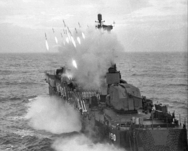

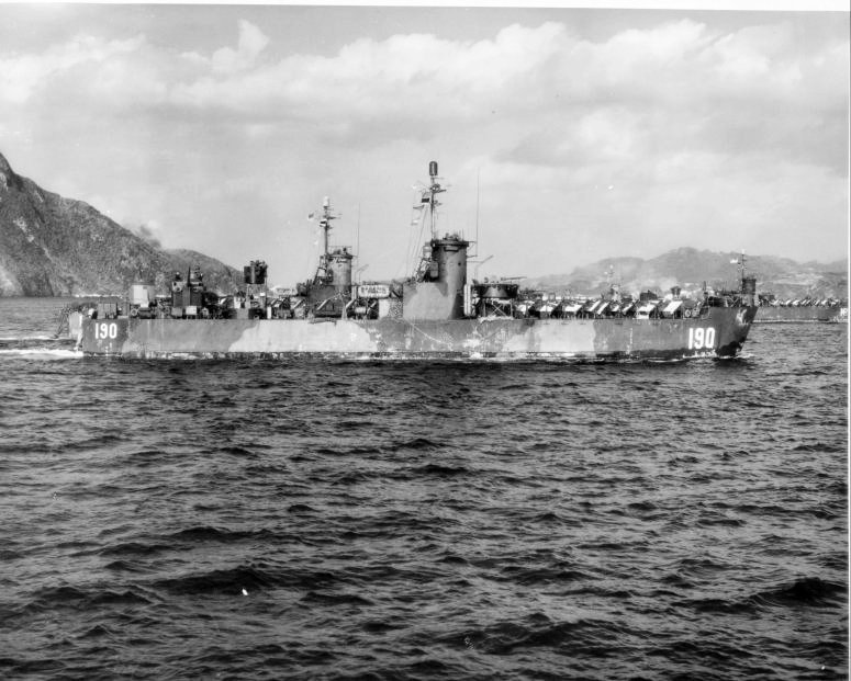

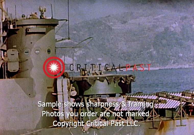

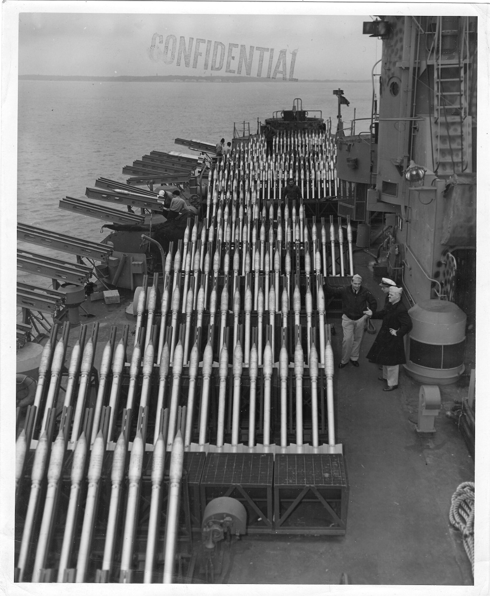

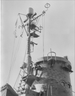

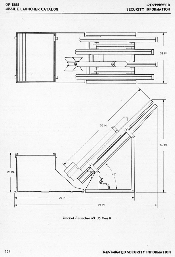

I look forward to seeing the LSM(R)-190 project. As David says, you can use my thread on the 198 as a starting point for your 190 model, but be aware that the deck on the first 6 ships, of which the 190 was one, was not raised. With the installation of the Mk 51 launchers on the 196 and subsequent ships, the deck was raised.
The 190 and her five sisterships had seventy-five Mk 36 launchers, grouped in banks, on the main deck, and thirty Mk 30 launchers on the gunwales. I believe by the time she was sunk, the Mk 30 launchers had been removed. Here is a drawing of the Mk 36 launcher:
File comment: Drawing courtesy of Historic Naval Ships Association.

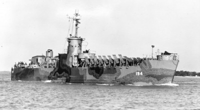

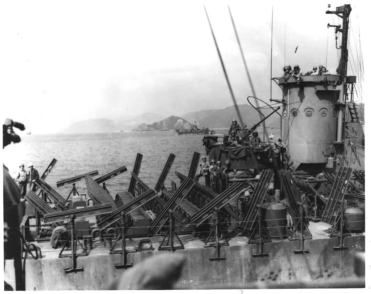

Here are some photos of the 190 and sisterships that are available from various public sources:
File comment: Still from video courtesy of CriticalPast
