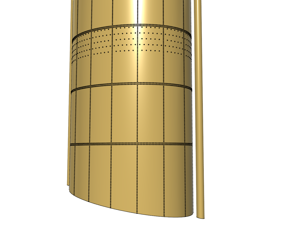

Posts: 4055
Seeking photos or authoritative drawings of the tops of funnels # 1, 2 or 3, view downwards from above, into the funnel interior, showing interior structure and funnel top grills. Have photos of funnel 4.
Any help is hugely appreciated.
This is for a project to be offered in 1/350 and 1/400 scales. Here is one of four parts of that project, the design for funnel # 2 at 50% complete.
