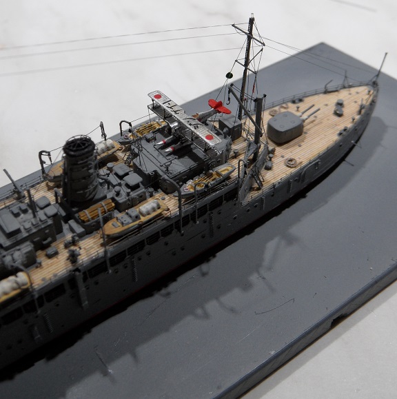

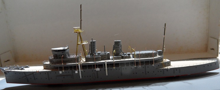

Hello,
in moment I build the Jingei/Chogei...
here ist a picture of my Jingei
PostPosted: Thu Feb 09, 2017 8:31 am
Posts: 8837
Lots of good detail work there. Nice!

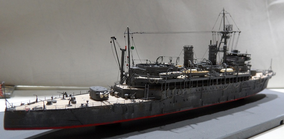

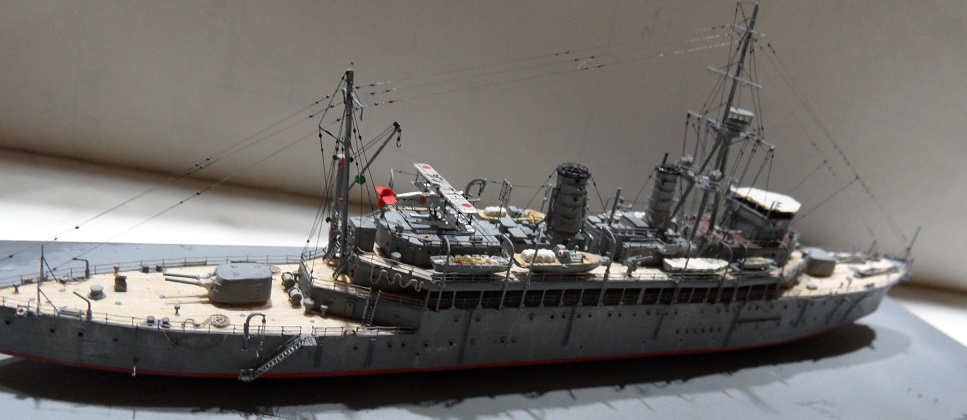

Here a lot of >improvised< pictures from my Jingei/Chogei ...it is not finish ~ 95%
