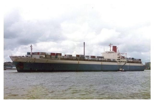

In the early third-generation cellular containerships (which were Panamax size), like Elbe Maru or Korrigan for example, the below-deck containers were stowed 10 across and 9 deep in the widest part of the hull. They were surmounted by massive hatches which once closed a secured would carry containers 12 across and 3 high.
When these third-generation ships were being design in the late 1960s/early 1970s they were quite an unknown quantity. Naval architects had to design massive 950' hulls with hatches for sustained high speed (26+ knots) operation; and as a result they were generally over-engineered and over-designed.
Later third-generation ships wer built lighter with shallower hulls and bluffer hull forms (still Panamax) for reduced operation speeds (post fuel-crisis). The below-deck containers were stowed 10 across and eight deep below decks, and thirteen across and four deep on top of the hatches.
Later generation and post-Panamax designs have generally done away with hatches so that the container guide vanes often protrude above the weatherdeck. A typical fourth-generation Panamax hull would stow containers eleven across below weatherdeack level and thirteen across above, stowed thirteen deep. Of course this means the holds are open to the elements......
Reefer containers come in two types. The CONAIR type would plug into the ship's onboard (below weatherdeck) refrigeration system. Containers with their own integral refrigerations units would draw power from the ship's electrical supply. I understand stowage of reefer containers are limited to certain parts of the ship.
File comment: M.V. Elbe Maru (vi), © unknown.
I do like Elbe Maru; I'm toying with the idea of converting my horrible old Imex 1/550 Toyama kit......

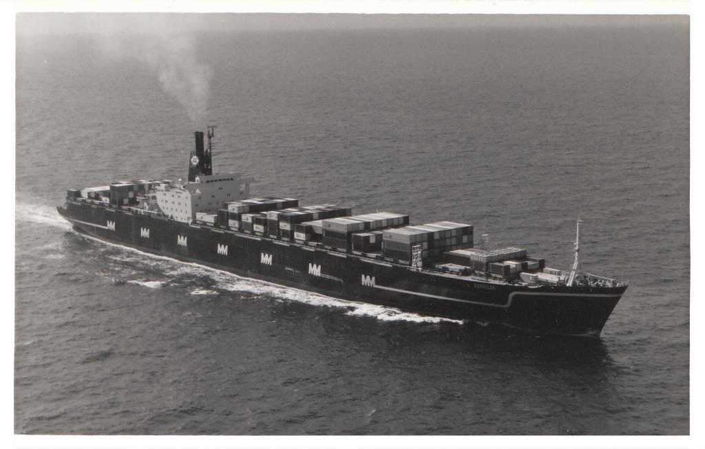

Here is a foreshortened view of my favourite, S.S. Korrigan which was Messageries Maritimes' contribution to the ScanDutch consortium......
File comment: S.S. Korrigan; © unknown, dated 8th January 1976.
S.S. KORRIGAN; the first French third generation cellular containership with capacity for up to 2,804 TEU built for Messageries Maritimes. She passed into C.G.M – Compagnie Générale Maritime ownership on 1st January 1977 and was converted into a motorship from 7th January 1981 at Mitsubishi Heavy Industries’ Yokohama yard. Sisterships - Benavon, Benalder & City of Edinburgh built for Ben Line.
Builder – Howaldtswerke-Deutsche Werft GmbH, Kiel. Yard N°. 45.
IMO 7231098
Laid Down – unknown.
Launched 28th October 1972.
Service (Messageries Maritimes then C.G.M) 23rd April 1973 to 1998. Broken up at Chittagong from 5th April 1998.
Length 288.6 metres, breadth 32.29 metres. 57,249Grt.
Terry (Caravellarella)

Interesting Markings for this ship.
