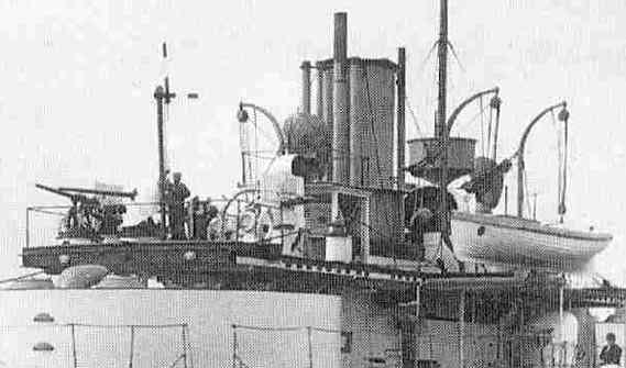

This photo appears to answer my question about the steam pipes: http://www.cerberus.com.au/fdeckbow.jpg
It seems that in addition to the pipe aft of the funnel and offset to one side (as in the paper model) there are two pipes forward of the funnel, one the same size as the aft one and the other shorter and narrower.
Another interesting detail visible in this photo is the signalling semaphore (the sailor is standing next to its base), and the searchlight platform (between the ventilator and the funnel) which seems to be missing from most plans and models of the ship, though it is shown on several photos. I believe that it is positioned above a skylight.

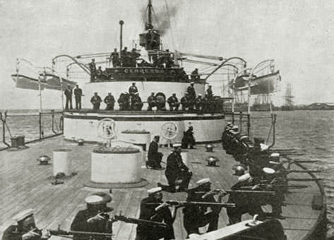

I have a question about this photo, http://www.cerberus.com.au/cerbdeckrifles.jpg - It clearly shows covers (grates?) on the forward skylights instead of the elaborate "faceted" glass covers usually seen. As most photos show the glass covers, I'm guessing that the solid ones were installed when at "action stations", to remove the danger from flying glass fragments?
As the glass covers look like they'll be a serious pain to scratchbuild, I'm definitely inclined to build the skylights with the solid covers as shown in the photo!

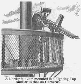

- Was the fighting top made of solid metal sheet, or open? It definitely looks solid in photos, but this could be due to a canvas spray shield? This contemporary drawing: http://www.cerberus.com.au/nord5intopcleancom.jpg shows a wire mesh structure with a wooden floor. (I think this is a generic representation of a fighting top and is not specifically meant to be the one on the Cerberus)

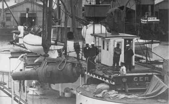

- Was the compass platform (on the aft deck) square or round? The card model has a round platform, but the only references sources I can find which show the compass platform (a contemporary engraving, and photos of the 1/48 model) both have a square platform.
- What are the three U-shaped fittings on the turret roofs? I assumed that these were vision ports, but the only photo I can find which appears to show this fitting: http://www.cerberus.com.au/cerbgunreplace2.jpg - shows a rounded object which looks more like a vent.

The fittings on the turrets are sighting hoods - one for each gun captain and one for the turret comander. I believe the sights were fitted to the forward edge of the turret, but only when at action stations. This plan shows the hoods.
They seem to have changed with the years, like so much else on the ship. There are also large round hatches? on the turret tops, as seen in the background here http://www.cerberus.com.au/awmP00952_002.jpg
