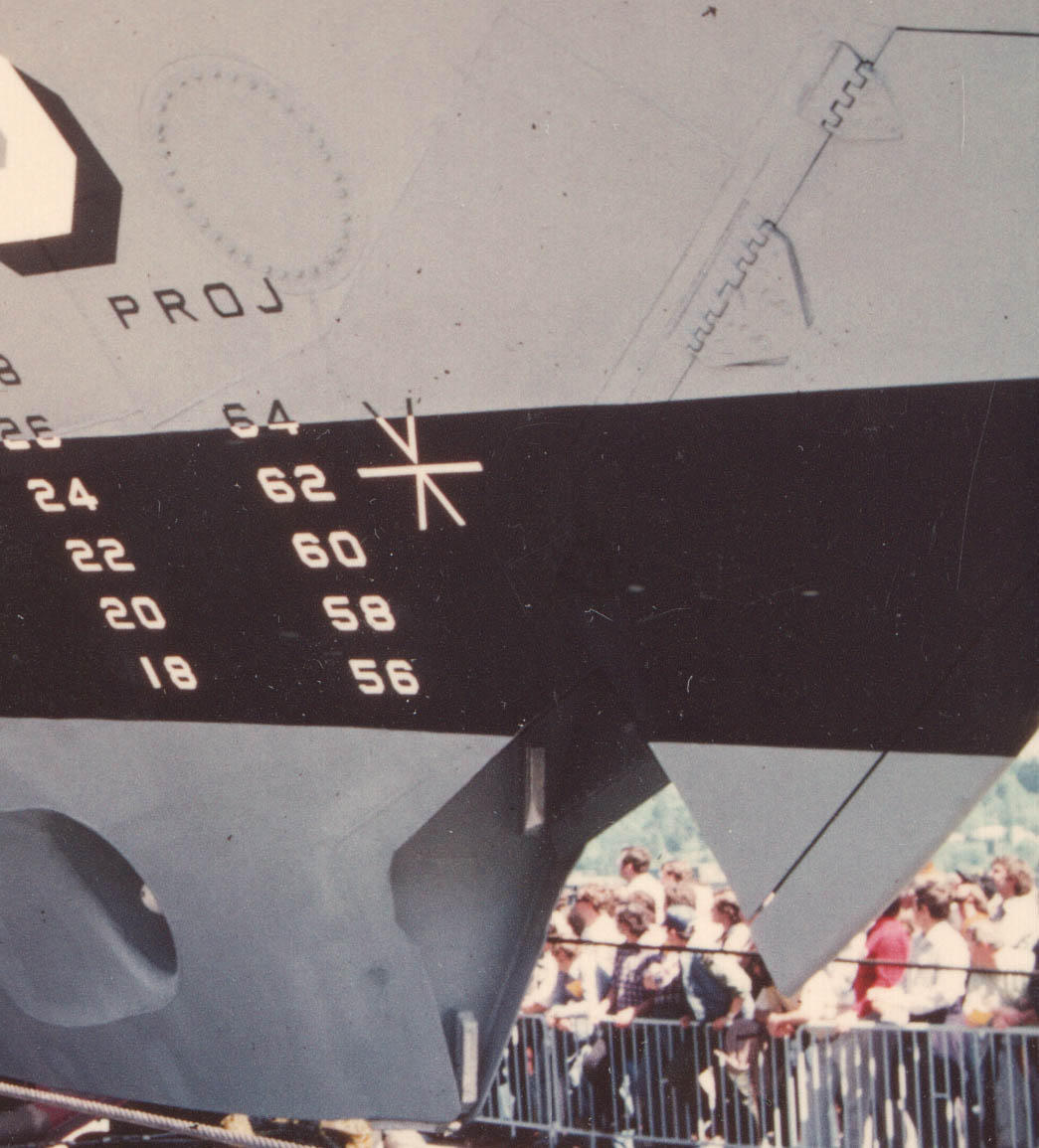

One area I can see where a little bit of work might be desired is the forward foil "well" in the bow. While the foil leg and doors are provided, there is no bulkhead structure to the interior and this may be visible when assembled (I haven't done any work to see if this is a concern yet). A photo I scanned in at the US National Archives of PHM-3's launch should help with construction for builders wishing to block this off:
File comment: Record Group 428-GX PHM-3 Launch

What about colors? Vertical surfaces Haze Gray, Horizontals deck gray. Boot in black. My question is the radar dome, is it gray or white? And the foils, natural metal with black blades? Some photos show what looks like a lighter color hull below the waterline.
I just received the Hobby Boss kit (oh, why not 1/72 scale?) and want to get started.
Dan
PostPosted: Sat Jan 27, 2018 12:52 am
Posts: 10564
Location: EG48
I haven't seen any evidence that the radar was anything other than Haze gray, but I don't have photos of every ship over the entire span of service.
Hull colors varied, but I don't know under what circumstances. I have photos of Taurus launching and it's natural aluminum below the boot topping, but later in 1989 it's clearly a light gray.
I don't know that I've ever seen black blades.
