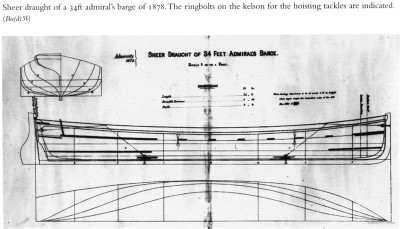

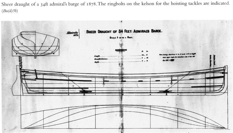

I'm at the final stages of the USS Weehawken, ready to hang the ship's boats. They hang from standard davits, as you can see in the photo below. My question is how was the rope/line that actually attached to the boat to hang it attached? Was there an eyelet in the bow and stern? Did they wrap it around a bit or chock in the boat?
Anyone have any ideas, and -- better yet -- photos?

The boat has two eyebolts for lifting - one in the bow and one the stern. The davits of that period often had a double block (two sheaves) at the top and and a double block at the bottom of each fall. The blocks provided mechanical advantage in lifting/lowering since it was done by hand. The bottom block had a hook to catch the ring on the boat. Later quick release devices were invented, but not then AFAIK. HTH

This might help - it's from May's "The Boats of Men-of-War".

Thanks guys. That helps a lot. Now I'm looking through the kit manuals on the Model Expo site to see how in the #$@#*!! you rig double blocks.
