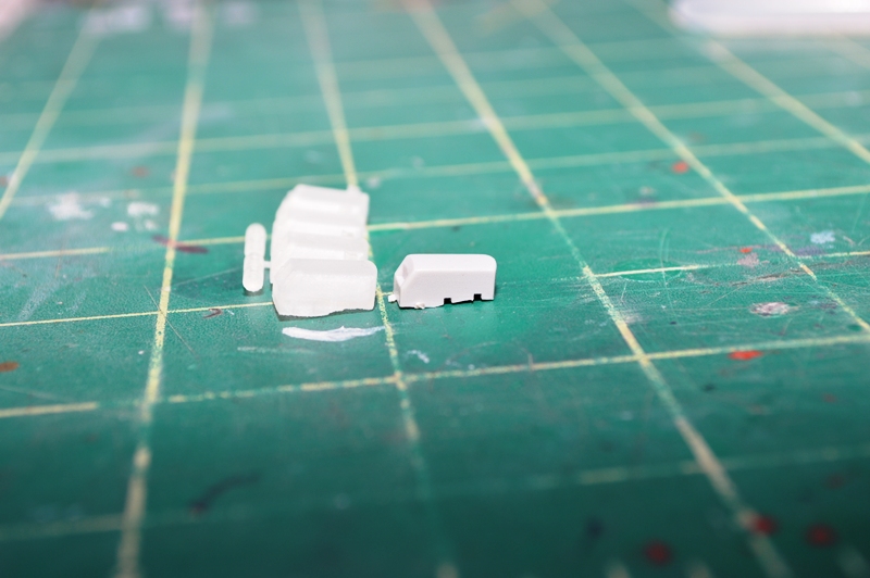

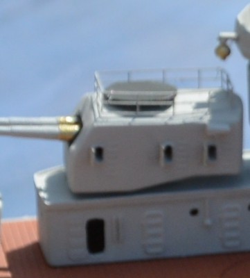

It is hard to find photos of those guns close enough to glean much detail, but there is one in the Squadron Saratoga book that gives the most info I have been able to find. On top of the #2 and #3 8in turrets there are circular platforms which mount (what appear to me to be) dual .50 cal machine guns. There is a complex looking mount, slightly primitive, with a frame for the guns, seats, and traverse and elevating mechanism.Red Devil Squadron wrote:You don't happen to know the correct AA gun set up on the top of the 8" turrets for 1936? The photos I have looked at are very confusing
Someone else may be able to be more precise about the dates (I am just going from memory) but the initial AA configuration on the turrets in the early 1930's was what I described above. Around 1936-37 they had a shield placed around the AA guns on those turrets. It remained for a period of time and then was removed because it obstructed forward visibility from the armored conn. Hopefully that was helpful.
I am including those AA mounts on my current build, but am going to represent them with canvas covers on. Considered scratching the entire mount but in many photos those covers are on, so I just went with it to save some time.
Here is the best reference I can provide from my current work. I suggest picking up the Squadron book, though. It has been invaluable.

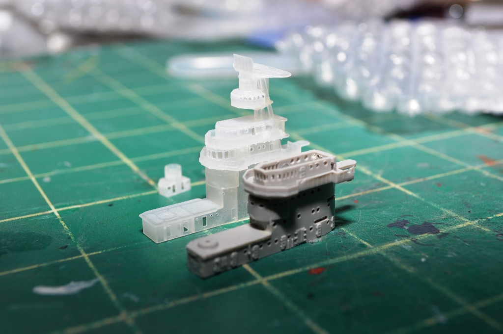

Model Monkey 1936 island and the turret set showed up today.
The island, compared to the partially assembled kit parts And the turrets: Very impressive looking.
