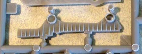

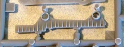

1. Step 7, platfrom part S9: there are two armored director shown. The Gakken 13 reference only shows one director (the fore-most one). What is correct for the 1941 version ? My limited references do not shed light.
2. Step 6, platform part S5: there are about 6 triple 25mm mount tubs plus two smaller tubs that I think are for directors (Gakken 13 seems to show this). The kit supplies no part for these. Are there aftermarket directors ? If so, whar manufacturer, what kit, and what part number are they ? Very difficult when everything is in Japanese.
3. The aft boat deck is missing about 4 cable reels - per Gakken 13 reference pictues of the 1/100 Zuikaku model.

1) This is what I address in the very first post here. Only one for 1941, the forward one.
2) I'll doublecheck but these do not apply to 1941. Back to you soon.
3) ditto
3) ditto

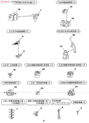

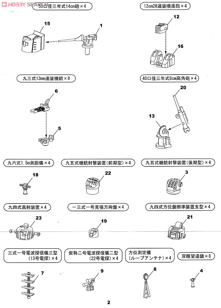

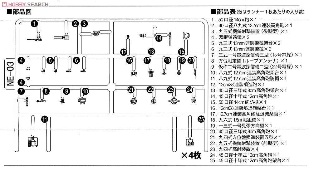

Rob, as a temporary solution (meanwhile Dan K. considering the answer) I propose you to have a look at the Pit-Road NE03 set (http://www.1999.co.jp/eng/image/10145602a/20/1, first picture). You will probably find an appropriate director/rangefinder there.Rob Weilacher wrote:...Are there aftermarket directors ? If so, whar manufacturer, what kit, and what part number are they ?

Regarding the empty tubs on part S5, these are the locations for the 25mm AA directors. Open here, they also come with covered enclosures, which is how they appear on the Tamiya kits. When open, the director looks like an optical sight/spotter on a pedastal. That configuration is available as an after market piece of PE equipment in several sets- I'd have to look them up.
I had't noticed that before; one more complication.
I'm not sure is there are any enclosed tops in plastic. The set highlighted by Ledinot contains several directors, but none of them are for 25mm.
As far as the landing light array PE goes, I believe the Zuikaku set is correct. As we discussed off line, the arrays pivot fore and aft for storage (i.e. heavy weather) so, it makes the most sense that they would be attached to the light platforms affixed to the edge of the flight deck, and not to the wall of the hangar deck. Otherwise, no enough clearance. The Shokaku sets can be cut down to size.

I have just received this NE03 set, and items #3 and #22 on it seem to be two shielded versions of Type 95 director. As far as I know, these directors were used to control light IJN AA guns, including 25mm ones, weren't they?Dan K wrote: The set highlighted by Ledinot contains several directors, but none of them are for 25mm.
- Posts: 9086
Re: Fujimi 1/700 Shokaku 1941 Addendum - reposted
Assuming this guide is correct, I think only #22 possibly applies to the 25mm mounts. #3 looks like it could be either a searchlight director or a 1.5m navigation director. Best if we could get a translation of the captioning.
