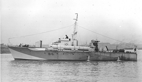

I have been trying to get a complete understanding of the different spray shield patterns and which boats had the style that I will refer to as the “rectangular” shape (as seen in the photo of MTB 97 on page 115 of Lambert’ “Allied Torpedo Boats”). I thought it might relate to sequence or sub-contractor, but I found boats with what looked to be this style scattered throughout all the series, with no apparent logic. However, I had made an error in assuming that there were only two patterns, when there are in fact three. Close examination shows that some boats with the “angular” pattern (as per the kit) were modified with extensions, resulting in a similar appearance to the “rectangular” design seen on MTB 97. Here’s an example: MTB 86. This photo is not as clear as the hi-res original but if you look closely you can still make out the joint line of the original shield and the additional fitting.
I think you are correct in that spray shield shape is the result of the arrangement of bridge stowage lockers. If so, modification to stowage would require modification to the shields.
So far, what I can state is that MTBs 80, 81, and 97 are the only boats I can definitely identify as built with the “rectangular” design. They are from the last of the 1940 programme boats built by Vosper (Portsmith). This sub-series would include 80-85 and 97-98, and I would dearly love to find photos of any of them to verify if they were all fitted this way.
I have found numerous examples of 1940/1941 boats with the “angular” pattern modified to the “rectangular” style. They include MTBs 86, 89, 205, 208, 209, 224, 238, and I am sure there are others. As yet, I have not found evidence of this modification on any of the US built or 1942 programme boats.

I'm working much the same way Mike, though my credit card has taken a hammering getting hold of some reference books too!
This image of 86 is a bit clearer than the one you posted, I can't remember its source now, I found it via Google, 86 also turns up in a picture in 'Mediterranean MTBs at War', the join line you're talking about is much more distinct in this image:
I hadn't noticed this at all until you mentioned it then the line in the picture suddenly made sense to me. It looks like the add-on panel was a different shape at the rear as well, more angular, the larger fitted spray shields as on 97 are radiused at the top corner and fitted with a moulded trim all the way round and down the vertical to the deck.
I wish I knew for sure what the taller lockers were for, as I said they look the right size for rifle-racks and given that these boats were constantly being fitted with heavier weapons as time went on I can believe thats what they are, rifles for the crew for close-in fighting.
I've found two images of 82, the better one is in 'Mediterranean MTBs at War', on page 57, although the picture is quite grainy and with too much contrast for fine details you can make out the curved spray shield as per the kit, the second pic is below and again came from a Google search, its also very poor but there is just enough detail to make out the curve of the kit-style spray shield if you look closely:
N.B: The pic of 82 in 'Mediterranean MTBs at War' also shows the she was fitted with a Breda 20/65 on the foredeck at some point. I think one of John Lamberts plans mentions that 86 was eventually fitted with a single 20mm Oerlikon.
This is conjecture on my part but it is possible that the 'add-on' shield you're seeing is a result of a kit issued for local (field) modification, whereas the more integrated and better finished style as on MTB 97 is the factory-fit?
