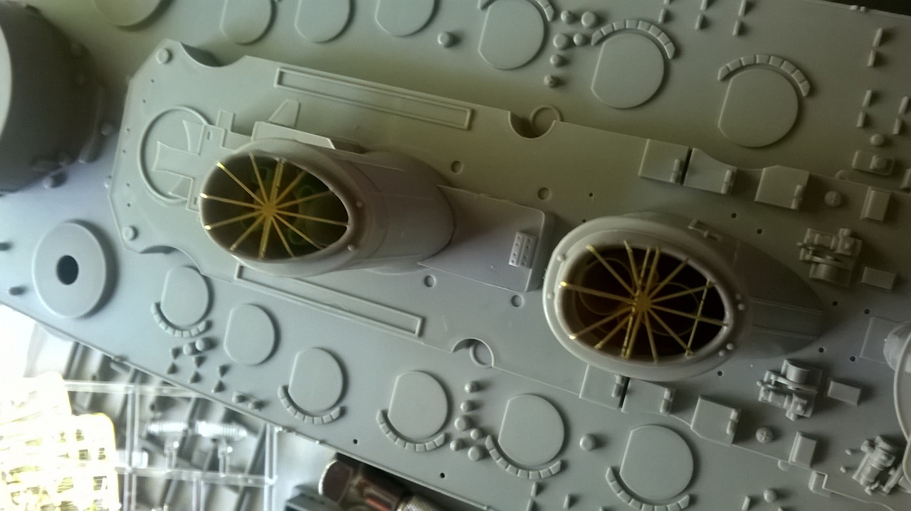

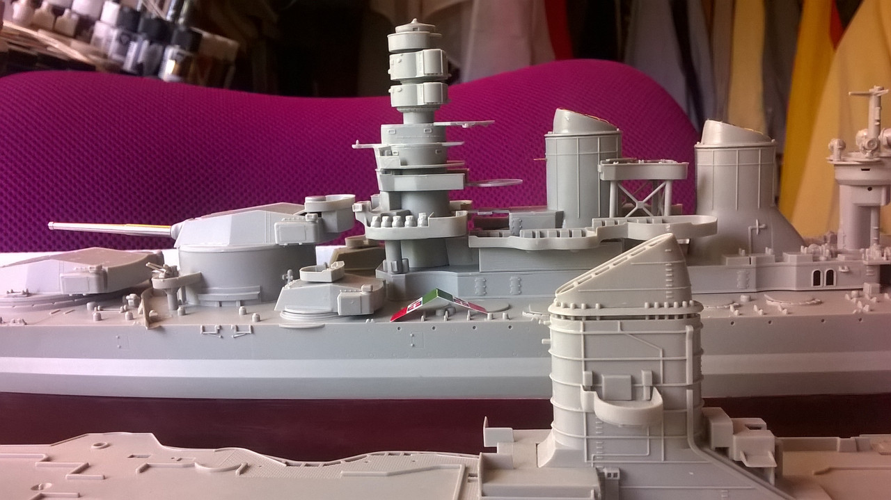

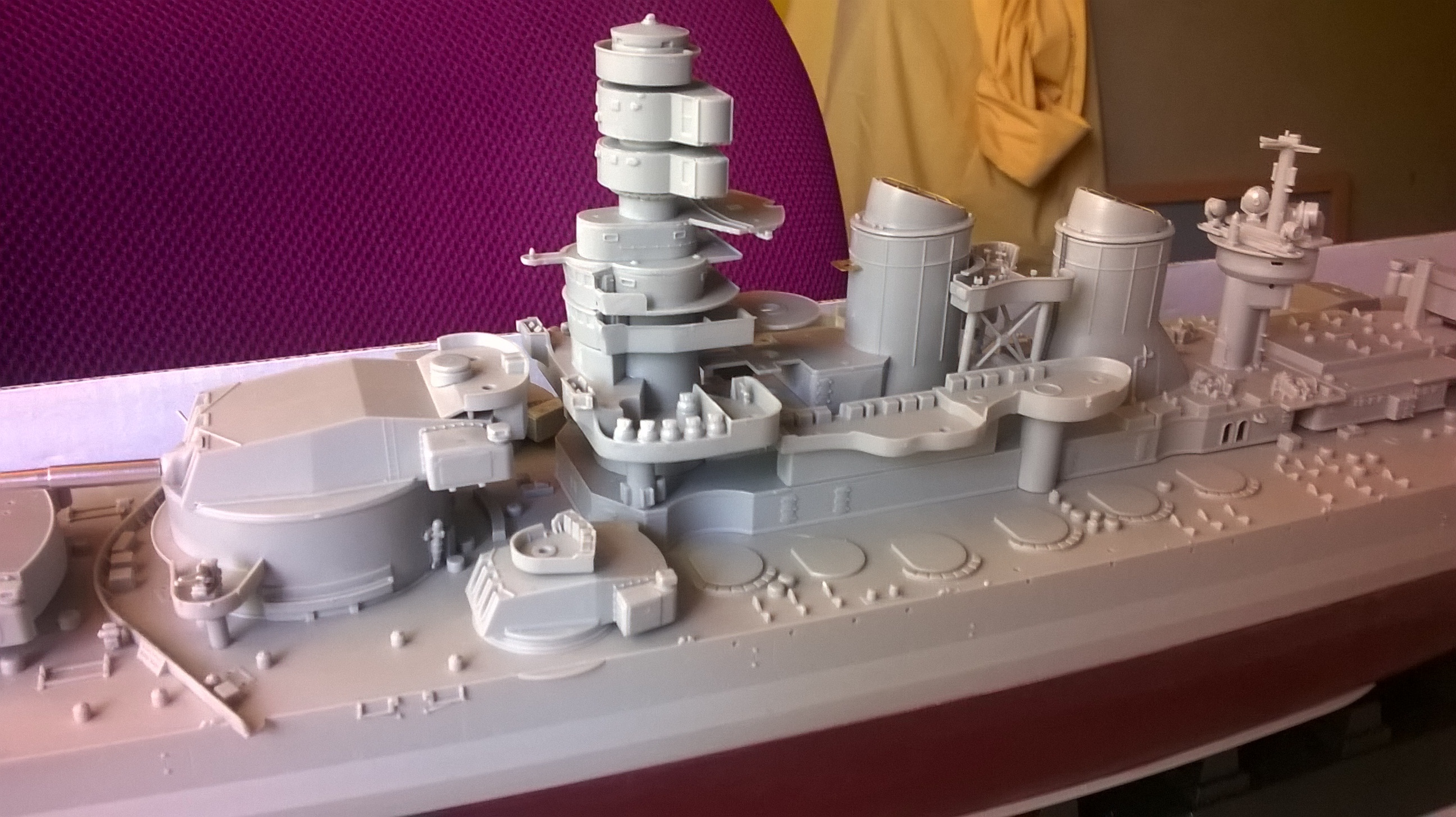

I tend to complete my models in subsections, often with rigging, before I apply paint so as to be even in my applications of color or pigment.
The interior of the funnels were completely devoid of detail. Lacking an adequate down funnel shot I made something up with straw sections and plastic tubing.
A superior image.
Dry fit.
Another view.
With the funnel of my long overdue Prinz Eugen. Inspiration died hard on that one.

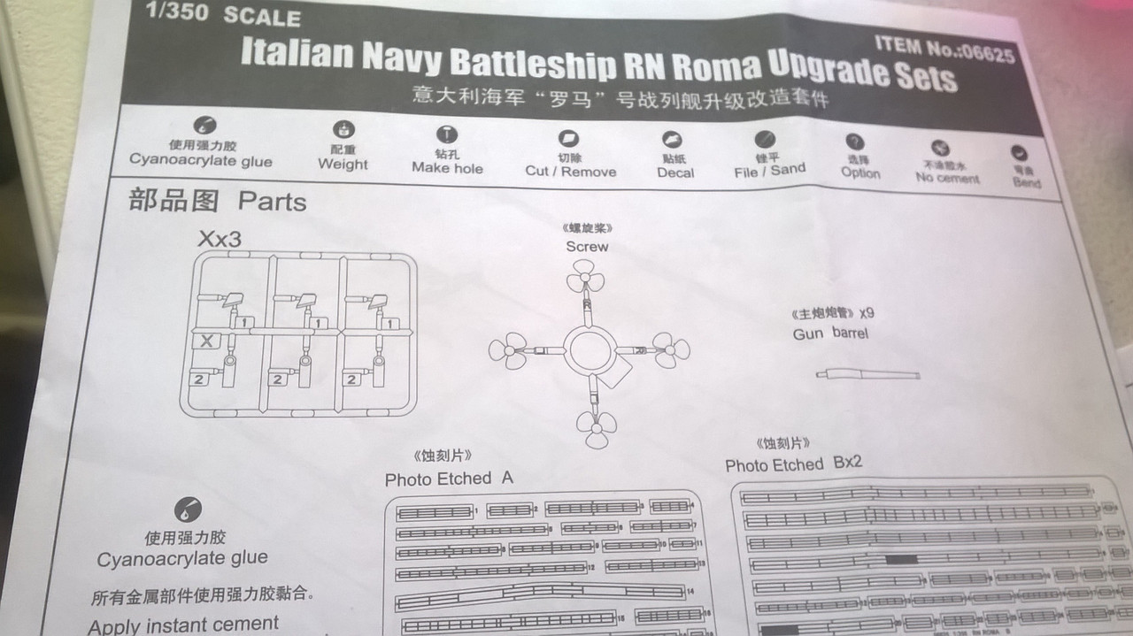

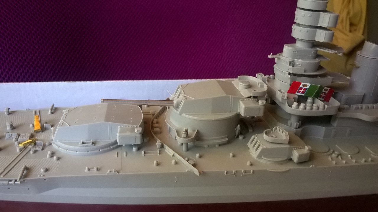

The Roma was also one of the first ships kits I know of to get a dedicated detail up set from Trumpeter. Highly recommended. I enjoyed it very much.
And here is the instruction sheet for it. Turned aluminium barrels, semi brass screws, and ship specific railing sections. The kit 381mm rifles have a nasty seam, almost justifies the purchase alone.

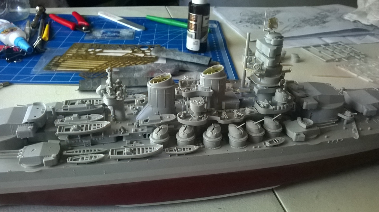

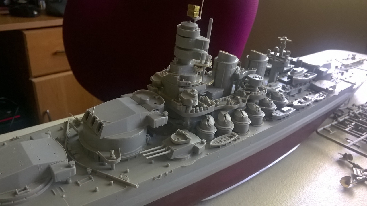

Starting to look like a proper battleship!
An imposing skyline for sure.
The crane PE is actually native to the kit. Went together fairly easily. This thickness of the brass was pretty much ideal in my view, much better than other Trumpeter PE I have worked with.

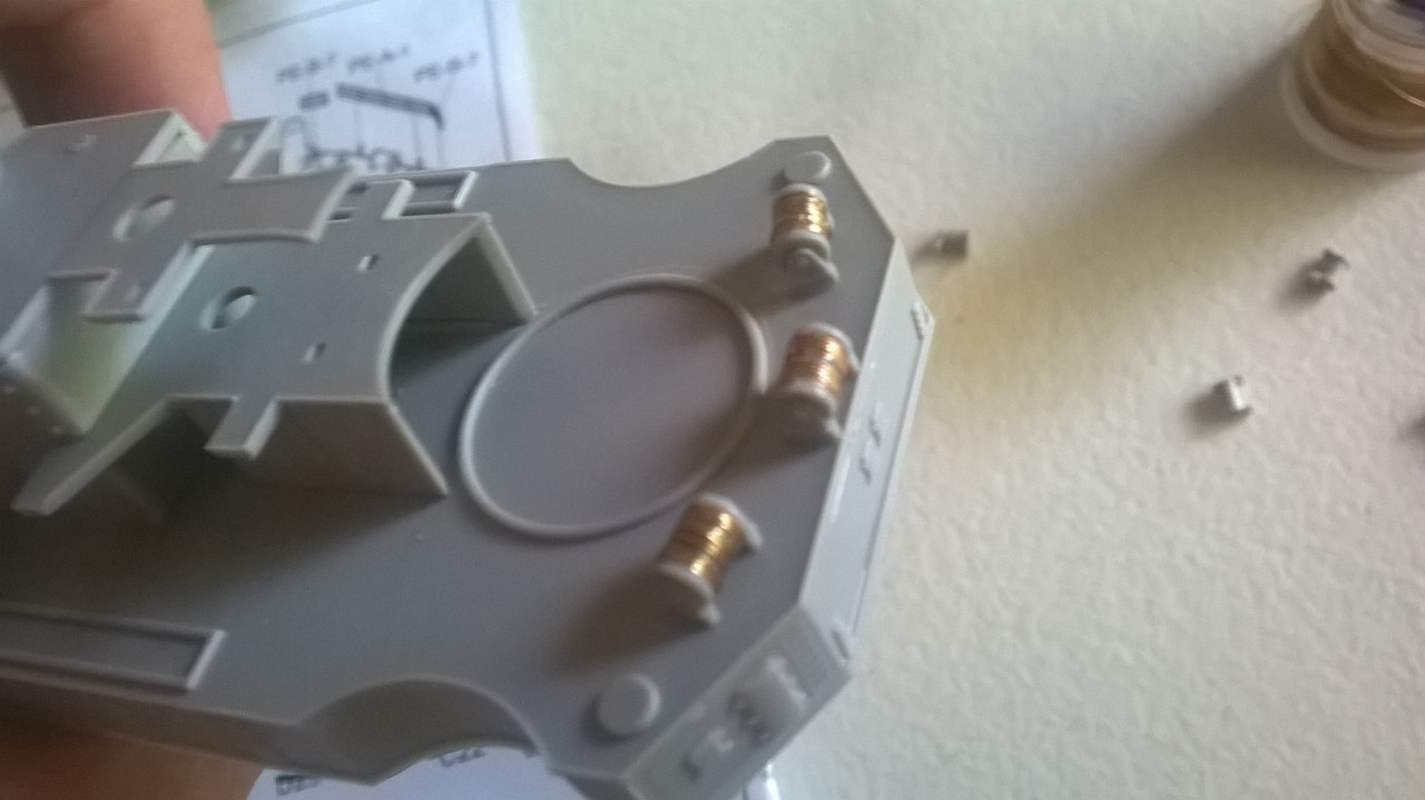

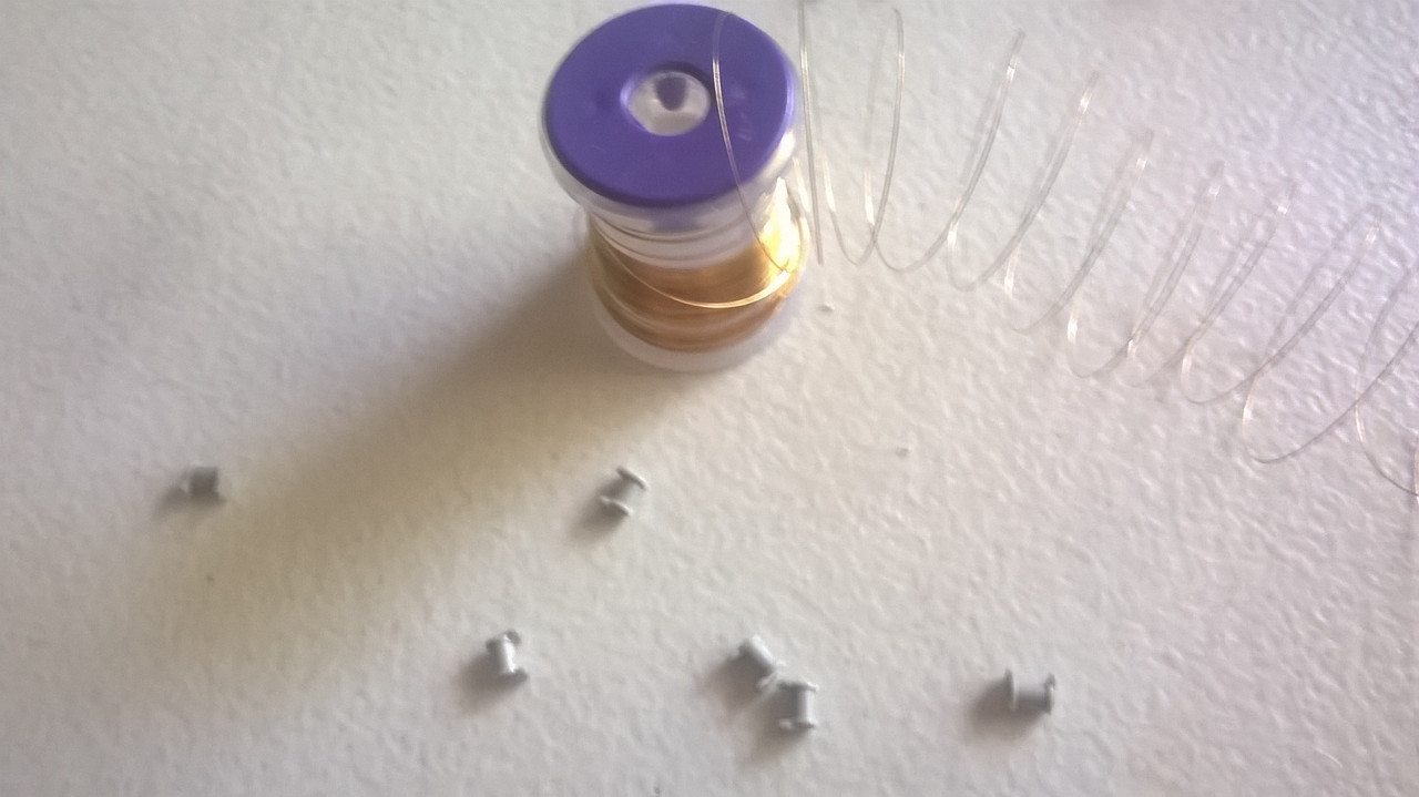

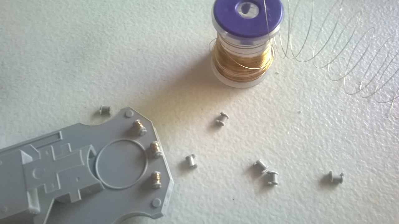

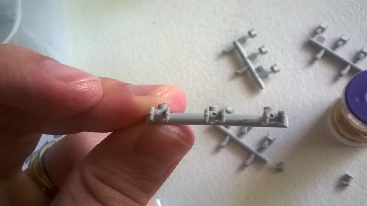

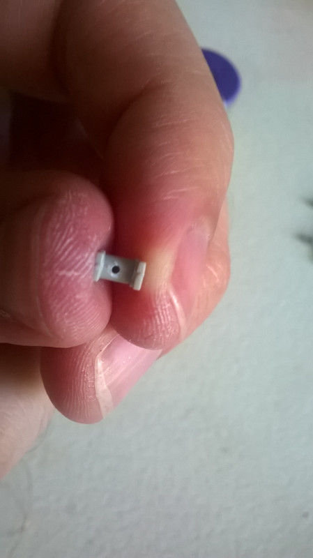

One particular set of components I found frustration were the deck spools. This objects are used for coiling hose or steel cable. They are unusable OOB. Without reverting to another PE set, I elected to wrap them in brass wire.
First, I drilled a hole in an inconspicuous place.
Then, with the brass line, proceeded to twist around the spool rods.
The first finished set. There were 21 in total in two sizes, if I recall correctly.
A less than ideal image, but it does lend a sense of scale.
The smaller spools I drilled on the sprue. These items are appreciably smaller than the larger ones.

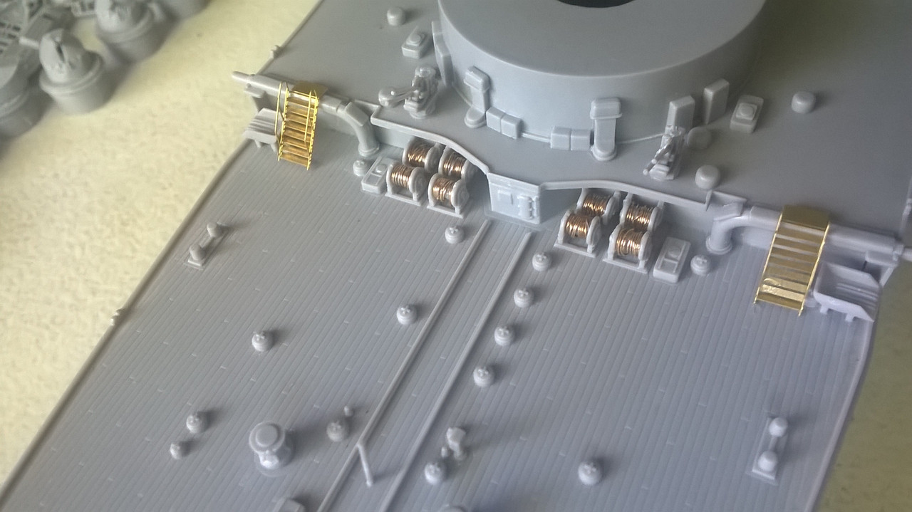

The bear itself. Eight spools aft. Part of the equipment on the aircraft handling deck. From reference images, it appears that these lines were often used to help move aircraft although not exclusively.

And here is my compromise.
Mostly complete masking. Using thin Testor's tape (horrid adhesion) and the standard Tamiya.
Base coats applied. Some very minor tidying up to do.
