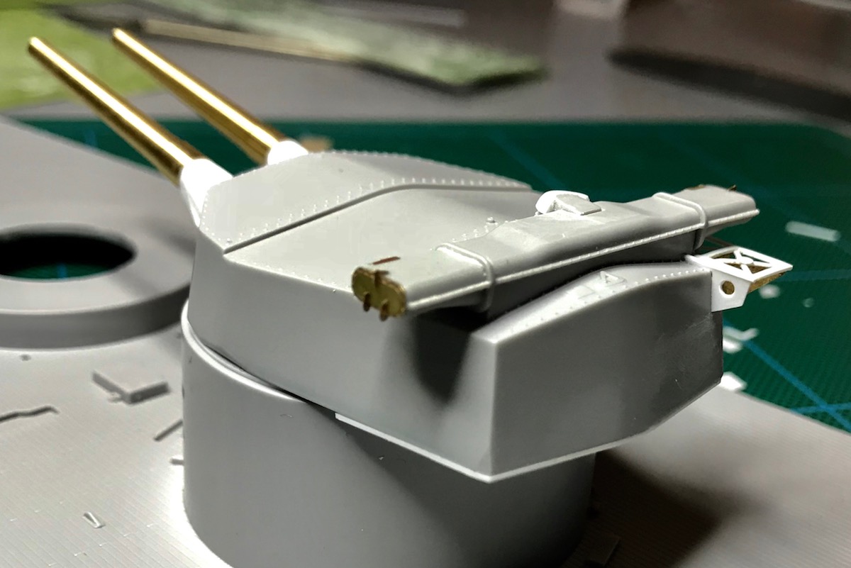

So I started with the 'easy' bits. The main armament. Not that they are that easy as it happens. Again I have a fallback in that the Shapeways/Model Monkey turrets look pretty good... but at �130 for the ultra detail versions, its worth messing around with what I can do with the kit parts and some plastic card first. If I mess up, I'll buy them... If they are really nice, I may just buy them anyway (hoping they will be at Telford). But whether I buy them or not, actually cutting plastic and trying some scratch building to enhance what I have was a safe and interesting place to start...

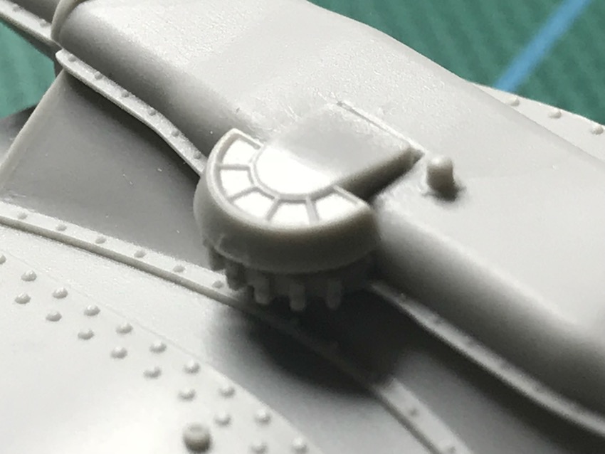

The next thing I wanted to change was the commanders position... This is very much thanks to EJ on his wonderful 'On the Slipway' site.
The commanders position viewport is molded as a single piece and the only way to show any depth or 'hollowness' to the windscreen is to fill it in and hope that painting it gives some sense of depth. At 200 scale though, I'm not sure how effective this is... and besides, EJ worked in 350 scale. Surely I could do something similar to him at nearly twice the size?!
It wasn't as easy as I first thought... but it certainly gave me even more pause for thought in appreciation of EJ Foeths' modelling skills (I am sure to come to that awareness many, many times over the next couple of years or so...!)
Anyway, in pictures, this is how I did it...
I used the original kit part and filed off the 'screen' part, just leaving the centre part... and then glued on strip vertically.
I then filed the outer edge of the 'screen' at 45 degrees to give the impression of a shield (I had tried several times to get a curved piece of strip so the inner surface was also at 45 degrees, but after several attempts, it was obvious it really wasn't practical nor worthwhile. I am beginning to learn that sometimes things are not worth doing, even if you know you want to!).
The result looks pretty good actually. Here is the original kit part...
Here is my modified part...
I am actually pretty pleased with it... here are the two side by side at a normal viewing distance...

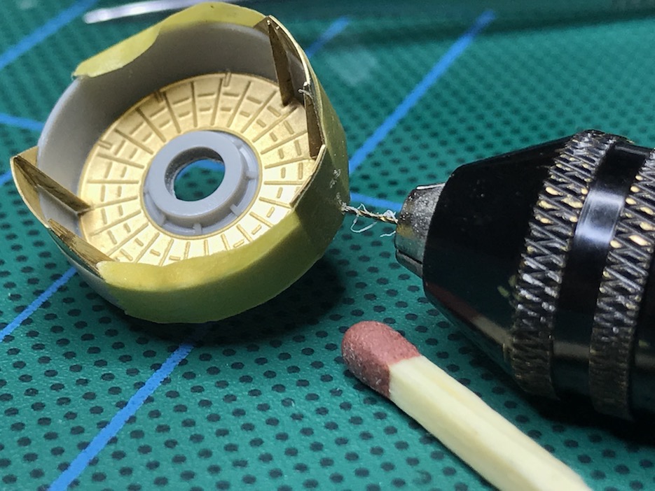

Ive been pretty busy lately and haven't had time to work on Hood all that much... but put in a full evening today :thumbs_up_1:
Believe it or not, this is a whole evenings worth. Maybe I'm just slow and out of practice...
At this rate I think this is going to be a while :big_grin:

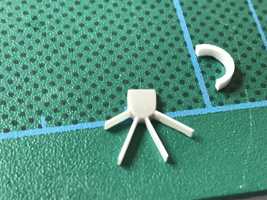

Here is a step by step of the UP Platform on B Turret...
I have managed to almost finish the main turrets... probably another two evenings and then priming. Then a long wait until all the other sub assemblies are done.
This is going to be a while...!

This shows the rotation arc... it looks like it would clear easily... but it doesnt...!
And finally, my scratch built version of the same thing... which I have now removed from the turret and taken apart...
And here it is with the turret mounted on the barbette... it is so wrong on so many areas I had to take it apart... the shape of that rear support for example is completely wrong. However, this was really just to see what the platform itself looked like and whether I could get away with it. The rear support shapes could easily be changed had I thought it was a good enough starting point.
But this kit is going to take ages... I want to reduce the number of poor decisions about the build I will come to regret... there will always be some, but I'm just starting, so I had better keep some discipline! :big_grin:
Anyway... if anyone would like to comment on the second picture and their thoughts on a folded (or removed) rear platform section, I would be delighted to hear what you have to say.
