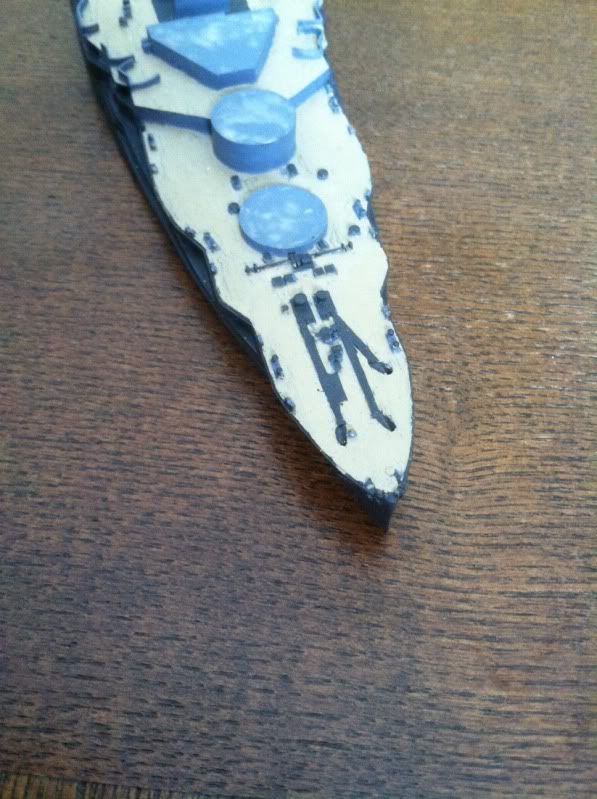

Here is a photo of how much I have taken off of the decks so far and the initial roughed in painting of the hull to get a feel for the look. I'll try to analyze the splinter shields and gun tubs tomorrow. For now, hope you enjoy looking at this stuff.

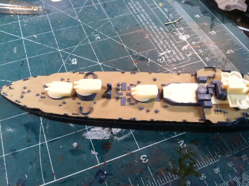

To answer Devin's question about the removal of the shields. It was a fairly painless process. This kit has all new tooling and the tubs were very thin to begin with and came off quite easily. I had to fill and scribe just a few spots.

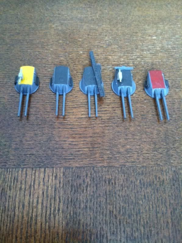

So I went digging for pictures of the anchor plates. I knew that Classic Warhips Pictorial 34 USN Battleships in Color had this photo http://www.ww2incolor.com/us-navy/usstexas2.html[url][/url] in this wonderful book. So I grabbed the book off my shelf for a quick look at this photo. At first glance it IS the same photo of Texas' bow, and it is identified as Texas in the book, but I soon realized that I was not looking at Texas. The photo Steve actually has is the one and only known photograph of USS New York wearing MS-2 camouflage during the summer of 1941. She has a 5-D hull and 5-O turrets. This is a very cool photo that also shows the top of the #1 turret painted in 5-D. Now we have photographic proof that neither Texas nor New York had their #1 turrets painted yellow (BatDiv 5) while wearing MS-2 camo in 1941. Were their #2 turrets painted yellow? I still cannot find any hard evidence that Bat Div 5 painted any of their turrets per orders but this model is going to have a yellow turret. So after completing the anchor plates and drilling out the Hawse pipes

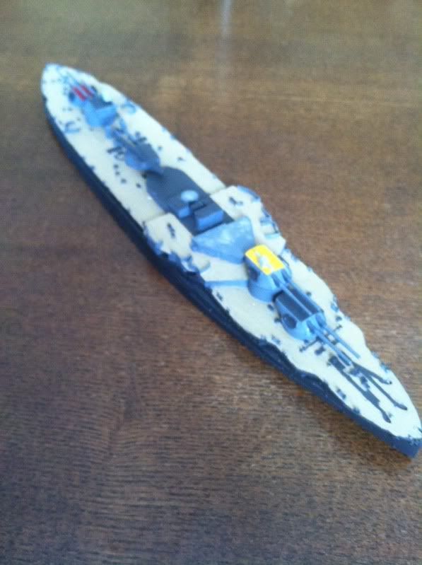

I started working on the turrets.
Not only will the #2 turret have yellow on the top, the #5 turret will have red on top to signify the 1st ship of BatDiv5.
It makes for a very colorful ship.

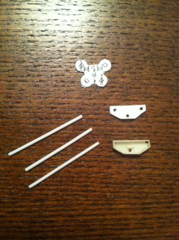

I am putting the discarded piece from the kit to good use. It will now be my projector room. Since it is hollow it will allow better play to align the mast legs to the proper angle. Then I created a roof for the projector room out of styrene. Now I am in the process of fabricating a new search light platform. I copied the plan from the Texas website listed above and reduced it to the proper size. Now I need to transfer the image to a sheet of styrene and cut it out.

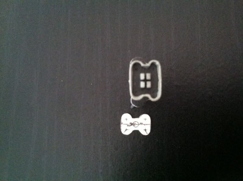

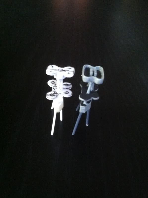

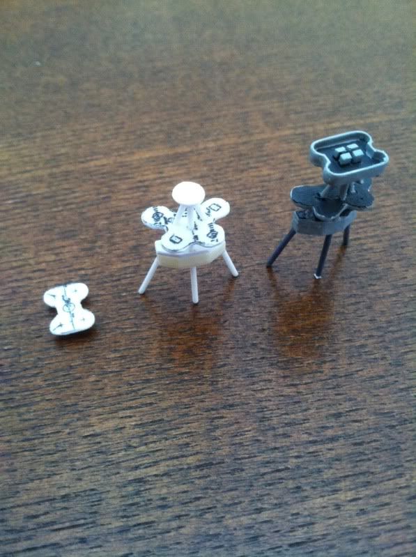

Did some more work on the mainmast. Got the searchlight platform in place and fabricated the new birdbath. Notice the huge differences in the shapes between the kit's searchlight and birdbath platforms to the ones I fabricated from the plans. I'm now waiting on photo etched splinter shields to arrive for my birdbath. I may have to fudge the detailed support lattices under each platform a bit. It would be way to small in this scale for me to get exact.
