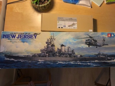

Greeting!
Since the Oregon is in storage, I decided to at least start on my next project, the USS Iowa.
So why the USS Iowa? As a kid, I always wanted to visit an Iowa Class battleship, and in 2015 I visited the USS Iowa with my then girlfriend (now wife), and had a blast exploring and learning more about the Iowa. So I made a goal of building all 4 Iowa Class battleships starting with the New Jersey (probably need to do a redo on that). I always thought the Iowa didn't get as much love as her 3 sister ships (might be due to the events of April 19, 1989). Since that visit in 2015, I have donated some money to the Pacific Battleship Center.
I'm using the New Jersey kit from Tamiya and enhancing it with the Pontos PE set. It's the first time using Pontos and I can already see how people say the instructions are a little challenging. I haven't decided if I want this to be from 1984 or 1987 when the radome was added. The Pontos set comes with the option for adding the radome platform.
I know a lot of people like the WWII looks of the ship, but for me personally, I liked the 1980's look of the Iowa Class.
The best part of this hobby is when you finished one, you try to learn from your past mistakes and improve the next time by watching how other people did their builds. Hank (BB62vet) has given me some great advice on how to approach building the Iowa, so thanks Hank!
Currently this build is only assembling some pieces, adding PE to the model. Right now since most of my modeling stuff is in storage, I won't be able to paint or add the wood decking. I'll take it as far as I can. Once the Oregon is complete, I'll finish the Iowa.

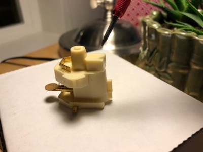

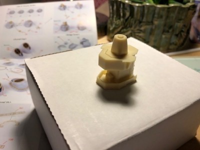

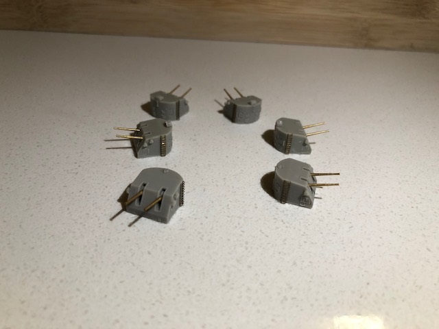

For 2 weeks, I worked on the 5in gun mounts. Yes it took that long since I only have roughly an hour each night working on the Iowa. As some of you know, family duties come first!
When I worked on my Missouri project, having to drill small holes to mount the brass barrels was very challenging. Fortunately, Pontos has pre-drilled mounts so the brass barrels can be glued in with no issues. Made the job go much faster.
The Pontos kit came with it's own 5in mounts. it's a lot more detailed then the ones that came with the Tamiya set. The ladders were added, and I actually took the time to move the rungs out, but had one rung broke. Luckily, I was able to glue it back on... :smallsmile:

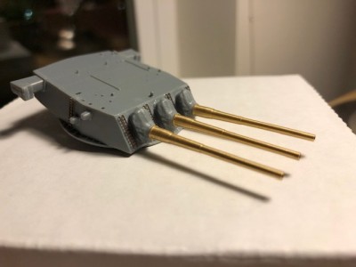

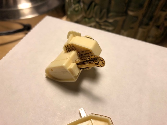

Last week I started work on the 16 inch turrets. Just like the Missouri build, adding the metal barrels was hard. I wasn't able to get a consistent angles and my drilling was all whacky. On my dry fittings, I had barrels that were angled low, and high and all over the map! It will be interesting to see once I glue the barrels to the turrets and compare it to my Missouri build, if the barrel angle for the Iowa will be higher.
I think the next Iowa class ship I work on, I won't saw off all the way to the blast bags and just leave enough so at least I have a guide so I can drill at the default angle molded by Tamiya. :huh:
I scrapped off the molded ladders, I'll need to do a little sanding so some of the scratch marks and minor gouges are less noticeable. The goal for this week (or whenever) is to attach the PE ladders to the turrets and glue in the pieces for each turrets. I won't be adding the railings on the top since I'll need to paint the top of the turrets a different color. Those railings will have to be added later.

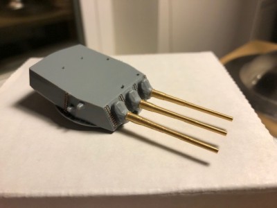

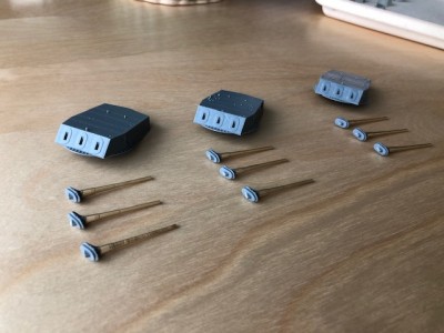

The last week I've been working on the turrets. I've adjusted the barrels to the turrets and they don't look too bad. Evenly spaced out and all at or close to the same angle. Well, maybe turret 2 was a little troublesome, but good enough!
I added the ladders to the turrets. I can already tell the difference in quality between using Eduard PE and Pontos. Now I wished I used Pontos on Missouri build! I really took the time to fold the ladders the right way and tried not to put a huge dab of CA to glue down the ladders. I think they turned out good, and I'm getting better with the PE stuff. :thumbs_up_1:
Next up, I think I might work on the bridge portion of the Iowa. I did noticed when I did a dry fit of entire ship, the mid section of the model is bowed a little. I'm hoping gluing it down and the secure it with the rubber band will help keep it down, but I'll have to deal with that later on.
