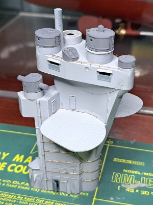

The funnel superstructure is finally finished. Next, it's time for the rear tower superstructure. I saved the pagoda for last.

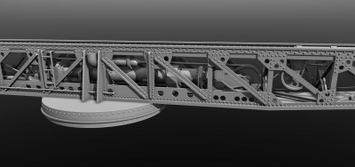

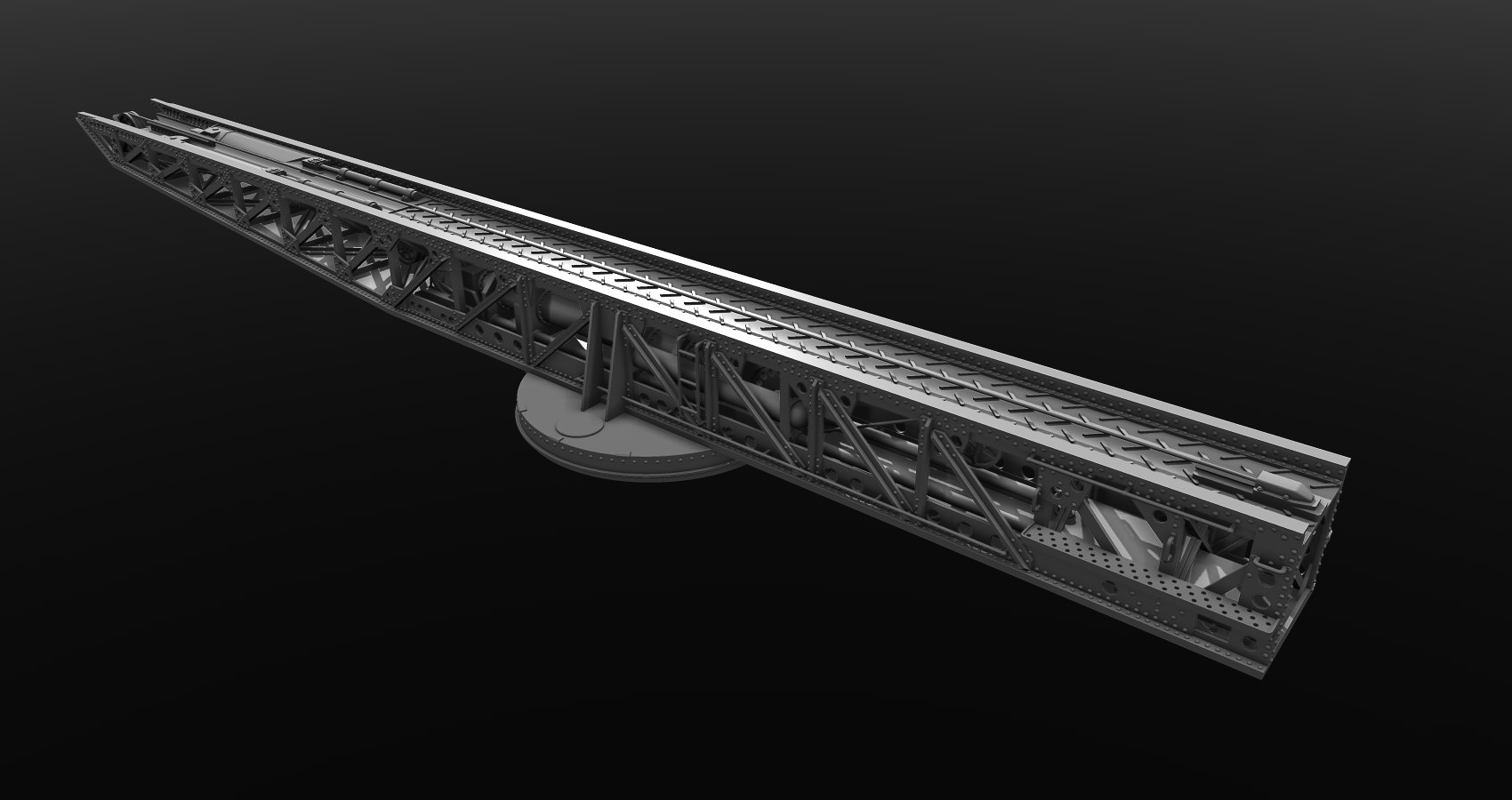

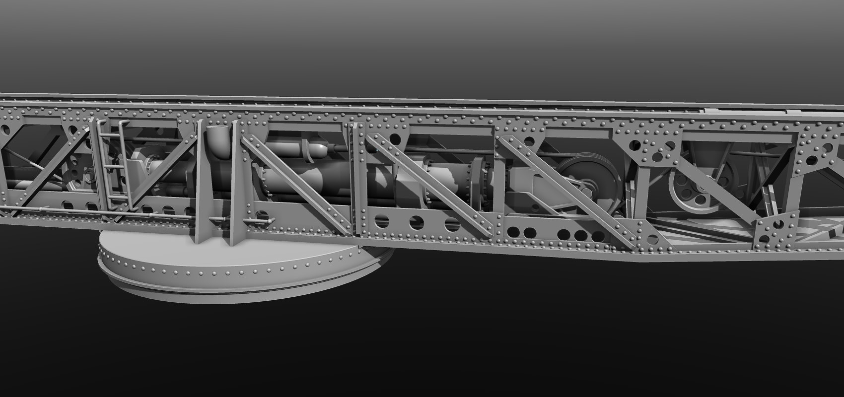

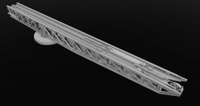

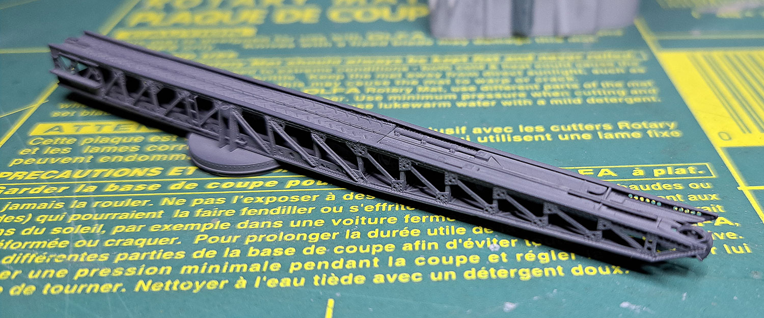

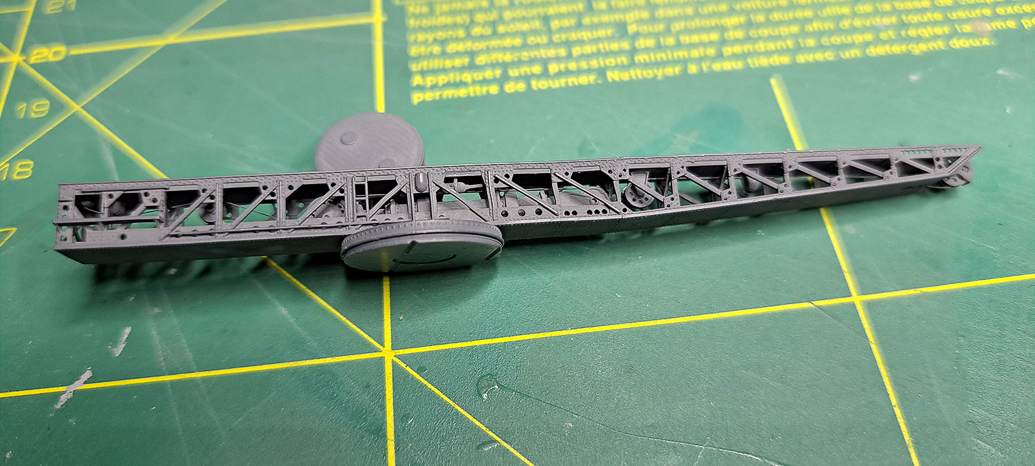

Another small step to "close" the stern deck.
Drydock: IJN Fuso
Launched: ORP Piorun
Gallery: ORP Piorun
wefalck
Posts: 2124
Location: Paris
Re: Battleship IJN Fuso 1/200 - card paper/3D print
Post by wefalck »
OK, drafting will take a few hours too, but thinking of making all these parts in the traditional way by hand would take weeks and in the end may not be looking so good and may have less details. Looking forward to see the trolley printed.
