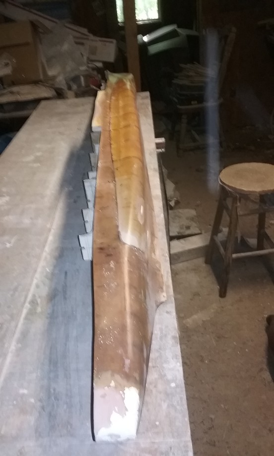

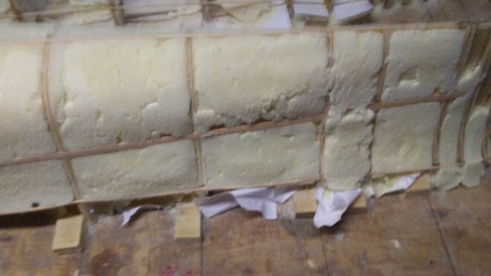

File comment: piano wire inlaid into bulkheads for blister
File comment: I use spray foam to fill in between bulkheads

The plans showed were the blister contacted each bulkhead . I cut a notch in each for piano wire to sit in .That defines the blister and will keep a nice crisp edge .

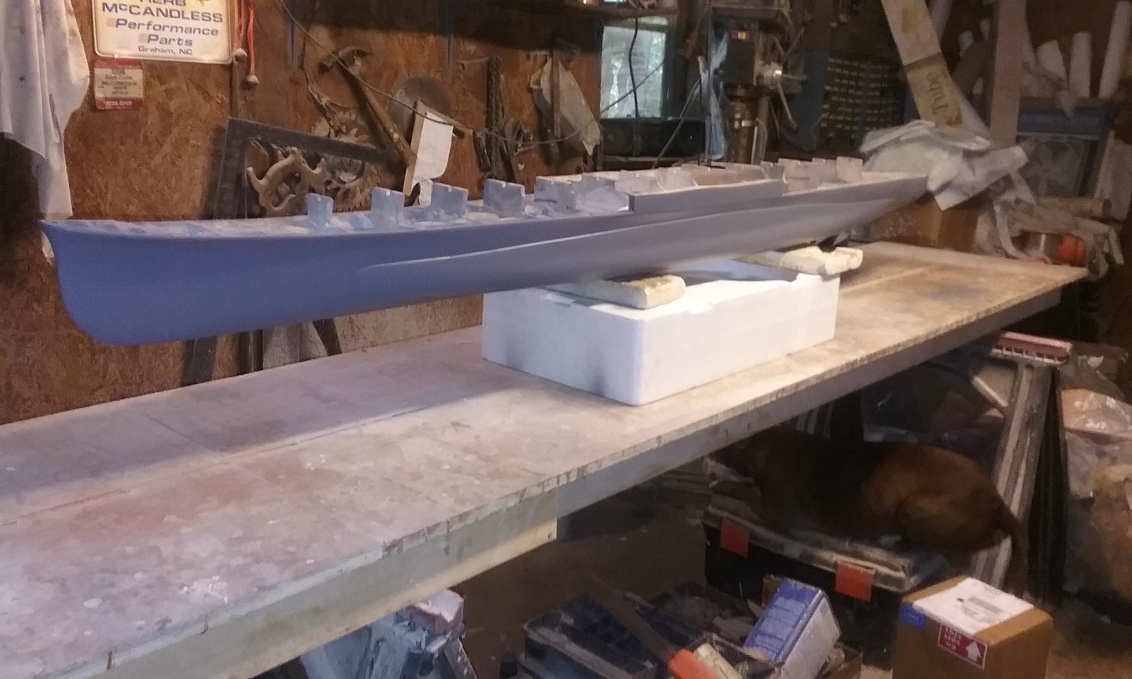

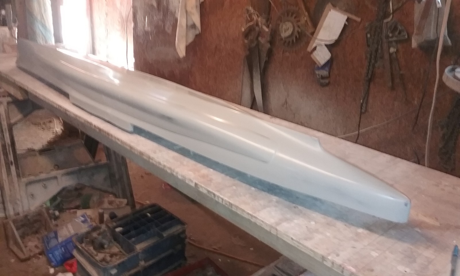

Plug with blisters is finished .It is primed , sanded to 1000 grit then polished .

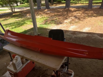

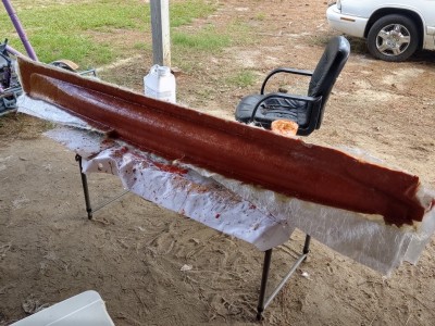

I have finished the mold for the Takao . It is waxed and ready to make the first hull . :wave_1:
File comment: making a split female mold .Used Tooling Gel-Coat and one layer of cloth then four layers of 1 1/2 oz mat

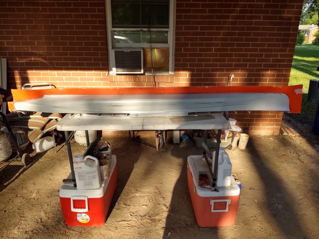

File comment: the mold all waxed up .
