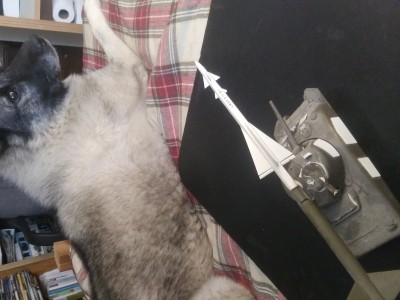

Ahh, THAT kind of Sherman. For a minute I envisioned you mounting a Terrier system on a WW2 tank.
An interesting concept!

what an interesting concept joeP a sherman tank with terrier missile, here is a photo
*note missile is nike-hercules as I do not have any terrier missiles in big enough scale.
