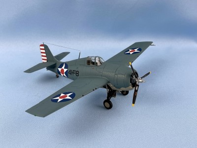

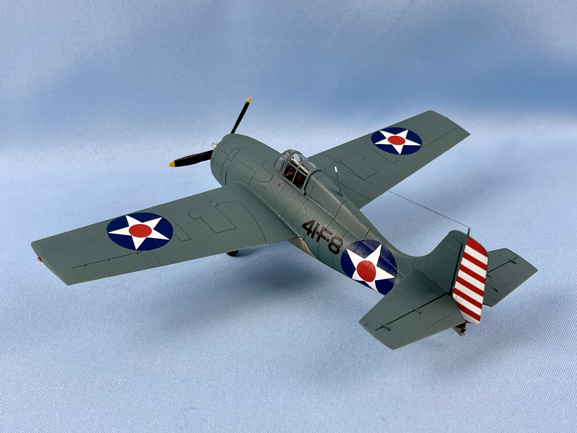

Well, it's been a minute since I last posted. I had a busy summer and fall since my last post: Trip to Ireland, trip to the IPMS USA Nationals in WI, trip to ScaleModel World in the UK and then over to France. In between was work, local hobby shows, work, hockey games, work and life. Oh, and work.:frown_2:
The "quick" Wildcat build, of course, took much, much longer than anticipated. I had to ditch the resin conversion set and the resin after market cockpit, as neither fit, and go mostly out of the box. :mad_2: But, the first of two is finally completed:
File comment: F4F-4, VF-4, USS Ranger, October 1943 (Operation Leader)

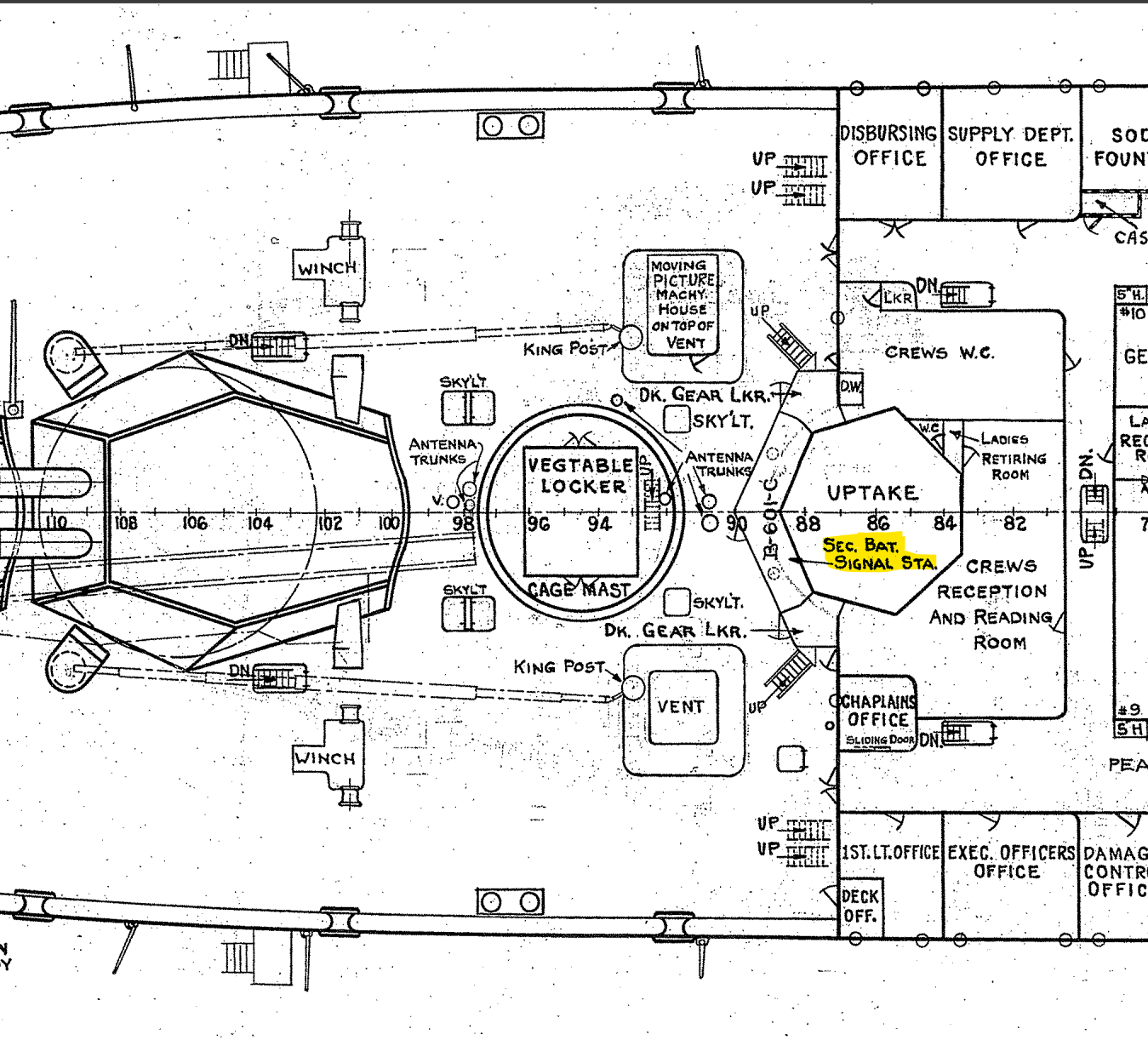

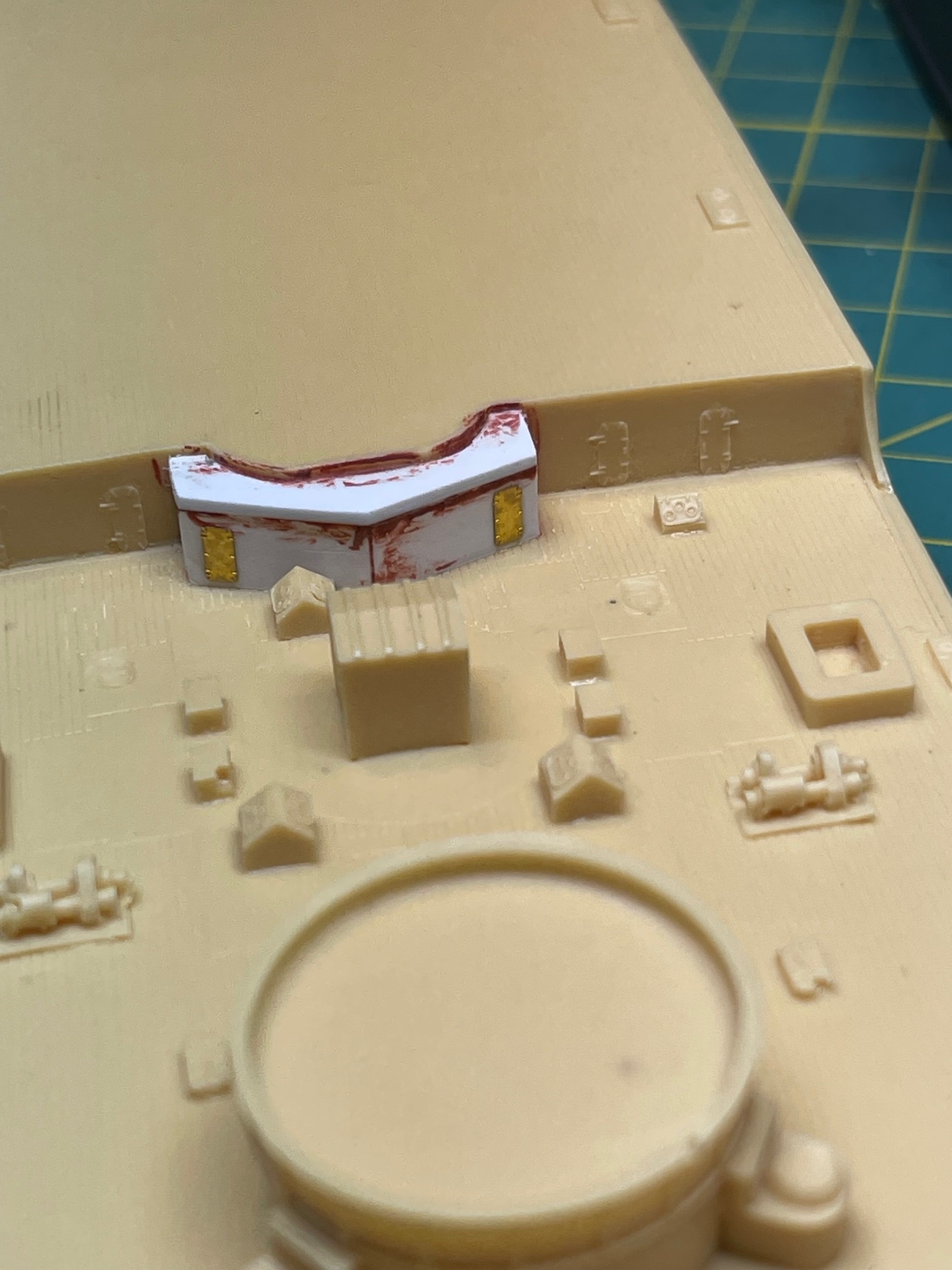

Sometime in the mid-30's, a "Secondary Battery Signal Station" was added to all of the Big 5. Neither the old BWN California or the newer (but still old) YMW West Virginia have this structure. The lack of this structure was glaring, and it is what put the brakes on these builds for awhile, while I figured out how to build them.

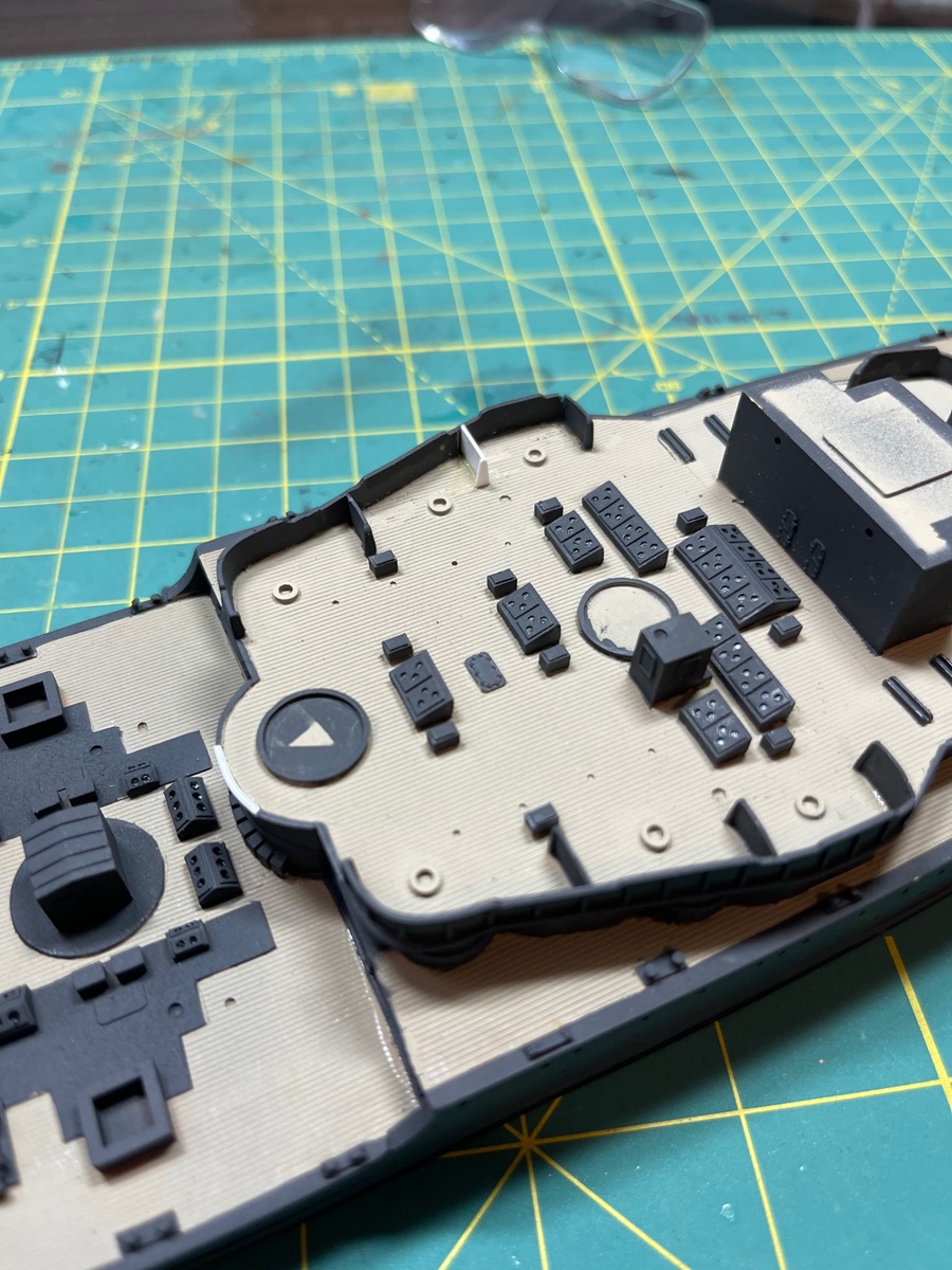

After consulting with some modeling colleagues, I went to the hobby store one day (yes, those still exist) and bought some Evergreen strip that seem to be the right size, and took the plunge. I decided to do both ships at the same time.
I printed out a snippet of the BoGP, resized them, and used those as a template. Next, I cut the Evergreen strip to size, glued them in place with super glue, then let them dry overnight. I then added the longer bulkheads, again super gluing them into place and letting them dry. I purposely let them a little longer than needed, then trimmed them to size with a sharp Xacto blade.
When all that was dry, I used plastic card to make the overheads. Given that the two ships are slight different sizes, I used thicker card on the WeeVee than on California. Everything was then puttied and sanded.
I then added some PE W/T doors, per the BoGP.

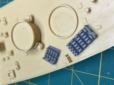

Next up - removing 3D printed chocks for both models from their print rafts, cleaning them up and getting them ready for paint. More than half the chocks on CA were broken, so I shave them all off (that's why you see bare resin on the sides of her deck), and the WeeVee had no chocks or bollards at all. For WeeVee, I'll be using the same turned brass bollards I used for Okie.

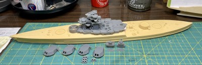

Finally, I took the ModelMonkey 3D printed WeeVee superstructure out of storage and removed all the parts from the print rafts. Oy, what a chore that was! I managed to break off the rangefinder arms on 3 of the 4 turrets, and could only find 2 of the wayward parts. The other was eaten by the tile monster (cousin of the more familiar "carpet" monster).
I'll paint the 3D printed chocks soon, then probably pause, as I have a deadline to finish the F**king Charles de Gaulle and need to prioritize that POS first. Whenever I get back to these, I'll focus on California first.

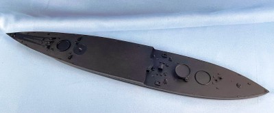

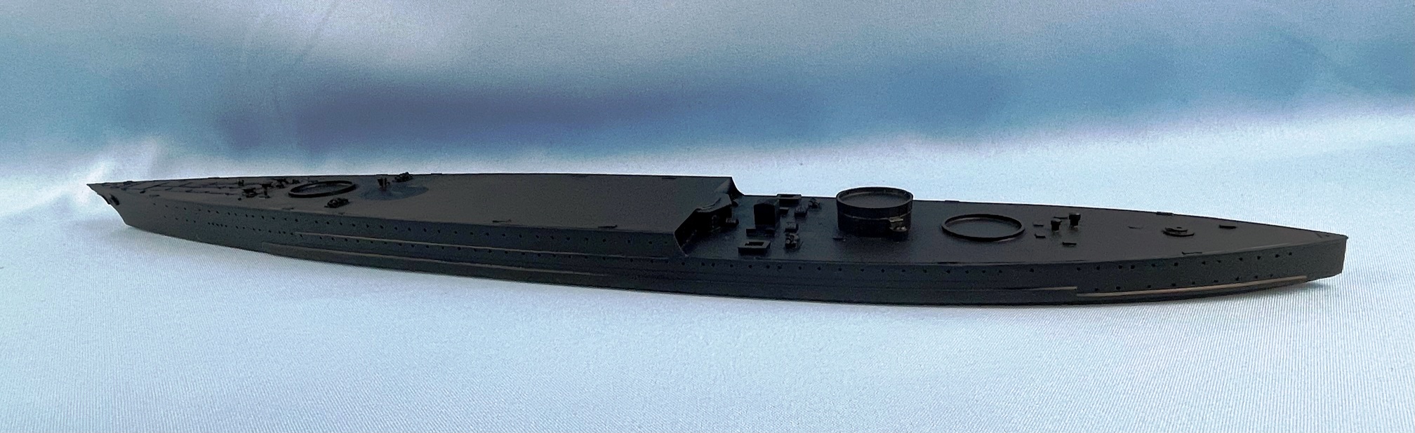

Incremental progress made, in between other projects. First, I primed the WeeVee's hull black.

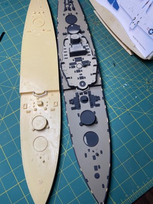

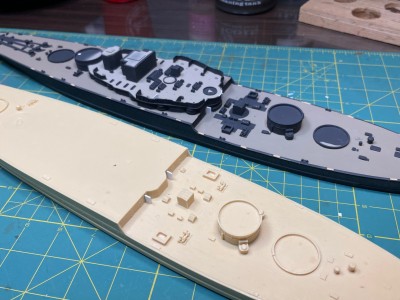

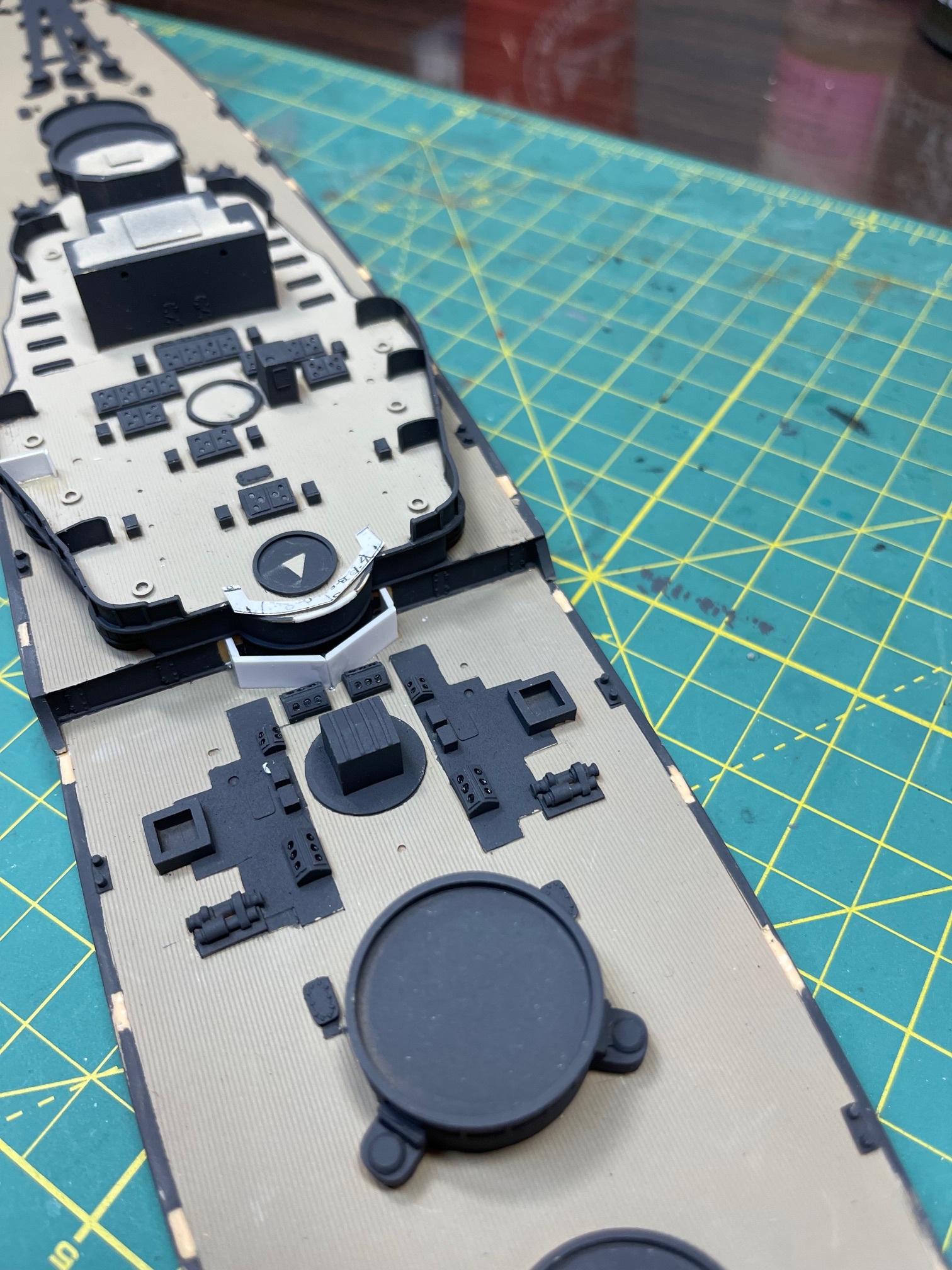

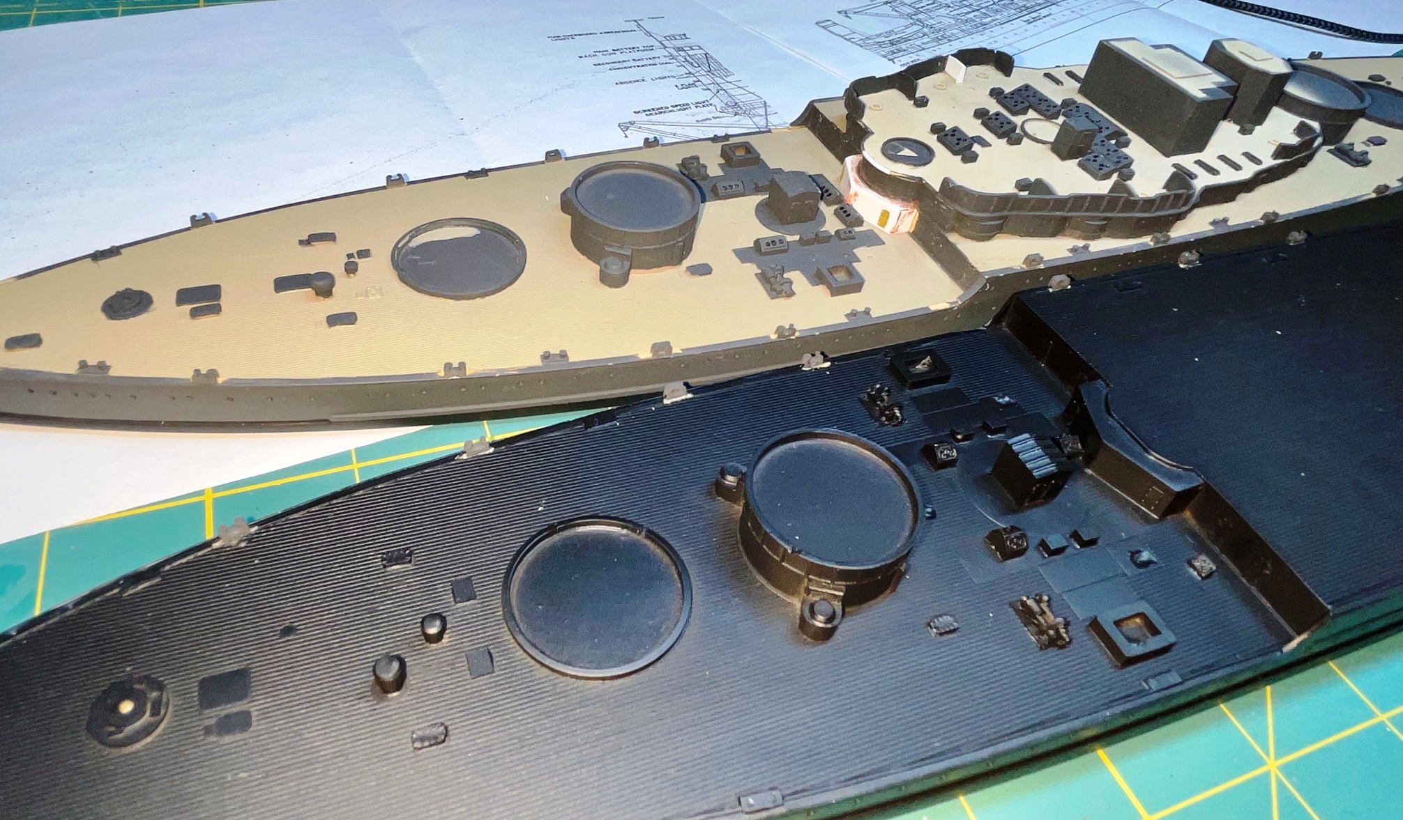

I also started adding 3D printed chocks from BlackCat model to both California and West Virginia. If I had been thinking clearly, I would have added the chocks (and bollards) to WeeVee before priming, but, alas, I did not act logically.
California has all her chock added, but she needs a bit of touch up work. I got one side of WeeVee done, then ran out of steam. I need to finish the other side, then start drilling holes to add the turned metal bollards (same one's I used on Oklahoma).

Nice work, M.
Welcome to the club. Again.

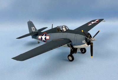

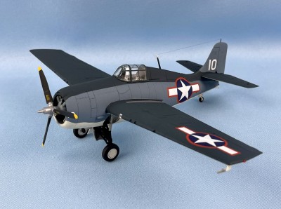

Wildcat #2 is done. Came out like sh*t - the dull coat ended up leaving a pronounced orange peel, which ruined the model in the end. It will look ok on my bookshelf, I guess.

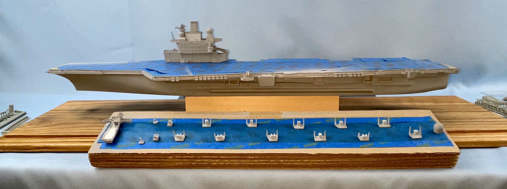

In parellel to this, I've been working on the horrendous, horrible, no good F**king CdG:

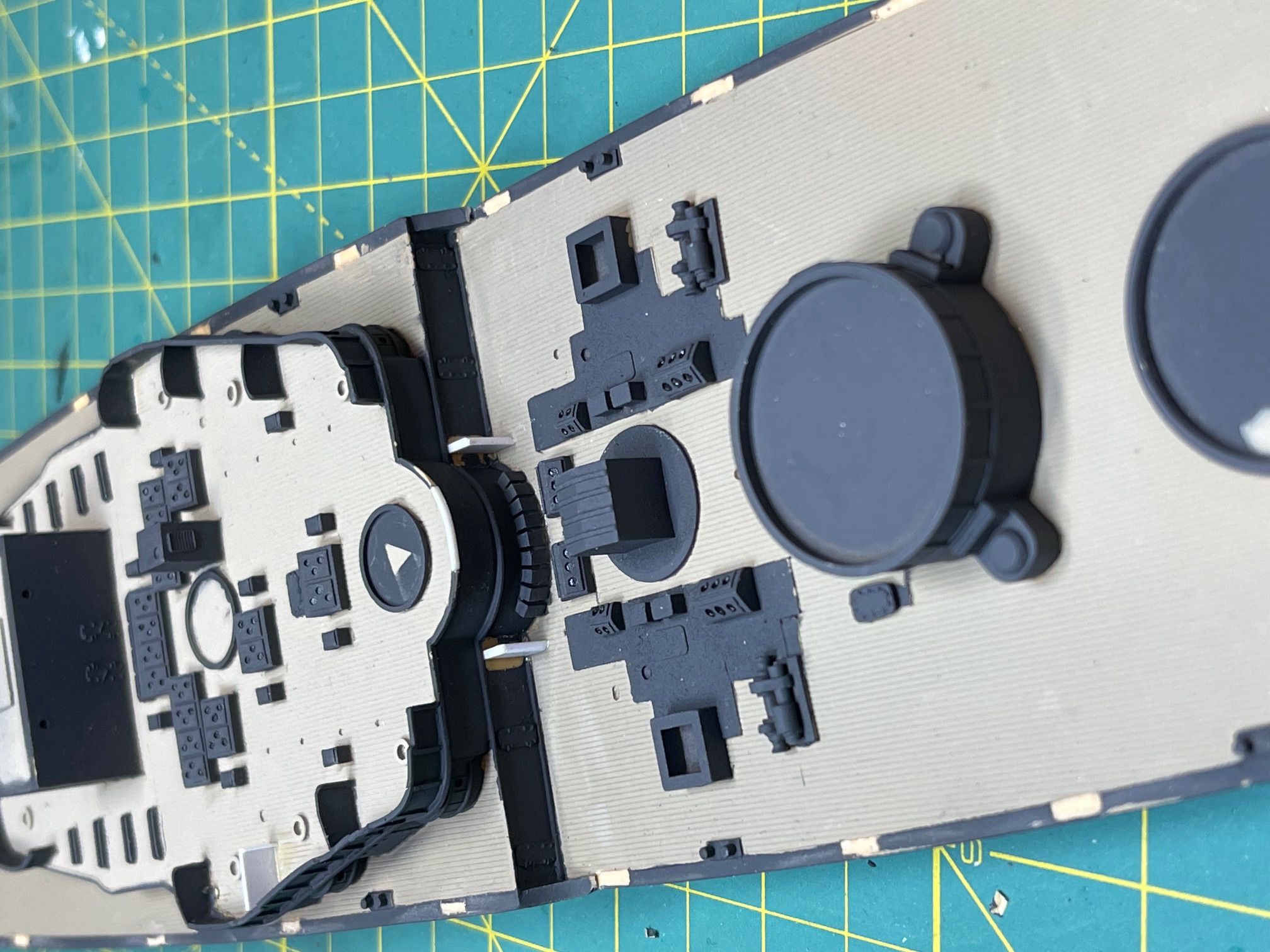

Meanwhile, I finished adding all the bollards to WeeVee

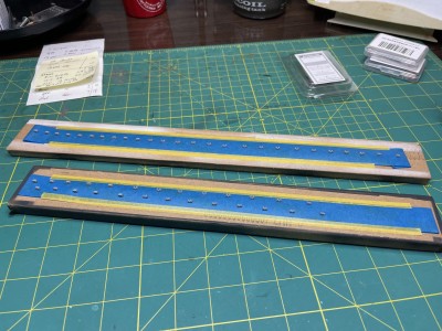

I made a template of the casement deck and attached that to the deck in advance of painting, so that area under the deck stays black.

Nice job on the "Secondary Battery Signal Station" Martin! Another thing in this area that has always bugged me on all these Big Five kits is the bolted on deck plates on either side of the cage mast. I have never been able to find any pictures of any of the Big Five showing this area having bolted deck plates. Just like the Arizona kits that wrongly have bolted on deck plates, I fear this feature is wrong on the Big Five kits as well.
The plan of West Virginia's main deck that you posted above doesn't even show any plates there. I believe that every time a new manufacturer produces one of these kits, they are simply copying this feature from a previous version from a different Manufacturer. Makes me wonder where it first started. Did Jim Shirley produce the first Big Five kit? Classic Warships? Tom's Modelworks?
PostPosted: Sat Feb 22, 2025 12:09 am
Online
Posts: 495
it is possible that the Big 5 did not have those plates as I just went thru looking at their BOGPs & even tho not all are complete, none show those plates from deck 2 & below wereas Idaho does show those plates.

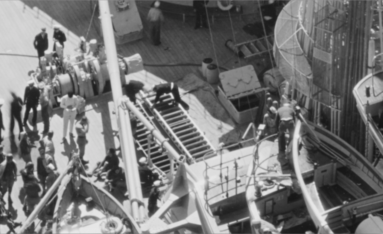

And this view of West Virginia shows nothing but teak around her winch and the skylight. The crew has a tarp laying on the deck with the accommodation ladders laying on that tarp but there is absolutely no evidence of steel deck plates here either.

Great photos. Nice shot of the accommodation ladder stowage.

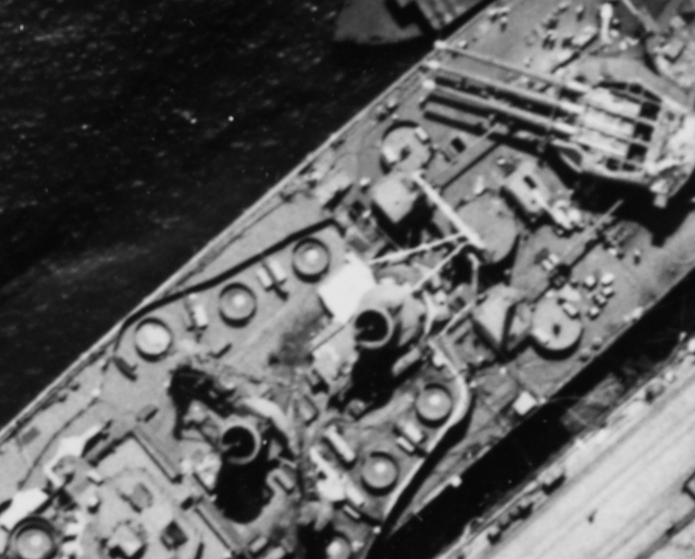

PostPosted: Sun Jun 01, 2025 11:58 am
Posts: 8339
Jeff,
There are hints of something there that match the WeeVee plans in a few photos. Colorado had something different, but the plans I have for her (given to me with the understanding that I can't share), are 1944, so the area may have been reconfigured when she lost her mainmast and got her tower.
Tennessee - on the right of the photo, you can see the inclined ladders coming off the boat deck, matching the configuration of the WV plans

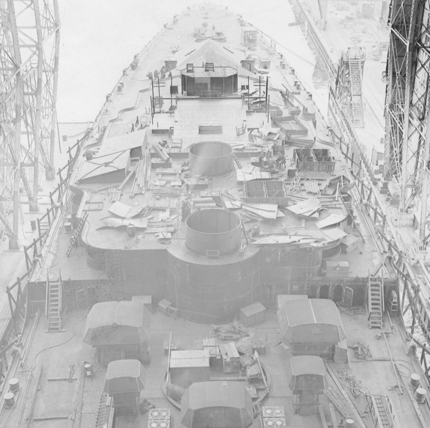

California - I think you posted this photo once upon a time. It look like you can see the partial outline of the structure in this overhead shot.

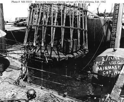

California - again platforms and inclined ladders in the lower portion of the photo, which descend down off the boat deck, seemingly conforming to the plans.
I will dig through my photos, as I think I have something else, but can't find it at the moment.
HTH,
PostPosted: Sun Jun 01, 2025 1:10 pm
Posts: 999
Finding a good shot of this area on any of the Big Five is definitely a CHALLENGE to say the least!
Here are a couple of shots of that area on USS California. Not the greatest looks but I'm not seeing a Secondary Battery Signal Station in either pic.
But this one "suggests" that there was one there.
