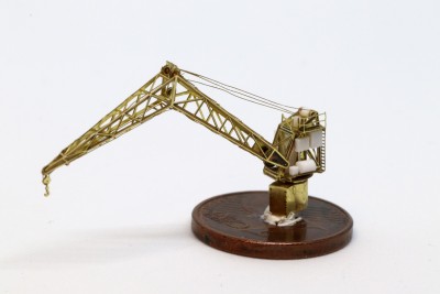

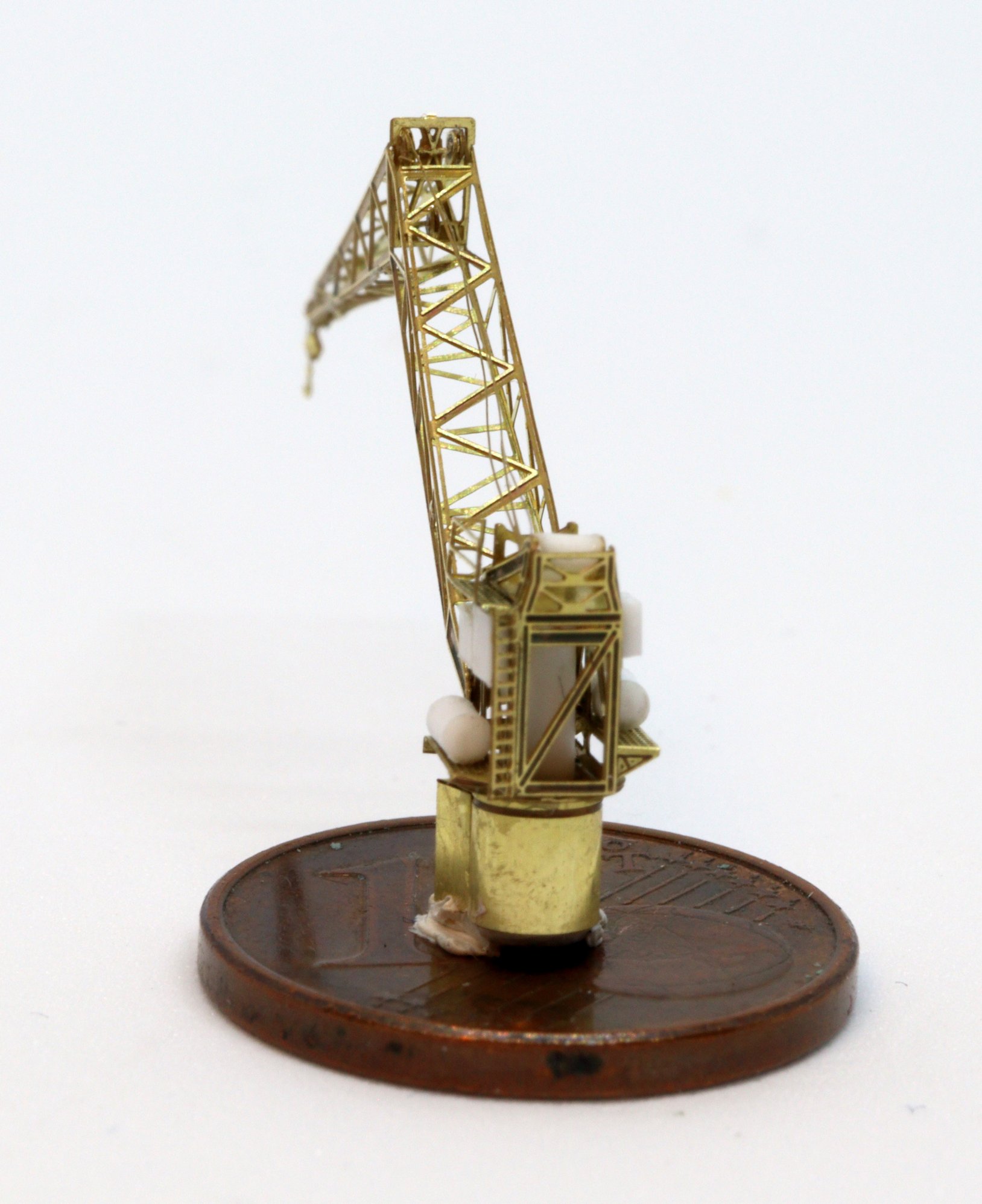

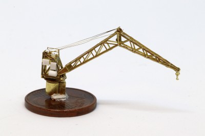

Aircraft cranes
The large cranes represented a very distinct feature of not only Kent class cruisers but of most major British pre-war warships. Originally, Kent class ships were equipped with a lighter version that was replaced later with a heavier crane along with introduction of heavier airplanes (Supermarine Seagull). Cranes deployed on different ships also differed in details. Out of the many depictions in 1/700 available on the market, none really appeared well-detailed and close enough to Australia´s cranes as can be seen on numerous photos.
Also the port and starboard cranes onboard Australia were not exactly the same. The main difference was the control platform that was placed outboard on each crane, plus there were other minor differences in the equipment (“boxes”) on each one.

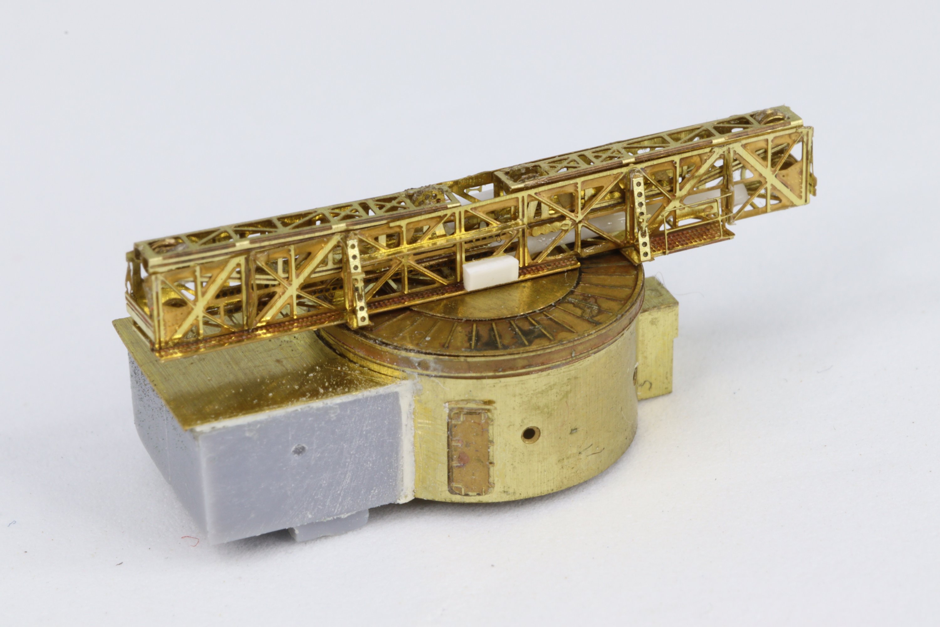

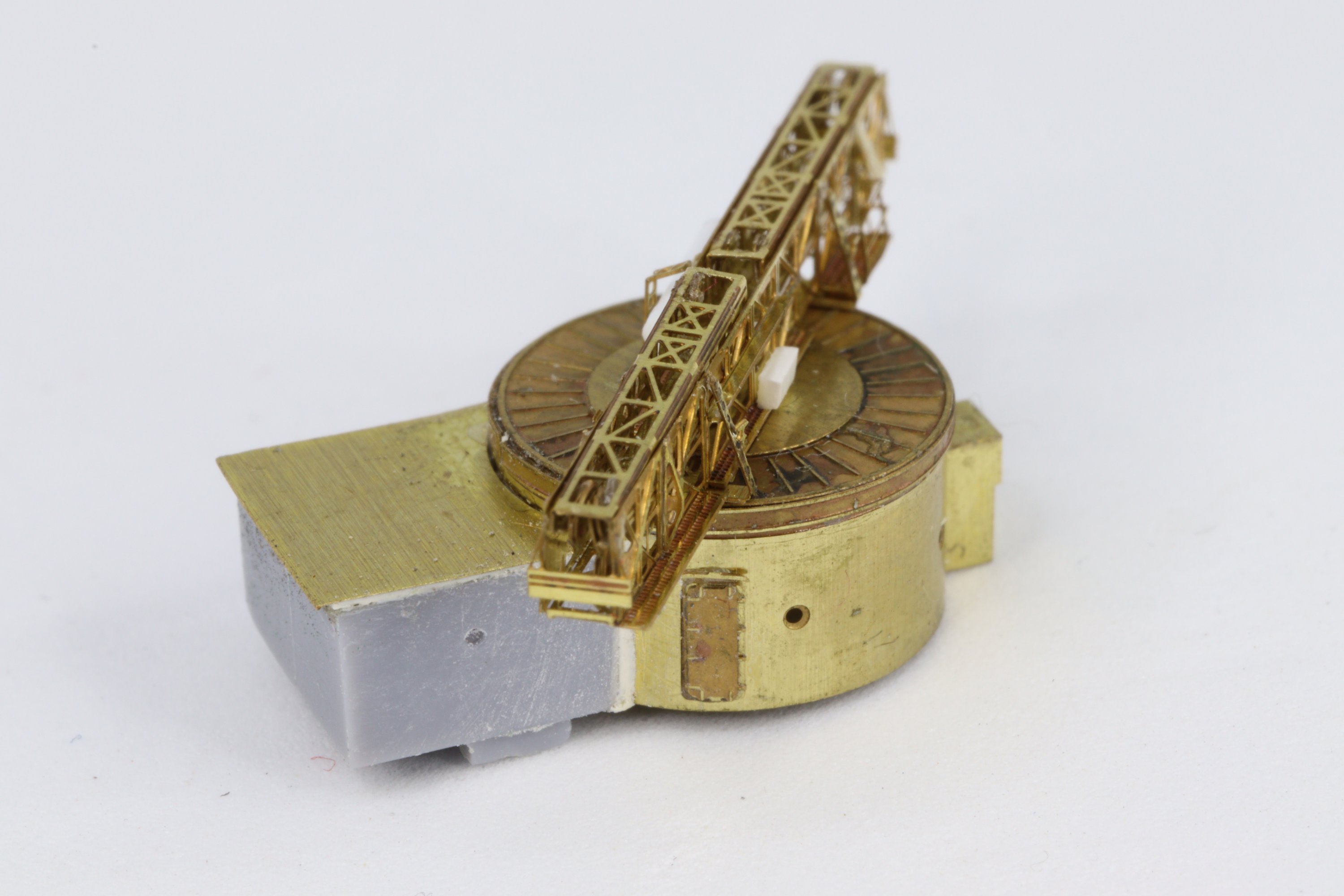

Catapult
Similarly to aircraft cranes, the original lighter version of the catapult had to be adjusted to the much heavier Supermarine Walrus airplane. The catapult represents the most complicated tiny sub-assembly of the model except of the main bridge. The catapult itself (without the base) consists of over 20 PE parts plus several pieces of plastic rods and sheets.
Please note that the "sunrays" seen on the catapult turntable are incorrect and have been removed later.

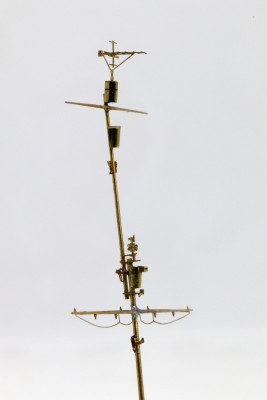

Foremast
Another tricky part thanks to the numerous tiny details incl. crow´s nests, lights, weatherwanes and A290 radar. A result of – as usual - lenghty discussions with Brett Morrow I think we nailed it right.

PostPosted: Fri May 30, 2025 2:11 am
Posts: 2580
Now that is some mighty fine PE work Vladi! :thumbs_up_1: :thumbs_up_1: :thumbs_up_1:
PostPosted: Sat May 31, 2025 3:59 am
Posts: 299
I second that, super-super cool :cool_1:
PostPosted: Sat May 31, 2025 10:03 am
Posts: 8816
Wow.
PostPosted: Sat May 31, 2025 7:09 pm
Posts: 8339
Brilliant PE work, Vladi.

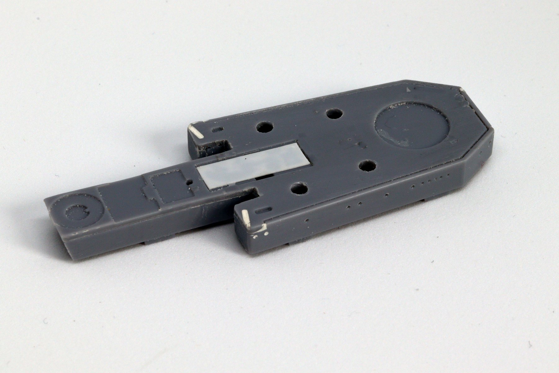

Adding some photos from works on the deck and the hull. One of the obvious differences between Kent and Australia was the AA deck, which was one level above the main deck in case of Kent, while Australia had her secondary armament placed on the main deck. So some surgery was needed to separate the funnel bases from the AA deck. Note the holes drilled into the forecastle deck as an aid for installing PE overlay so that CA glue could be added from the bottom in the process.

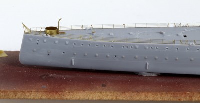

As mentioned earlier, the hull was originally prepared for portholes to be sealed with PE parts, but these did not turn out looking nicely to me.
So I had to drill out all of the acrylic putty again in order to fit the plugs Simon printed for me. These were fixed with PVA glue to be able to realign them later if needed but they looked like very much in line at the first attempt. The carpet monster only got less then 10 of them thanks to using a masking tape to hold them - after the first two of them flew into oblivion while being removed from the sprue ;) .

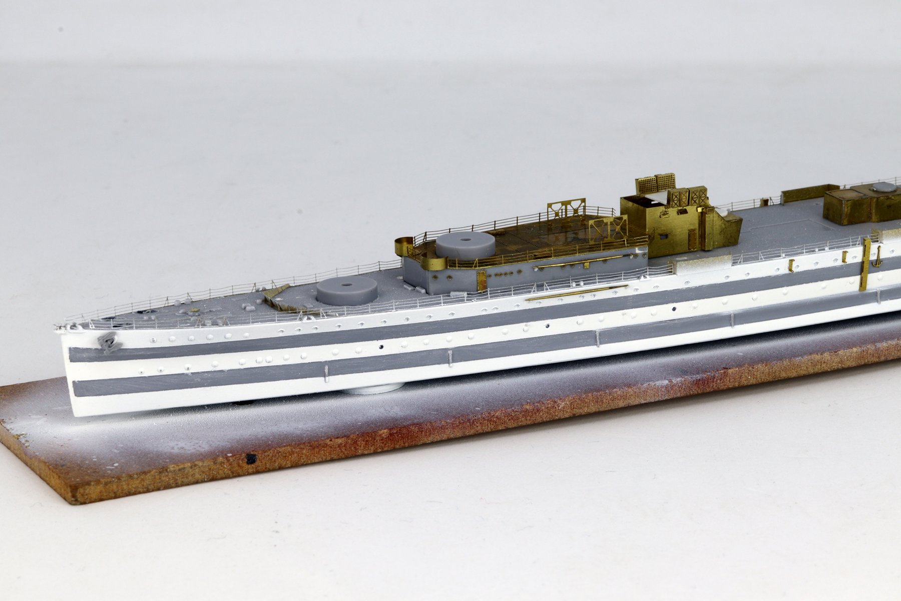

Hull plating was done by spraying primer (Mr. Base White 1000). I did not dare to use masking tape over the very thin railings so I had to protect it using a piece of paper mostly held by hand while spraying so that not much was added to it´s thickness. The last photo shows the hull with hull plates in place as well as the PE overlay on the forecastle deck to add planking to the deck. Other details were added to the hull like chutes, booms, Byers anchors etc.
BTW the vertical exhaust covers just above the waterline turned out incorrect later for Australia, so they had to be removed. A bit tricky at that late stage, but if came out not too bad in the end.
