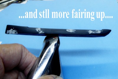

But.... there has been occasional proper model ship , progress as the images below will testify;
aside from endless fairing and smoothing

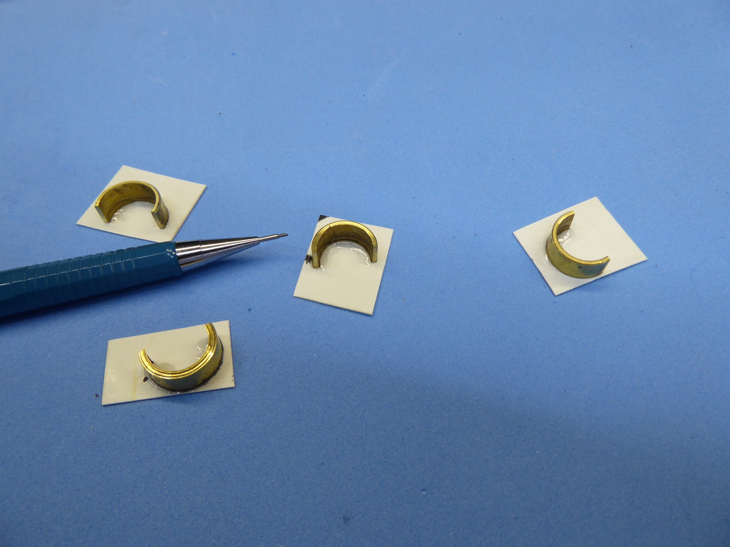

I found myself to be dissatisfied with my earlier paddle boxes--the surface of the media was not as smooth/ homogeneous as I would have wished ...
so I made some new ones ( x 4 in case of damage / error ) cut from of 14 mm thickwall brass tubing
which the outer faces made of Styrene ,
The styrene was subsequently pared and sanded to shape -this also gave the correct final paddle Box width

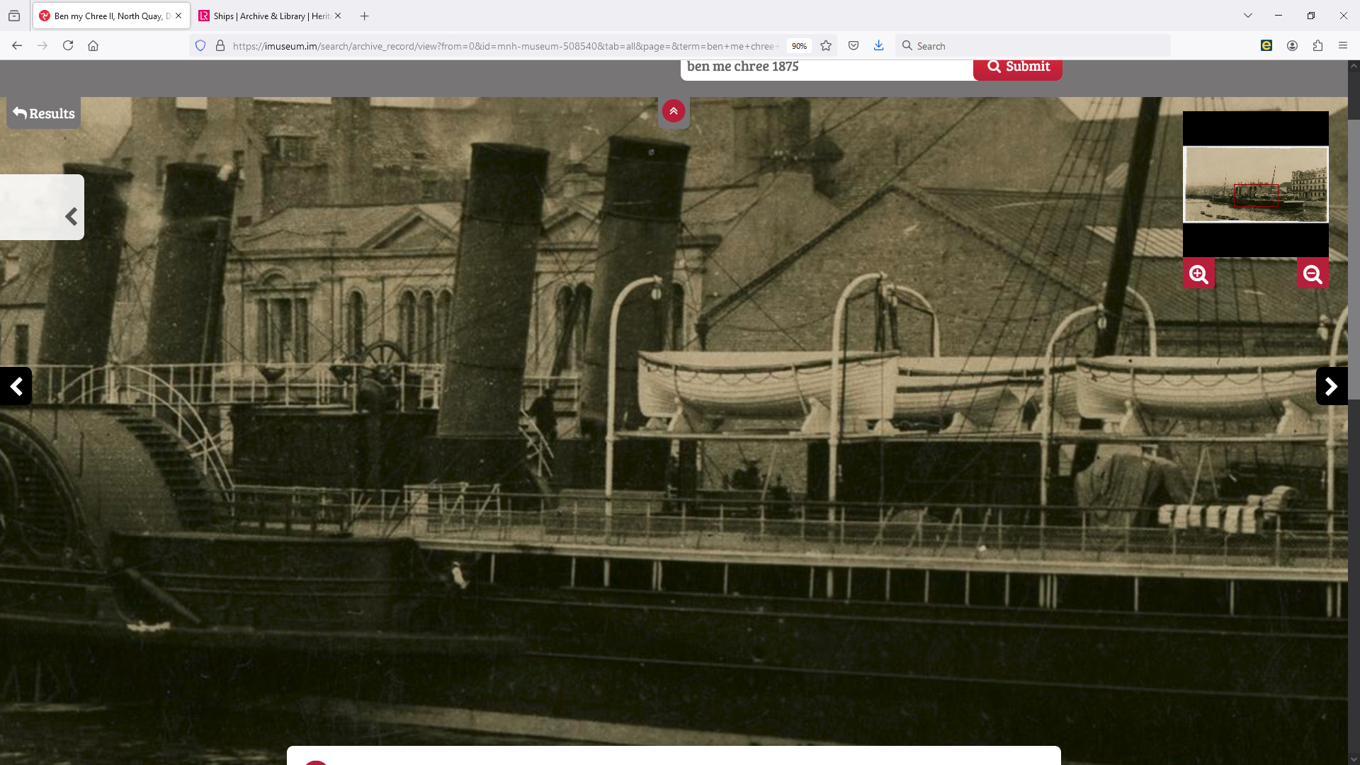

here are some images of the boat deck on the real ship,
note the deck is ' thin ' and the upper strake has an inset below
and that the davits pass through well inboard and inboard of the lower coaming
The deck also overhangs the lower hull a bit
here is another view from fwd which confirms the earlier findings
and 3/4 port aft detail crop
