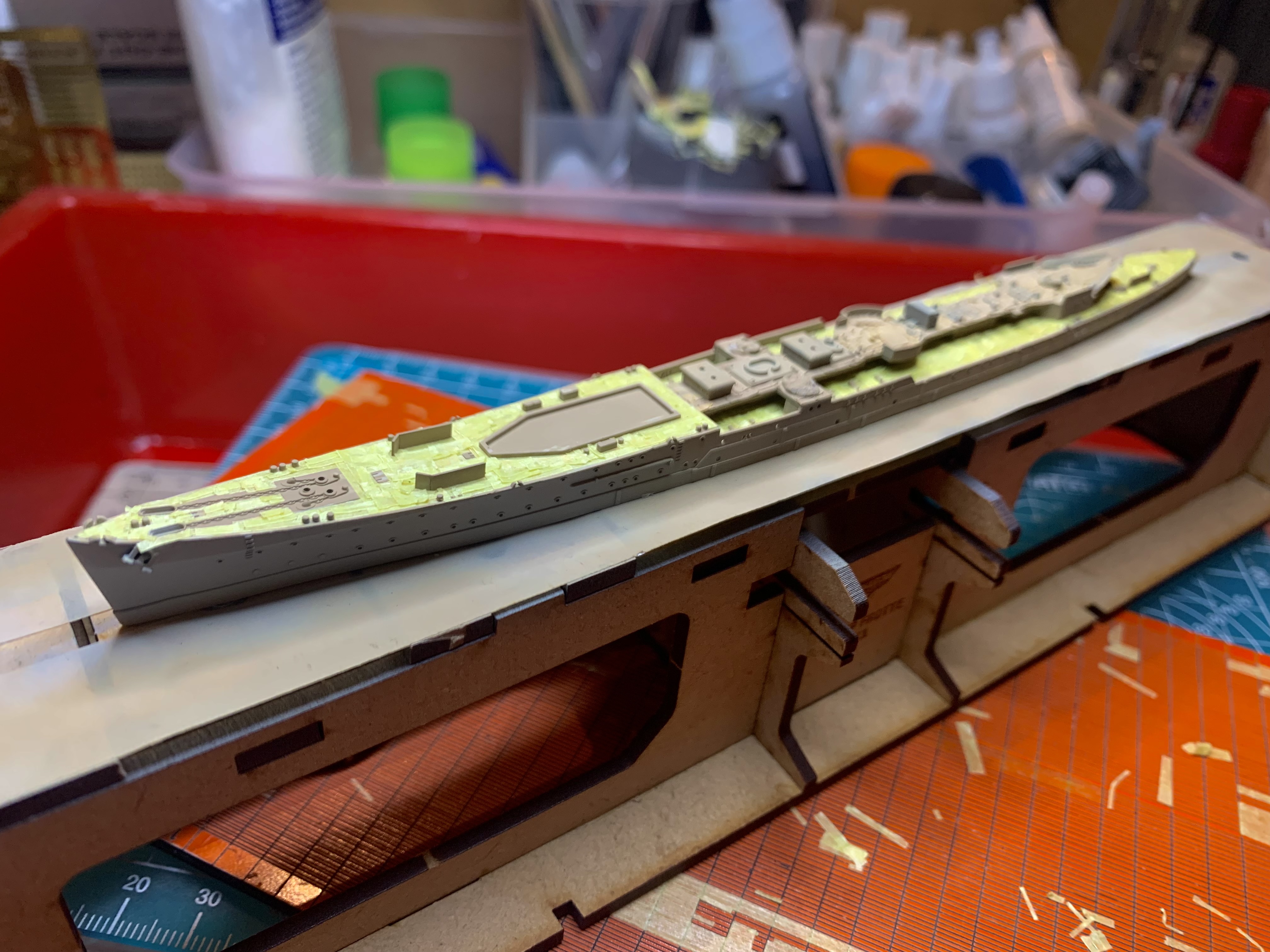

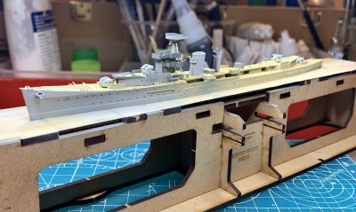

Kindly gifted to me by a family friend last year and so far a pleasant and unproblematic experience to put together. There isn't any specific aftermarket for this kit, and I'd like it to a quicker build to knock out of the way, so I plan to limit modifications to the following:
- PE portholes since the kit portholes don't have eyelids
- Piping along the funnels which is missing from the kit
- AA weapons replaced with spares from Flyhawk
- 102mm barrels replaced with brass parts
- As I want to depict Calcutta with her 3-tone camouflage scheme, I will have to add splinter shields along the superstructure
There is probably more of the kit which can be replaced or improved but that would probably exceed my time/financial investment in the model. I'll see how I go in the end. Thus far I've only gotten to the portholes and gun barrel replacements.
As always, feedback on my work is welcome :thumbs_up_1:

PostPosted: Mon Mar 17, 2025 9:08 am
Posts: 1554
Nice and clean build so far.

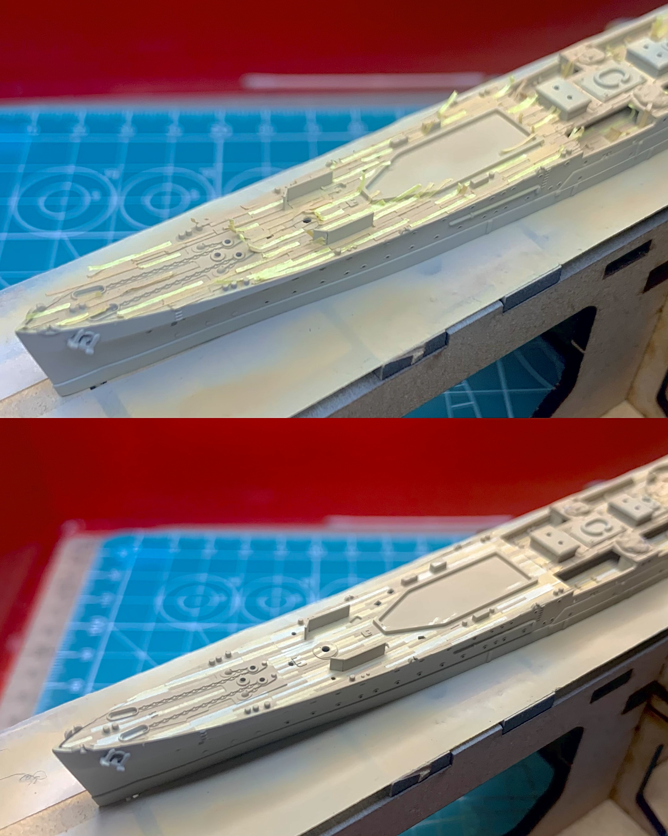

Been working on and off on this one, hence the belated update. Mostly just cleaning up parts and some more portholes.
I find this work to be more tedious than difficult. If I misalign one porthole part I can easily remove it and try again, but the fact that there are so many of them makes for a draining experience. Not looking forwards to doing this on a battleship or carrier.
I did however find that positioning a strip of tape as a guide above the portholes helps quite a lot. It's not perfect but it makes it such that you can't really see misalignments unless you were the one building the model.

PostPosted: Tue May 13, 2025 12:15 pm
Posts: 1972
Location: Stockholm, Sweden
I cant stand the porthole thing and I just dont do them on 1/700 (same for railings on funnels). People who do them in 1/700 are saints in terms of patients surely. :) The misalignment is guranteed in my case, so probably im just not good enough to do them. Well done for you!
