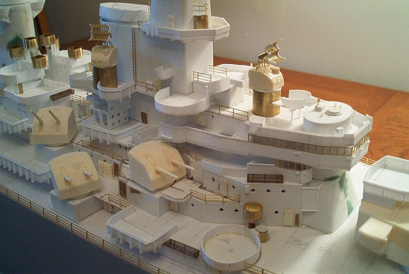

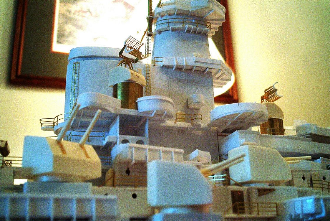

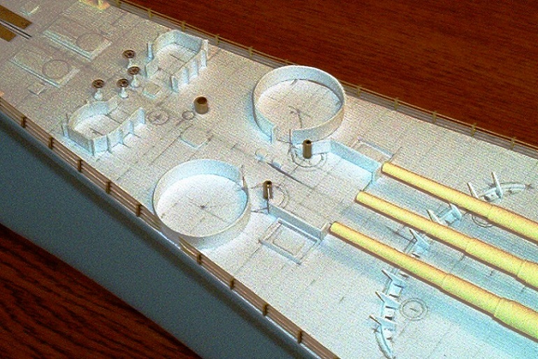

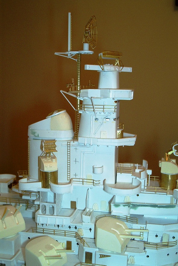

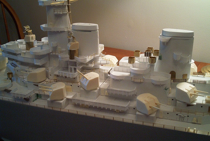

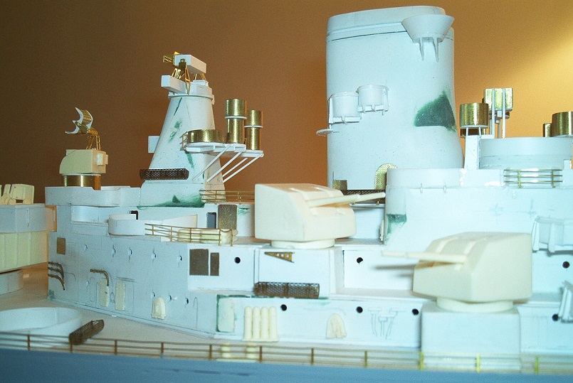

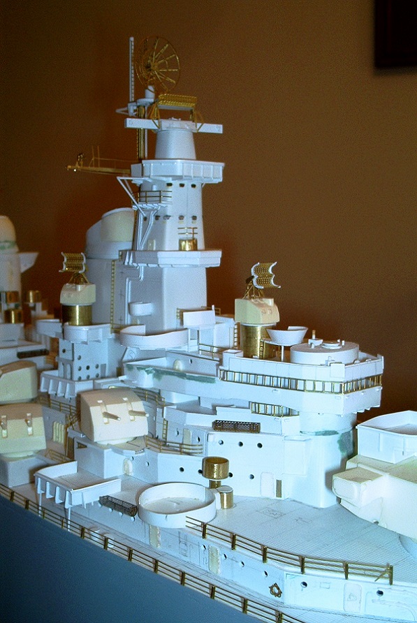

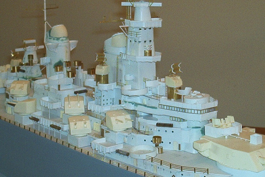

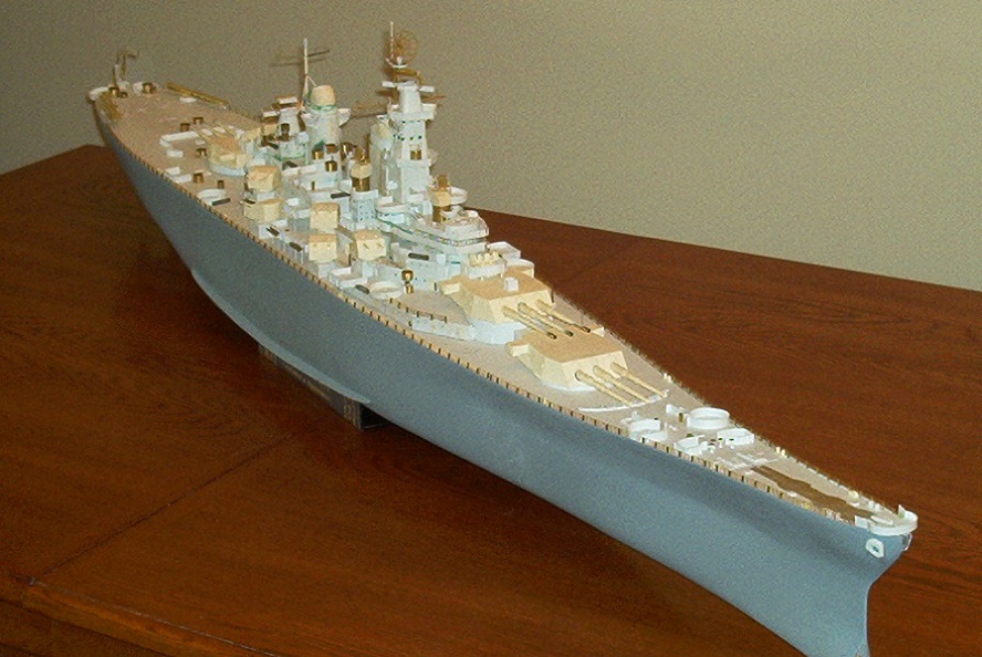

June 2003 the model looked like this:

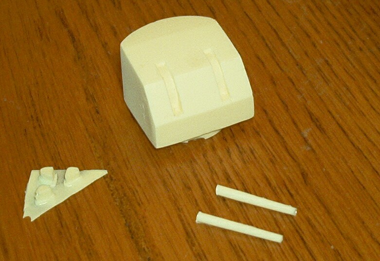

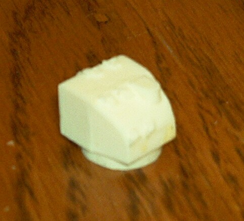

I decided to create masters and cast my own 5-inch mounts. My resin mounts were later improved by incorporating the gun captain's blast hood and replacing the resin barrels with brass barrels. I also mastered and cast Mk-37 Directors in resin. [Edit: all of the resin parts you see here have since been replaced with much more accurate and much better detailed 3D-printed parts of my own design.]
Much of the brass, but not all, comes from Gold Medal Models.

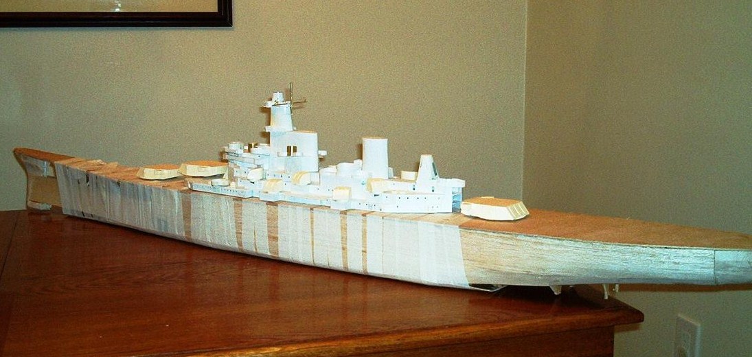

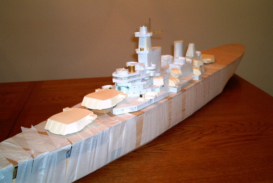

Roughing out of major structures.  You can see that the hull is skinned <br />with balsa sheet glued to a frame made from 1/8&quot; thick plywood.  The <br />masking tape temporarily held the skin in place while the carpenters glue <br />hardened.  The hull was later covered with fiberglass for strength, sanded <br />smooth then primed with automotive gray primer.
with balsa sheet glued to a frame made from 1/8" thick plywood. The

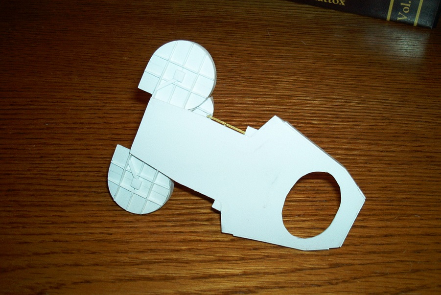

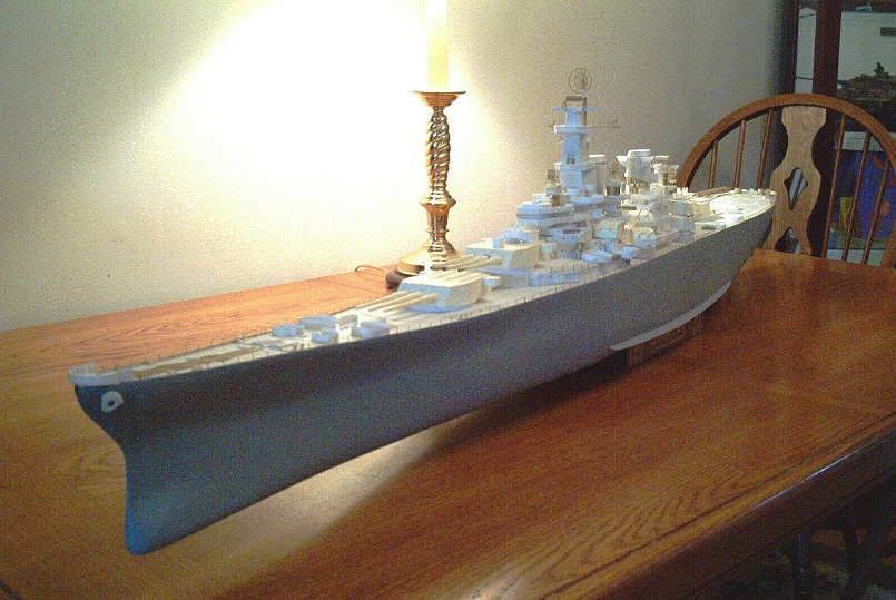

The superstructure is Evergreen styrene sheet and strip.  The main deck is <br />made from 1/8&quot; plywood covered with Evergreen V-grooved styrene sheet <br />to replicate the wood planking.
made from 1/8" plywood covered with Evergreen V-grooved styrene sheet

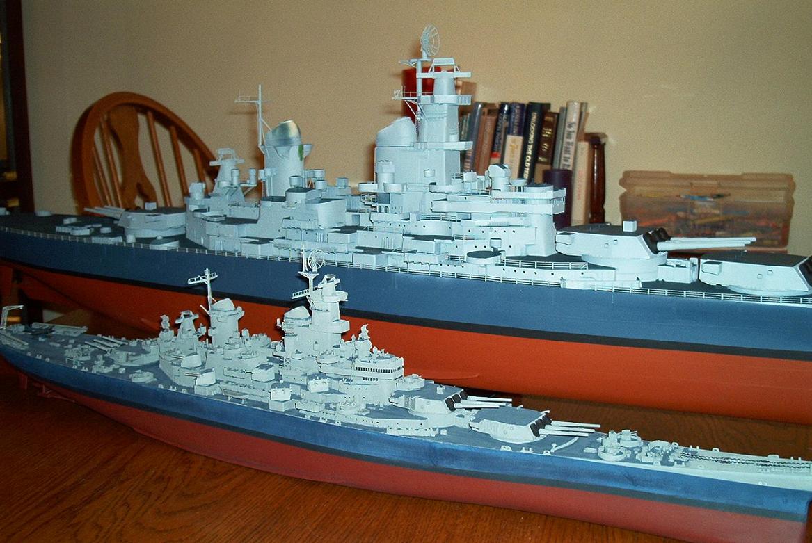

Size comparison of an in-progress Tamiya 1/350 Missouri and the in-progress 1/192nd scale Missouri.

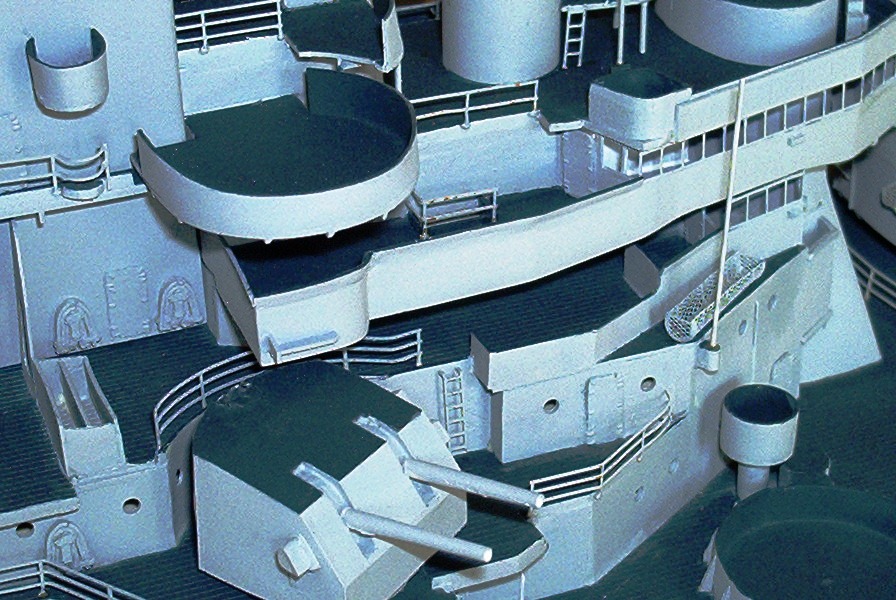

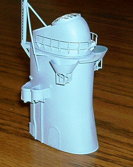

Toms Modelworks photo-etch water tight doors are gems.

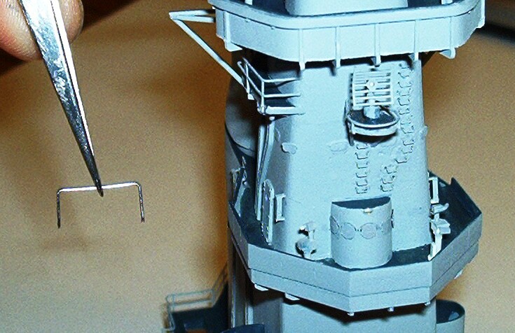

Foot rung installation. Installing foot rungs on the fire control towers is very tedious! Each rung is brass, bent to shape, then installed into two tiny holes hand-drilled with a pin vice.

Aft funnel nearly complete.
The rungs are basically u-shaped brass bits that are included in the exceptional John R Haynes photo-etch Bofors tub. They just need one bend to get into the right 3-D shape.  I used the rung pattern as shown in Floating Drydock's USS Missouri Plans Book.  It seems the pattern changed after the TDY jammer was installed in 1945.  The new path curves around the TDY Jammer platform.
Auxiliary conning station.  Footrungs compared to a standard-sized staple.

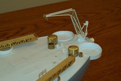

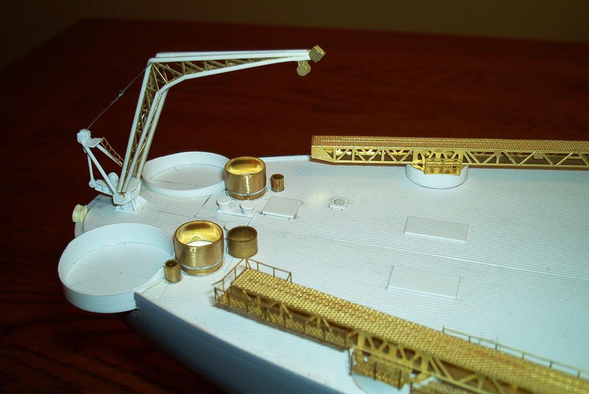

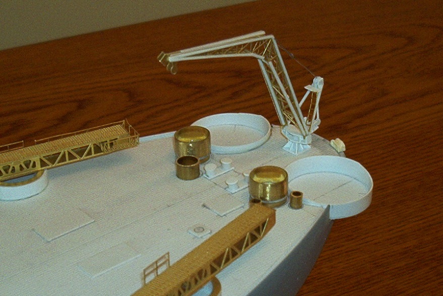

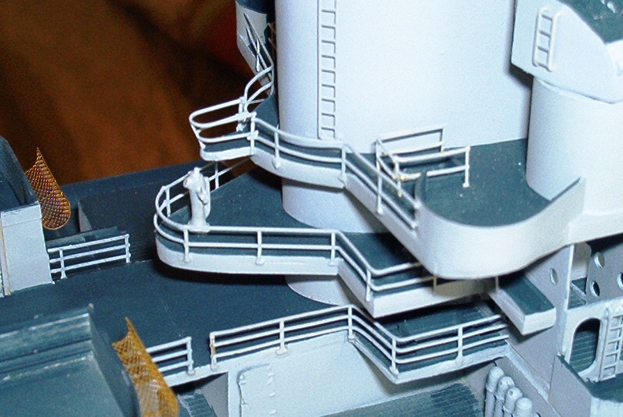

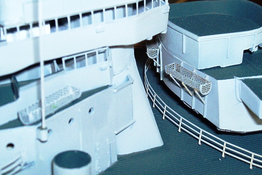

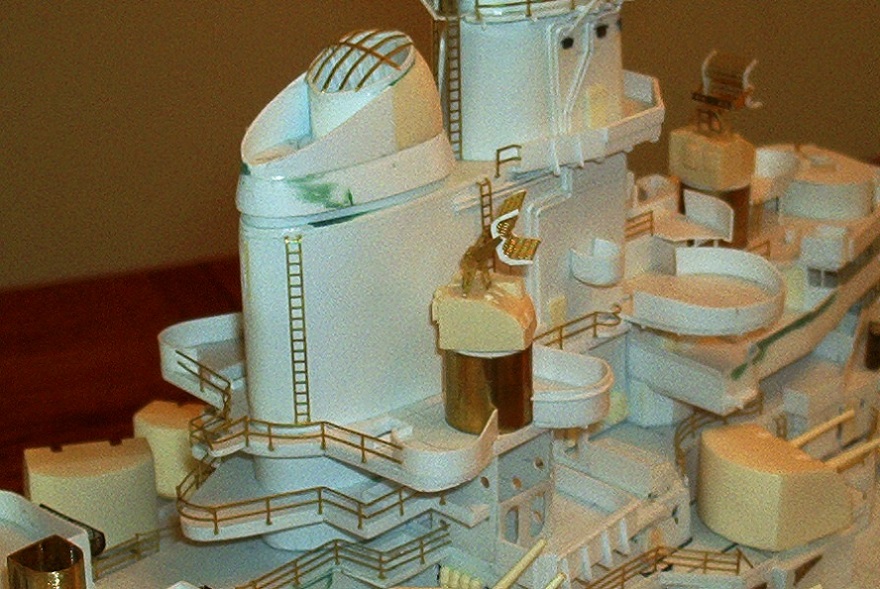

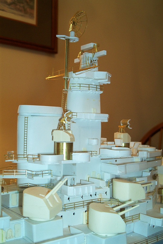

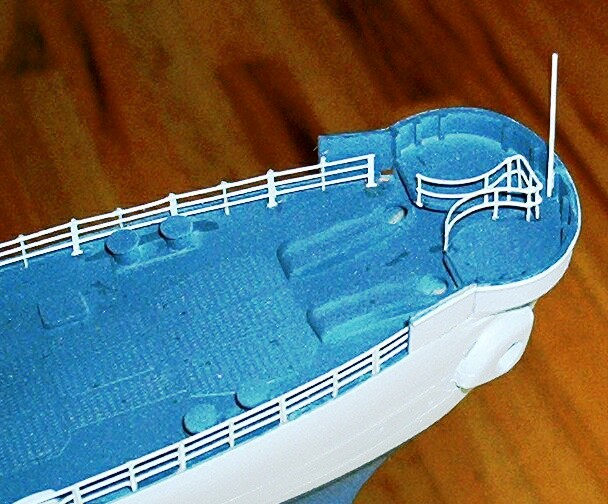

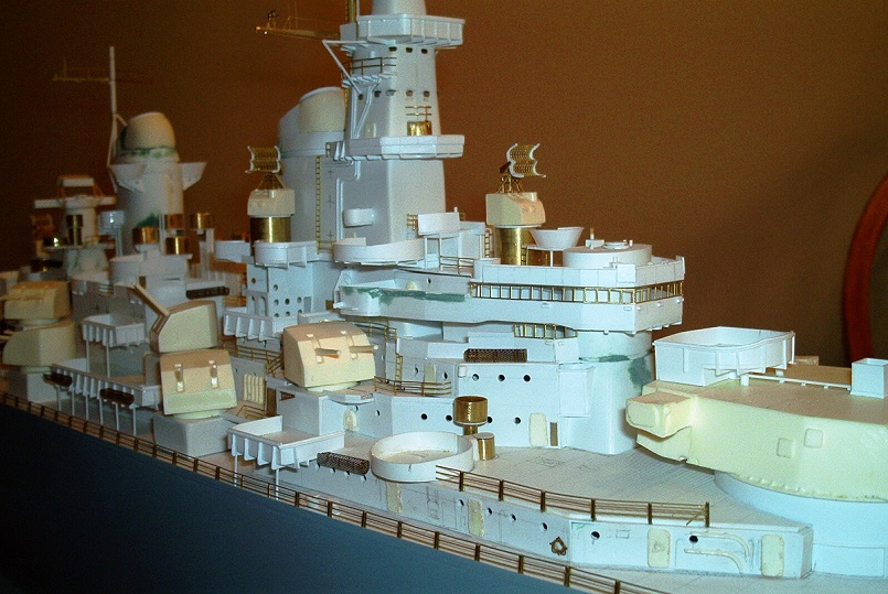

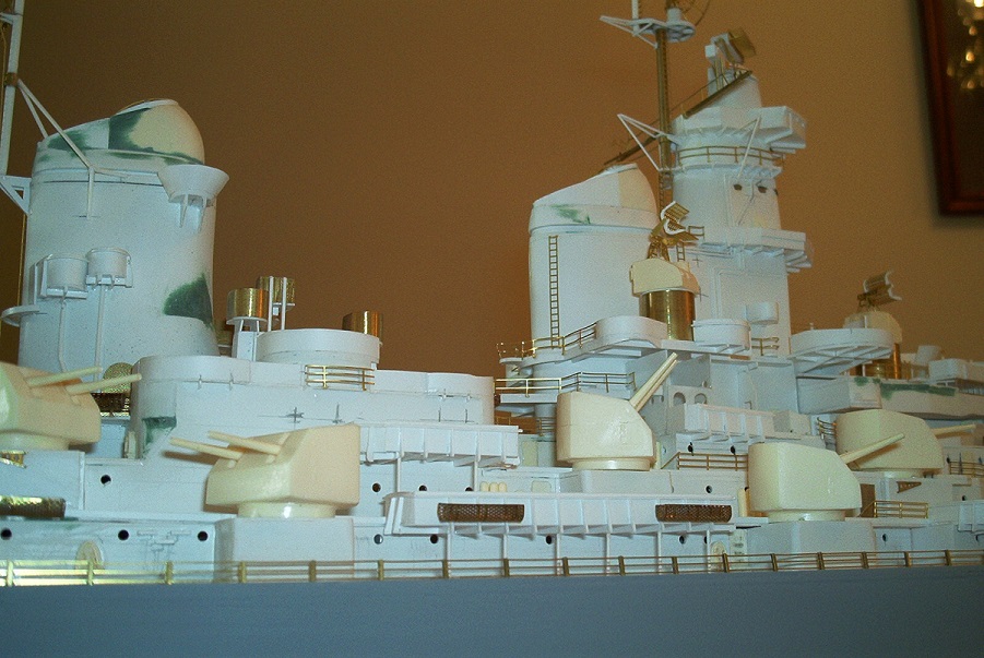

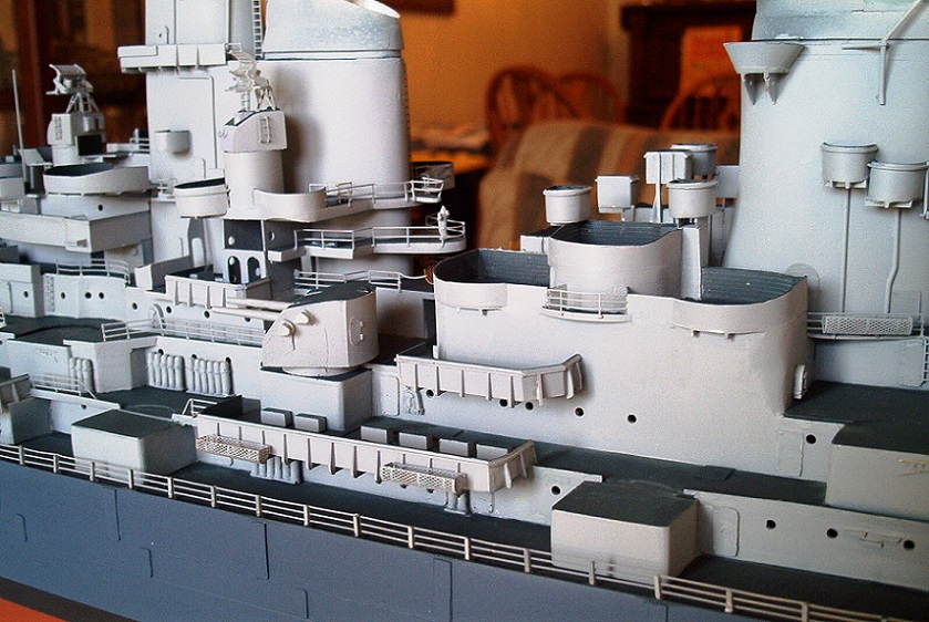

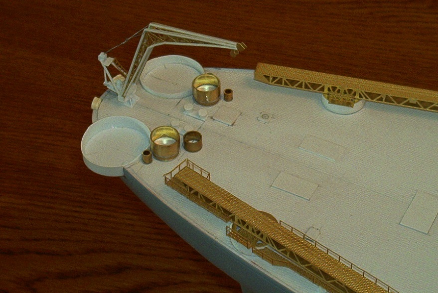

GMM photo-etch brass set being installed. The stanchions on the Main Deck and on portions of the first superstructure deck are individually cut brass H-column sections made by K&S. Tedious to cut and install but they have the right three-dimensional look. She's nearly ready for paint.

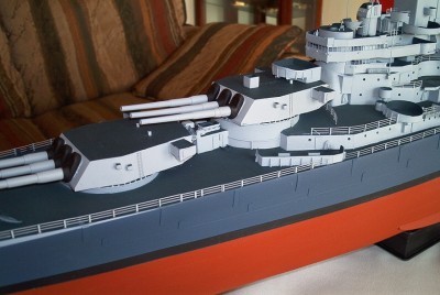

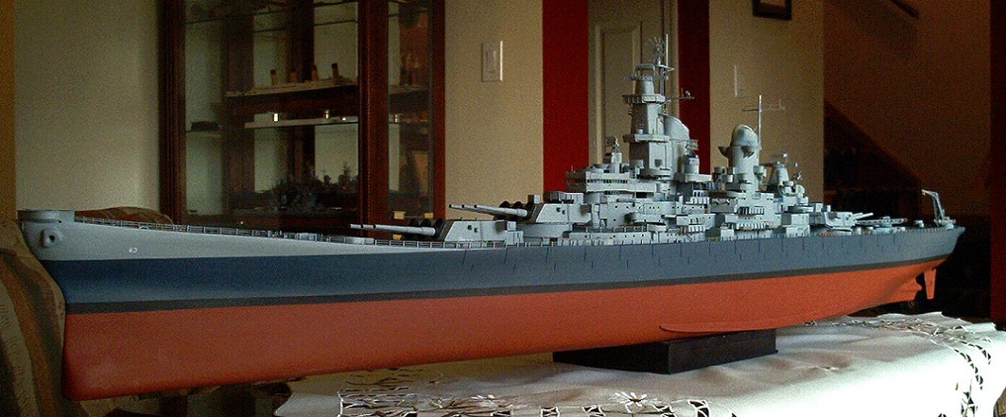

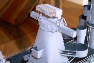

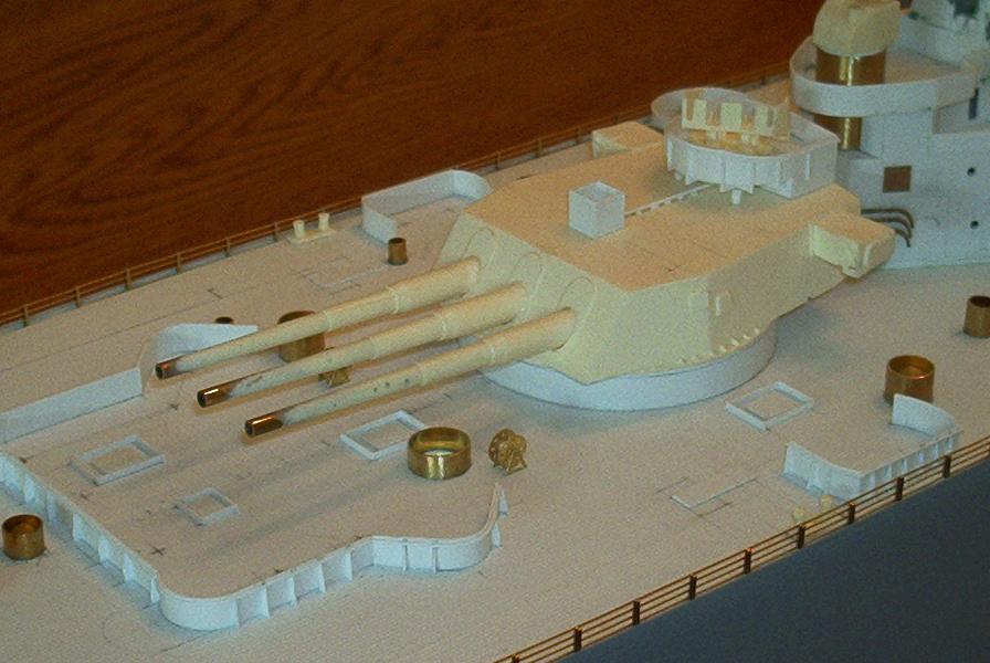

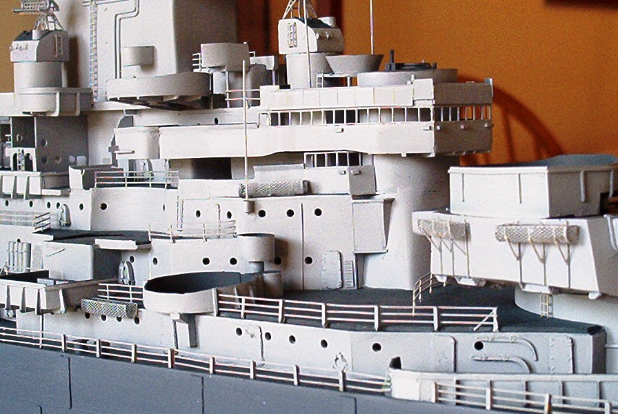

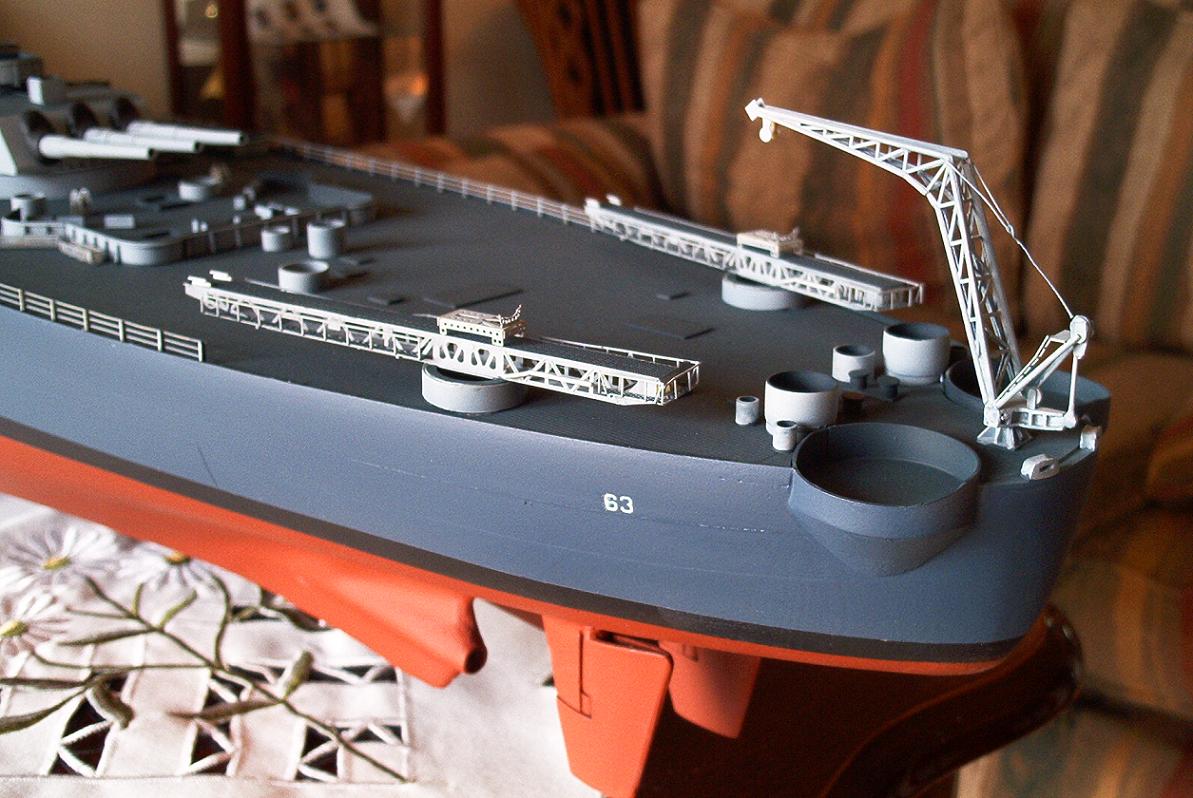

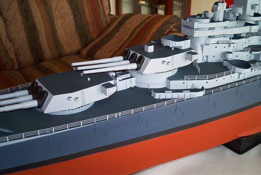

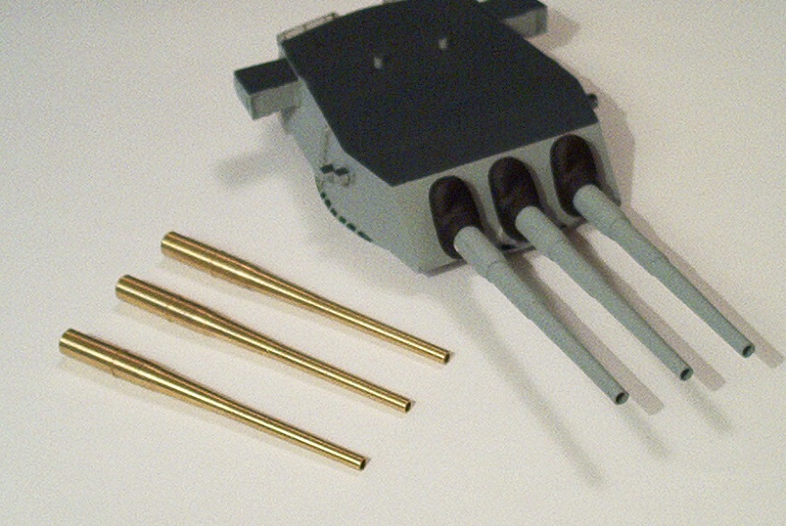

Turrets, gun mounts and painting essentially complete but before most details were installed.
The resin 16-inch barrels shown were later replaced by CNC lathe-turned brass barrels made by the late Steve Nuttall - he was a great modeler and friend and I miss him.

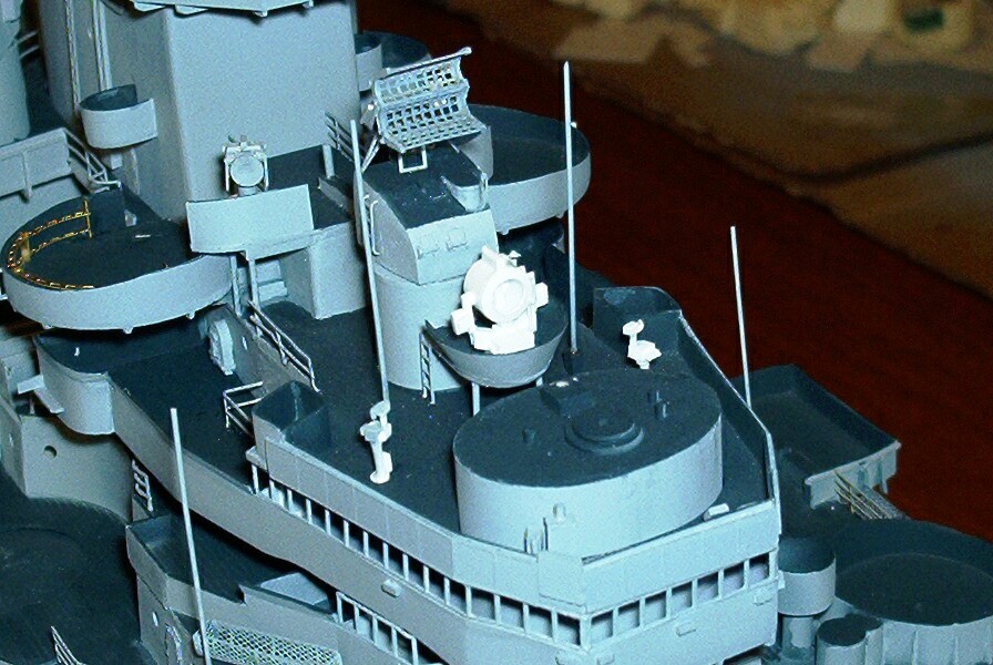

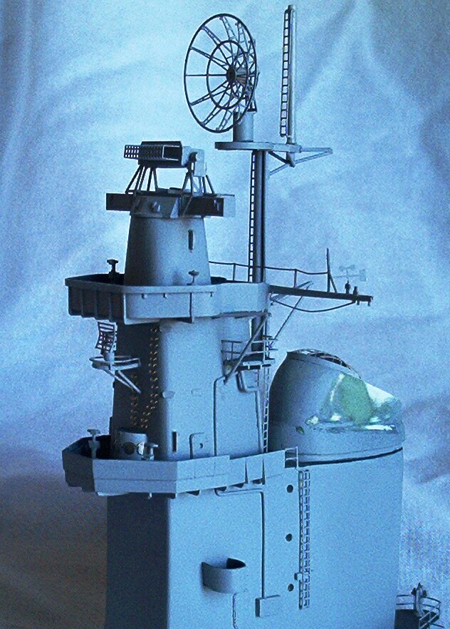

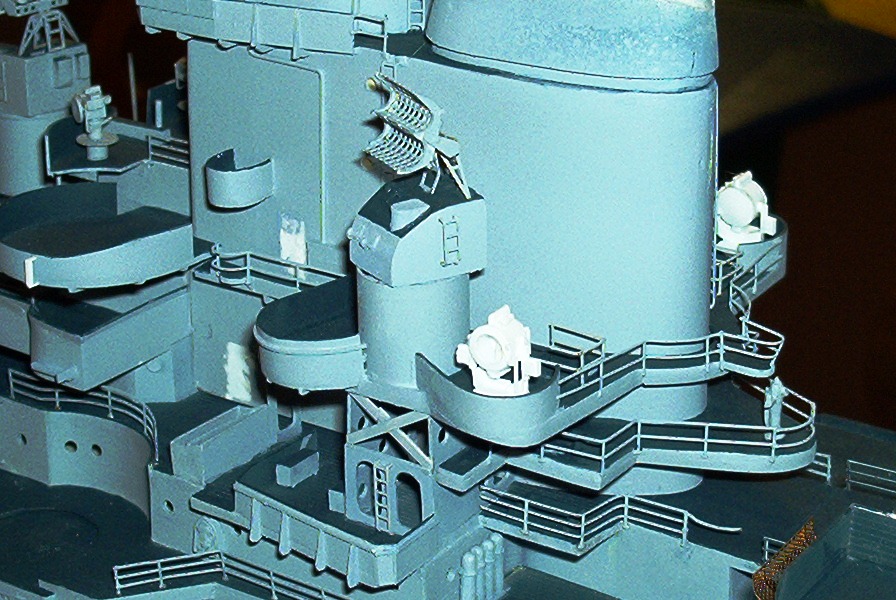

Installation of 36" Searchlights, Target Designators and other details.

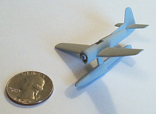

Curtis SC-1 Seahawk.

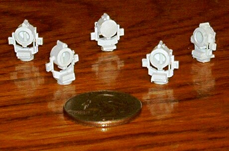

36&quot; searchlights complete with bulb.
36" searchlights complete with bulb.

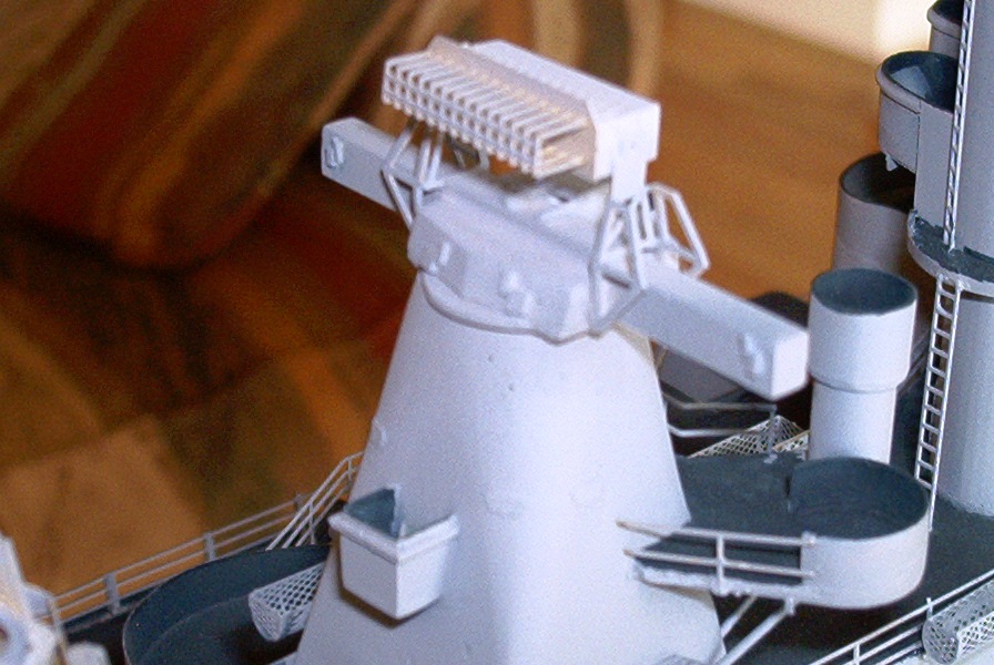

The target designators are the white objects near the armored conning tower.

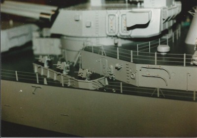

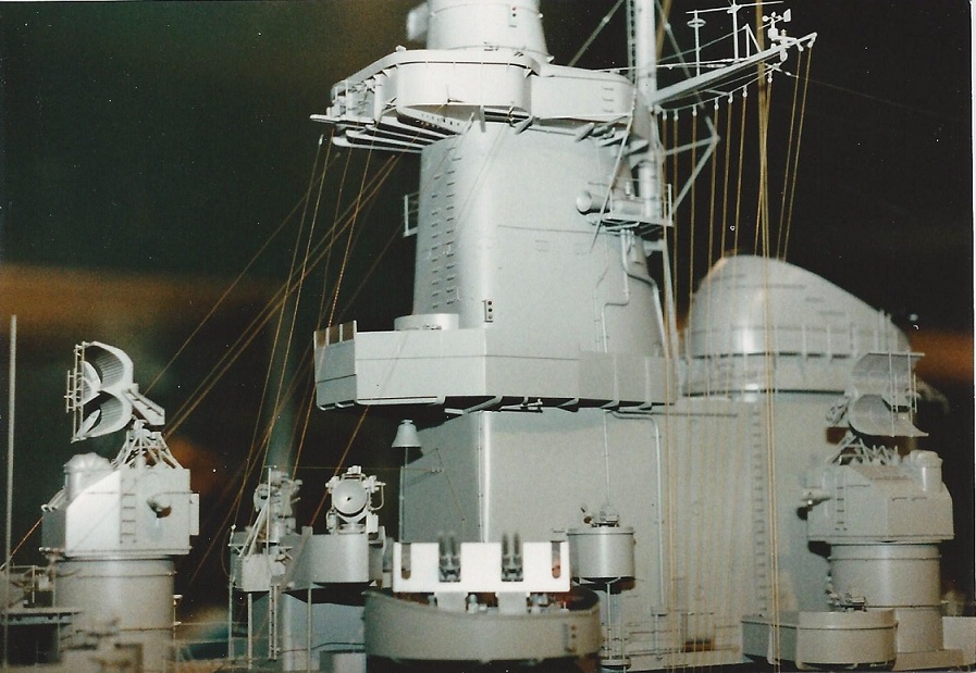

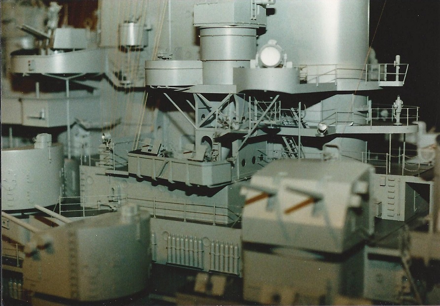

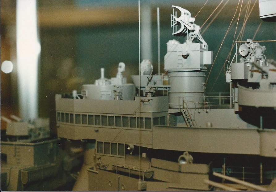

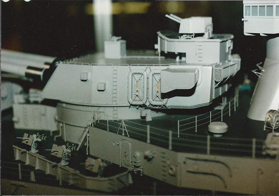

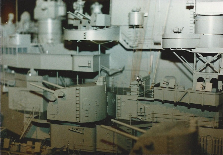

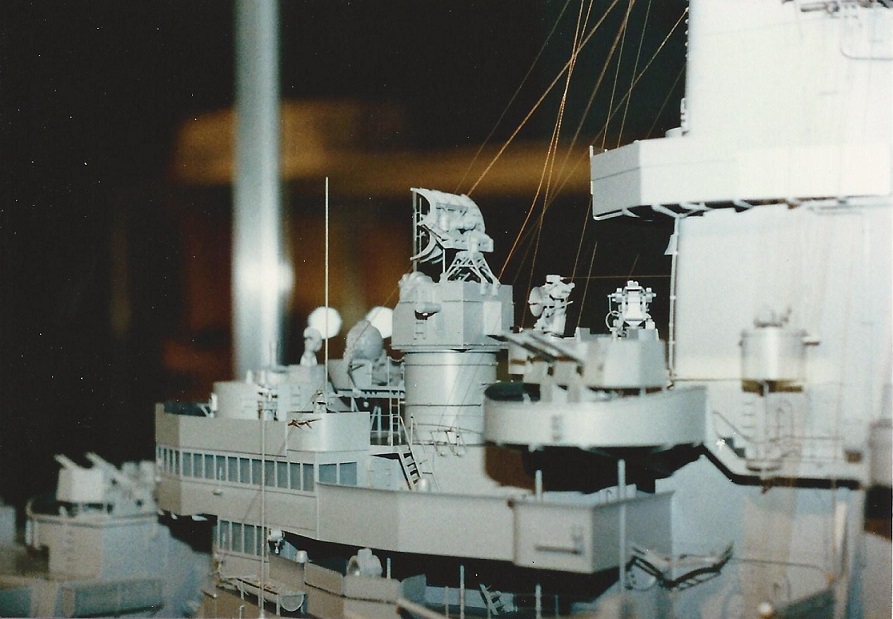

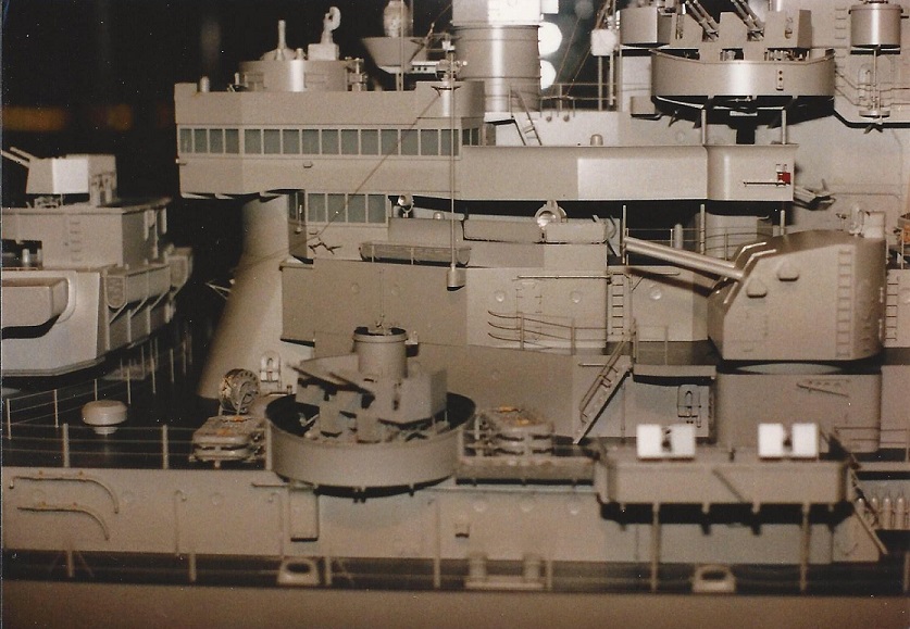

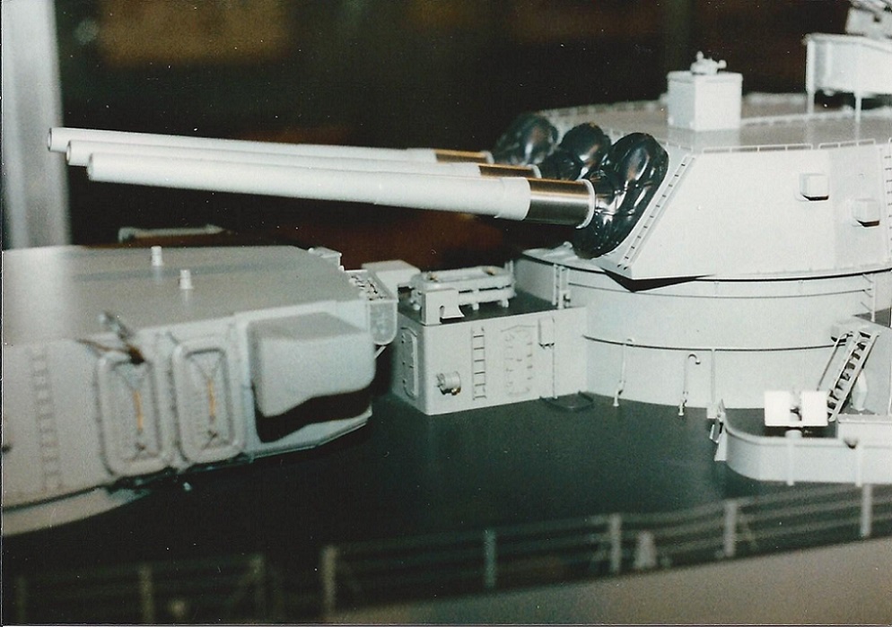

Here's where the inspiration came to build Missouri:
Here are some photos I took of the official
USS Missouri builders model as it appeared
at the Smithsonian Museum of American History
in Washington DC in 1987.
The model now rests at the Navy Museum, Washington Navy Yard
in Washington DC.
Scale: 1/48
Length: 19 feet (228 inches -or- 5.79 meters)
The model was built by Gibbs and Cox Company in New York and
delivered to the Navy on 22 January 1951. See here for more
information about the model: http://www.dt.navy.mil/cnsm/show_01.html
The detail is superb. Her paint scheme is rather unusual in that she is
Haze Gray overall with very dark gray decks and interior splinter shields.
