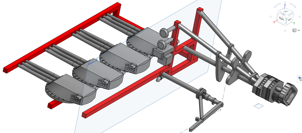

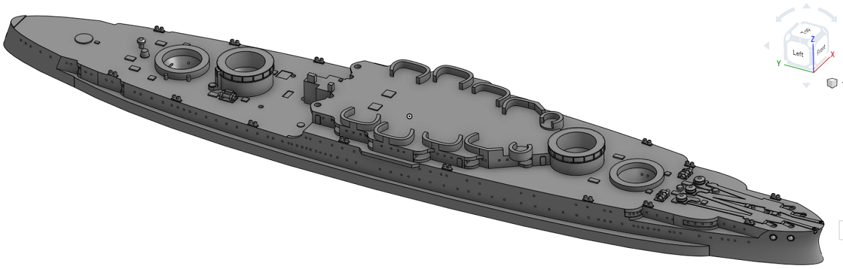

As promised here are the pictures of my progress. The hull is finished and I've already ordered 1 from the printers to help with measurements as I craft the detail set. The mast is on its side as that's how I've oriented it for printing as I build the rest of the details around it.
Michael

The rear mast is done and I'm partway through the detailing of the main guns. It took me a bit to get the geometry of the turret correct. I love the Pennsylvania classes 14" turrets, but man these were a fun challenge to figure out how to capture.
I don't have a picture, but after hitting print on the first hull I identified some shape issues that I had to go back and refine further with the CAD model.

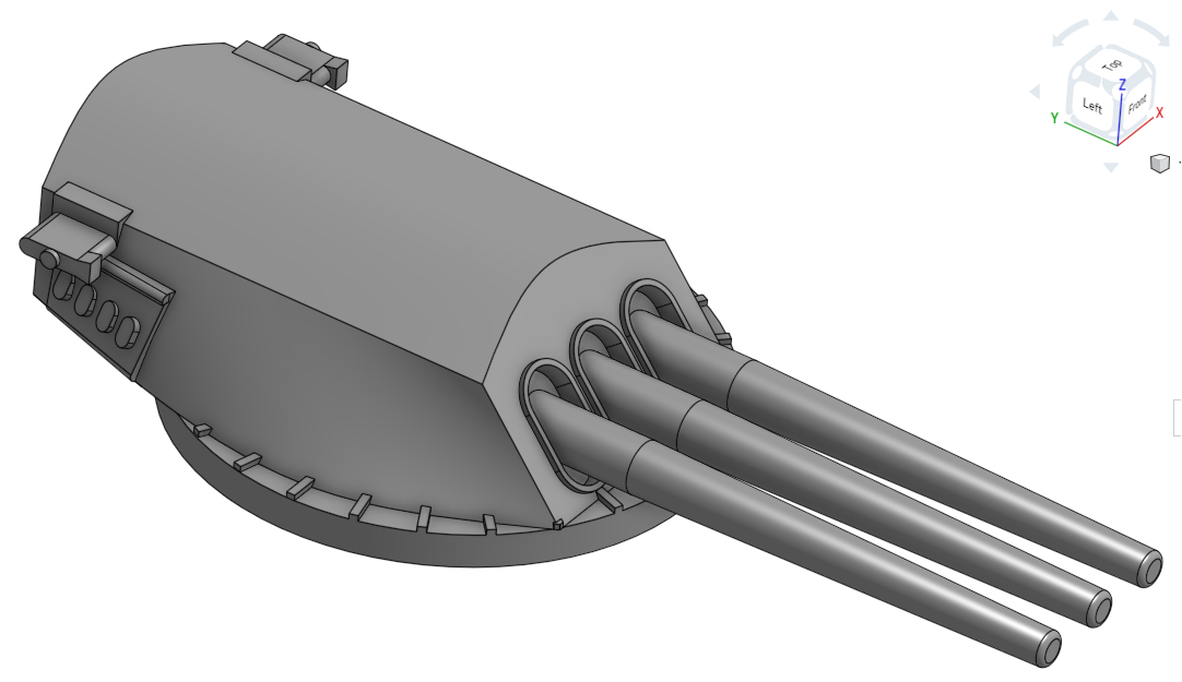

DavidP wrote:
what are those things somewhat sticking out the rear sides of the turret as don't look like rangefinder to me?
http://archive.hnsa.org/doc/guncat/cat-0541.htm

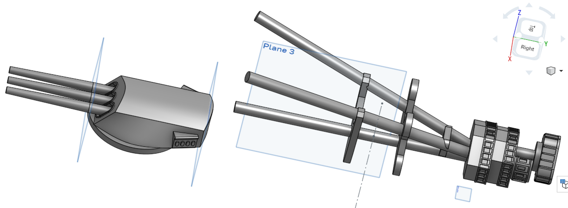

I honestly don't know what they are, just that they aren't range finders. The rangefinders are mounted above those features. The only thing I've found referencing them so far was actually a Pensylvania build thread on here; one of the differences between AZ and PA is the PA has those same features, but doesn't have the 4 access panels on them that the AZ does.
I reworked the model tonight and made that part much more accurate to the original. I'm calling these done for now, and on to the next piece...

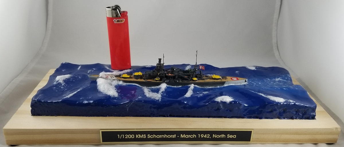

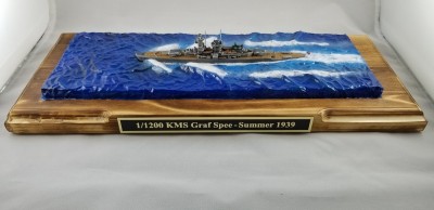

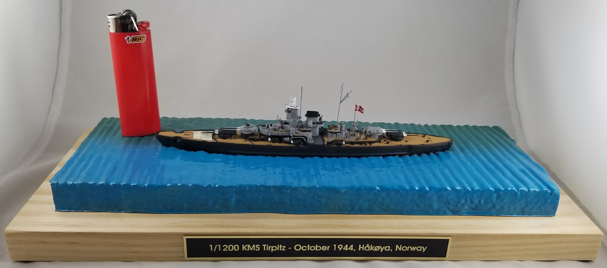

These will be printed through shapeways. I can't justify the cost of my own printer, and from what I've read about the grey acrylic, it can't get the resolution that shapeways fine detail gets. I have many features that get as fine as .1mm. I just received my first test print of the Arizona hull today and am very happy with the results. I typically just wash them with a toothbrush in dish soap, then use sanding sticks to knock down the bad areas. I've also read about using a fine soda blaster, which is on my short list of items to buy.
File comment: This is the Revell Tirpitz set. The main guns and superstructure are printed from shapeways.
File comment: This is the Revell Scharnhorst set. The superstructure and all details except guns are printed from shapeways.

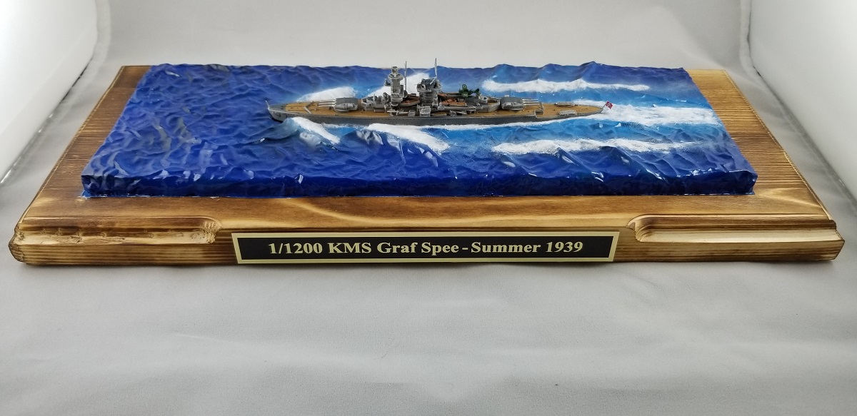

File comment: And this is Graf Spee, 100% printed from shapeways.

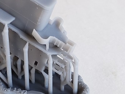

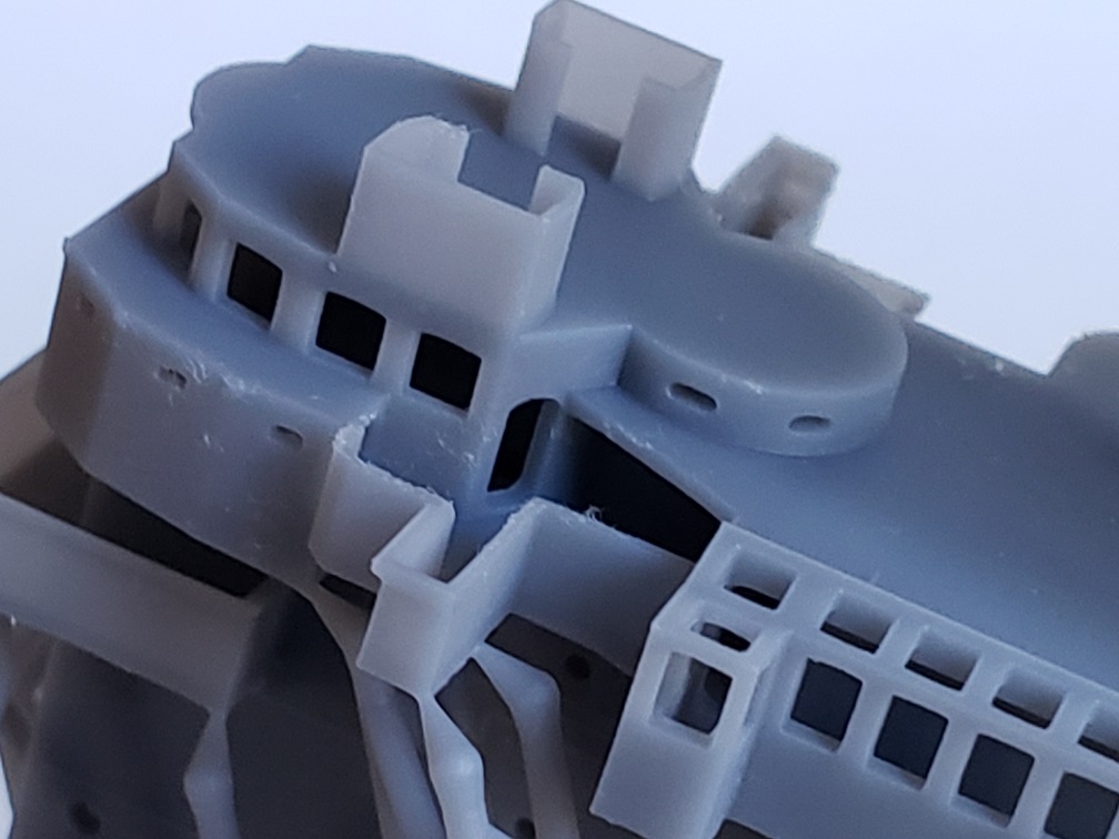

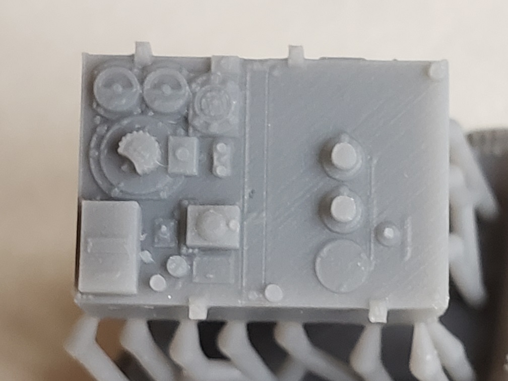

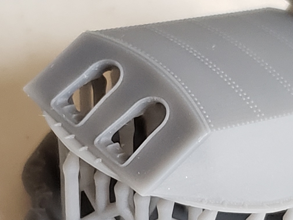

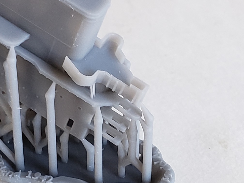

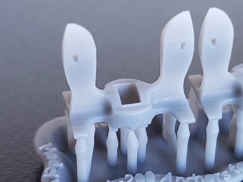

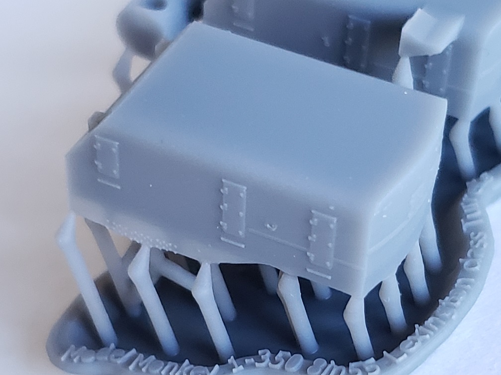

Certainly, Shapeways offers many attractive advantages. Shapeways' "smooth fine detail plastic" is a good material for many modeling purposes.
Having said that, gray resin is an alternative worth considering. Please be aware that there are different kinds of printers that use gray resin as a printing medium and all gray resin printers are not created equal. Some are excellent, professional-grade machines. Others are novelties.
In my opinion, there do exist gray resin printers that produce models that are far better than those printed by Shapeways and they are accessible to modelers.
The gray resin printer I use, a Formlabs Form 2, is based on a different technology and printing method than that used by Shapeways. I chose to purchase one and print my own designs in response to customer complaints about the smoothness of Shapeways' products using their tech. The Form 2 is a professional-grade machine best known for its use by dental professionals to create extremely accurate molds for dental work. It is not a hobby or high school printer extruding nylon.
For modelers, in many respects, the Form 2 produces superior models than the tech used by Shapeways. The Form 2 achieves greater detail and exceptionally smooth surfaces right out of the printer. There is no need for any surface smoothing using an air eraser or other baking soda blasting (effective but messy work). Gray resin also accepts more kinds of hobby paints, including enamels, without the need for post-curing by the modeler. The Form 2 is an expensive machine and so is the resin. But there are Form 2 owners and printing companies that are happy to print designs created by others for a reasonable, affordable fee. I don't offer this service but can point you to some who do. Their pricing is comparable to Shapeways.
Shapeways' "smooth fine detail plastic" printers use wax to support overhanging features during printing. Wax contact with the resin during printing causes surface roughness. Instead of wax, the Form 2 uses physical sprues to support overhanging features during printing. The sprues must be cut away by the modeler. Some modelers find the sprues objectionable and prefer Shapeways' waxy tech.

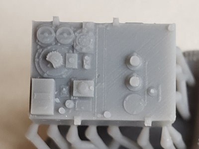

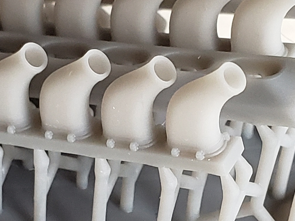

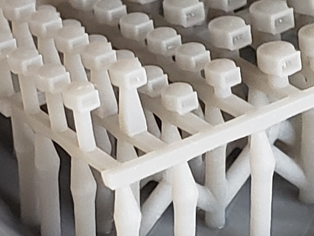

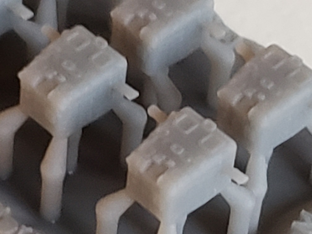

Here are some examples of gray resin models as they appear right out of the Form 2 printer in scales from 1/700 to 1/24. None of these models has been cleaned up or altered in any way. This is exactly what the printer creates and exactly what the customer receives.
Model Monkey 1-96 Mk33 Director late enclosed c.jpg [ 157.36 KiB | Viewed 2964 times ]
Model Monkey 1-200 Anchors for Fast Battleships (2) b.jpg [ 159.71 KiB | Viewed 2964 times ]
Model Monkey 1-350 Enterprise CV-6 Island 1942 h.jpg [ 147.79 KiB | Viewed 2964 times ]
Model Monkey 1-24 P-51 Mustang Exhausts with Shrouds only for Trumpeter b.jpg
Model Monkey 1-24 P-51 Mustang Exhausts with Shrouds only for Trumpeter b.jpg [ 173.45 KiB | Viewed 2964 times ]
Model Monkey 1-350 Lexington class 8in55 Turrets b.jpg [ 157.22 KiB | Viewed 2964 times ]
Model Monkey 1-350 IJN Vents Rectangular Cowl c.jpg [ 156.06 KiB | Viewed 2964 times ]
Model Monkey 1-350 Nevada and Oklahoma Turrets c.jpg [ 129.75 KiB | Viewed 2964 times ]
Have fun, Monkey around.™

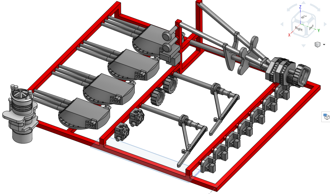

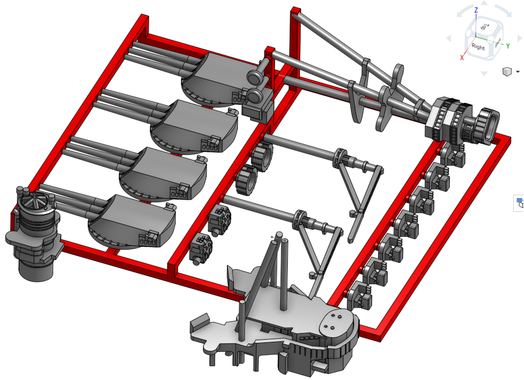

Update on my progress so far...

Oh yes, 0.1mm is no problem. The exterior cabling on this 1/700 scale USS Yorktown island is 0.05mm thick, half the 0.1mm you're looking for.
harristotle wrote:
...I think my biggest question besides who offers this service at the resolution I need is, do I have to design the supports in when I create the model or are they generated automatically as part of the print process?
Both actually. The printer's software generates the sprues. But you may want to move some around or remove some altogether in order to protect detail, etc., which the software lets you do. You can also set the size of the contact points or mix sizes. 0.6mm is default but 0.4 works fine. The software, called "PreForm", is free from Formlabs for use with their printers. You can download and install it, then see how it does for your models. https://formlabs.com/software/preform/
If you like it, you can then send Kirk the *.form file you've created for him and his folks to print for you.
I have no association with Kirk, other than as a previous customer and admirer of his capabilities.

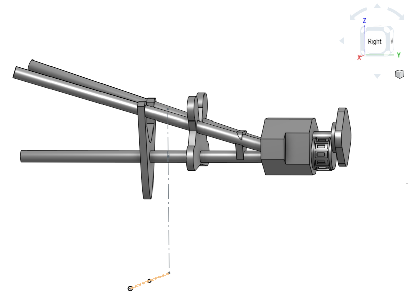

Update on my progress. Tomorrow night I'll start work on the forward mast/superstructure. Then it'll just be ships boats and a couple little features that attach to the superstructure. I'll probably create the aircraft as a separate file to keep the size of this down and allow the choice for type of aircraft.
Michael

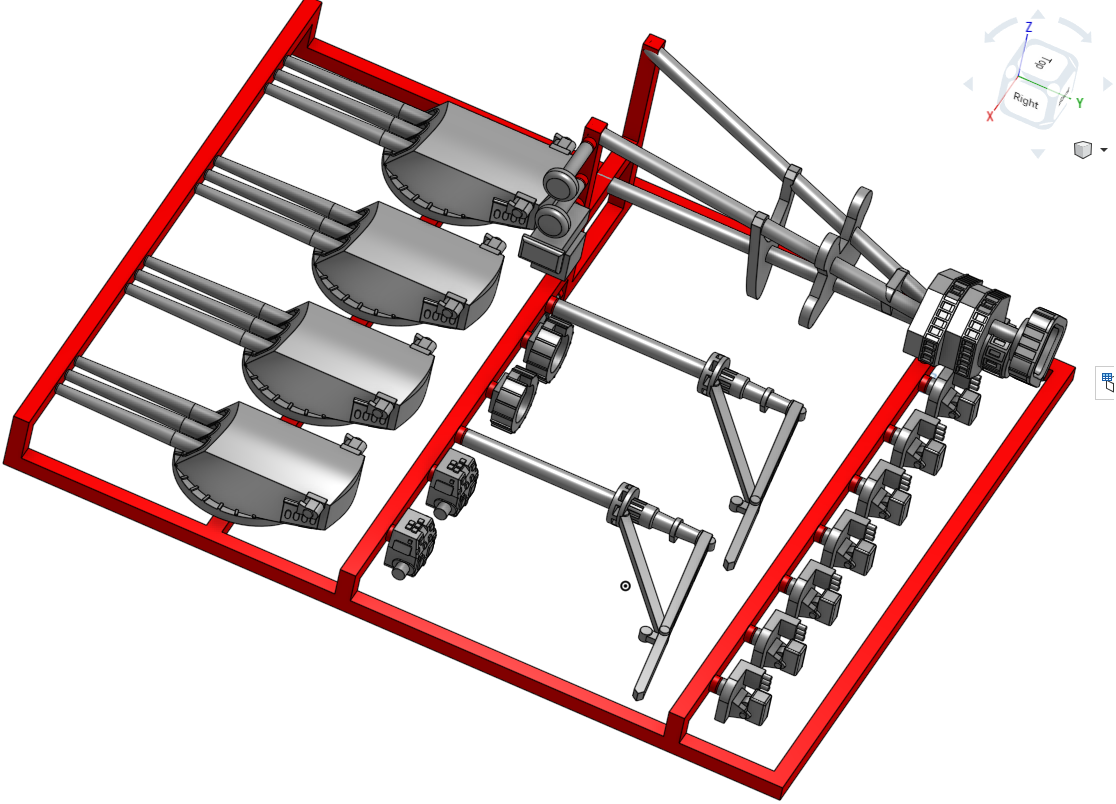

Slowly trudging along...
Michael
