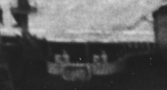

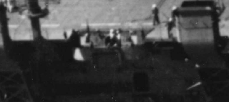

One thing I've noticed when reviewing photos and plans of the ship: the deck parking area amidships between the four funnels looks like it was extended outboard during the January 1944 refit period. The Princeton kit (and even the Princeton plans from Floating Drydock) show a cut-out in this area for the 20mm Oerlikon gallery amidships, with the gun tub at the same level as the rest of the gallery deck-level catwalks. The cut-out in the deck parking area is clearly visible in the photos taken of the ship in May, 1943 (80-G-65974):
But in 1944, you can see the deck parking area has been extended, and the 20mm gallery has been lowered. See photo NH 95650 and NH 95647:
Let me know what you think!
