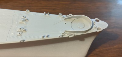

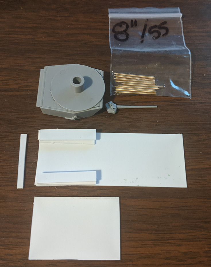

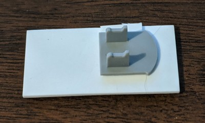

Not a lot of measurable photographic progress until tonight. I had started the barrel jig for the twin 5" mounts but found out I did it wrong. Initially I had put a strip of plastic right next to the pedestal:
I found two problems with this. First, the housing fit over the top, so I couldn't place the housing in place with the barrels on to look over and determine my preferred angle. Second, instead of resting on the the pedestal cradle, they fit tight enough into the housing itself that it was a lot better to glue there than on the pedestal and for various reasons it was still better to have a jig that had all three pieces. So, I chopped off the strip and moved it to the other side with the housing on to consistently position each mount. I got three done tonight and placed them on for a quick test:
Hull is primed (minus shafts and struts) and the main deck is on. I wasn't sure what height of pedestal I wanted to mount it on so I bought a set of half inch and full inch lamp risers and did a test look today:
File comment: Full inch
I find myself preferring the full inch height. I'm not one for towering stands but this just looks better.

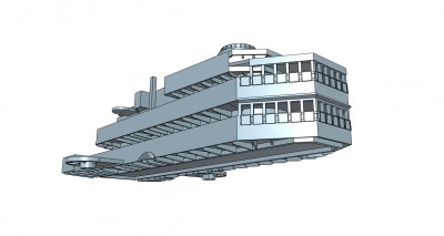

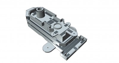

Here are two photos of your Very Fire kit's parts followed by renderings of the new 3D design. As you can see, there are some profound and conspicuous differences, most noticeably, the shape of the pilot house and the deckhouse behind it, and of course, open windows. The Very Fire kit appears to be a very good model. Hopefully, the new 3D bridge will be "icing on the cake".
The overall dimensions of the 3D model were based on scans of US Navy Booklet of General Plans (BoGP) drawings of sistership USS Newport News CA-148. The Very Fire kit's decks are a good match to BoGP longitudinally but narrower than shown in Navy plans. The 3D model's decks are a bit wider than the kit's parts, matching BoGP drawings. Note that the 3D model is not a copy of the Very Fire kit's parts, it is an original design, but the 3D parts should fit the kit very well.
Beyond pilot house and deckhouse shapes, some of the other differences between the 3D model and the Very Fire kit's parts:
- The forward portion of the Very Fire kit's uppermost deck and platform astride the director tower is incorrectly shaped, with inaccurately straight sides. The real platform was more chevron- or arrowhead-shaped, wider at the aft end. The correct shape has been captured in the 3D model.
- Photos of the actual ship show that the Very Fire kit's deck supporting beams are simplified, too small, and inaccurately placed. The real beams are larger and of three different configurations. The 3D model's beams are accurately sized and placed and are of three different configurations.
- The 3D model's deck cutouts for inclined ladders are positioned more accurately, further aft than in the Very Fire kit's parts.
- The 3D model's round, deck edge "dimple" is more accurately shaped than the kit's parts.
- The Very Fire kit's canopy above the navigating bridge windows extends too far to the rear. It should not cover the rear-most windows. The correct shape and extents have been captured in the 3D model.
- The 3D model includes pilot house vision ports, accurately tapered toward the interior, and lowered glass coverings with accurate, riveted surrounds and hinge detail. The Very Fire kit has no detailing in this area.
- The instrumentation seen on the panels in front of the 3D model's pilot house is accurate.
- The Very Fire kit's venturi has too many baffles and the venturi is not open. The 3D model accurately captures the correct number of venturi baffles and the baffles are open.
Still looking for some good references showing the interior of the lower (flag) bridge. I'm uncertain as to the details in that area.
Some of what you see in the 3D design will change. Work yet to be done includes adding doors, checking airport (porthole) locations, adding splinter shield interior detailing, detailing the antenna trunk, and adding splinter shield ribs. I'll be sure to add the door on the aft bulkhead you mentioned. The airport missing from the kit next to that door has been captured in the 3D model. The rigols ("eyebrows") above the airports should probably be removed. Photos of Salem today don't show any rigols, which would be unusual for most ships, but perhaps the ship had them in service and for some reason they were removed later.
Let me know if you can think of anything else.

Didn't get a lot of modeling time tonight but I was able to start cutting out pieces for the 8" gun jig. This one is going to be a bit different as the guns come with blast bags that are fixed in elevation, but the guns were thin enough that there are subtle bends and warps in them that many people wouldn't notice but that I see "enough" to want to fix. So, the plan in this case is to glue the barrels on, figure the height out and glue in the resting plate to keep them all at the same height, and saw off each barrel at the blast bag and replace with a brass barrel. What you see here is the resting base, some spacers, and a lower base. There will be holes drilled through the two bases and the spacers will allow me to stand off the two and not have a solid chunk to drill through or sacrifice plastic for. Thin strip to the left will be for the aft turret platform to rest against so that all three turrets are keyed precisely. The resting plate that the barrels will rest on will probably come off of the bottom base, which is longer than the spacer pieces and OK to lose some length. I may also create a piece to use to drill the holes for the brass barrels at the same height but I haven't got there yet to see how feasible this is from a work flow standpoint. If I glue it in place to drill the holes, how do I then glue in the barrels that will want to extend down below those pilot holes? I've got a couple of ideas for swapable resting plates I want to try out.
File comment: Parts!
More photos after I get it assembled, of course.
