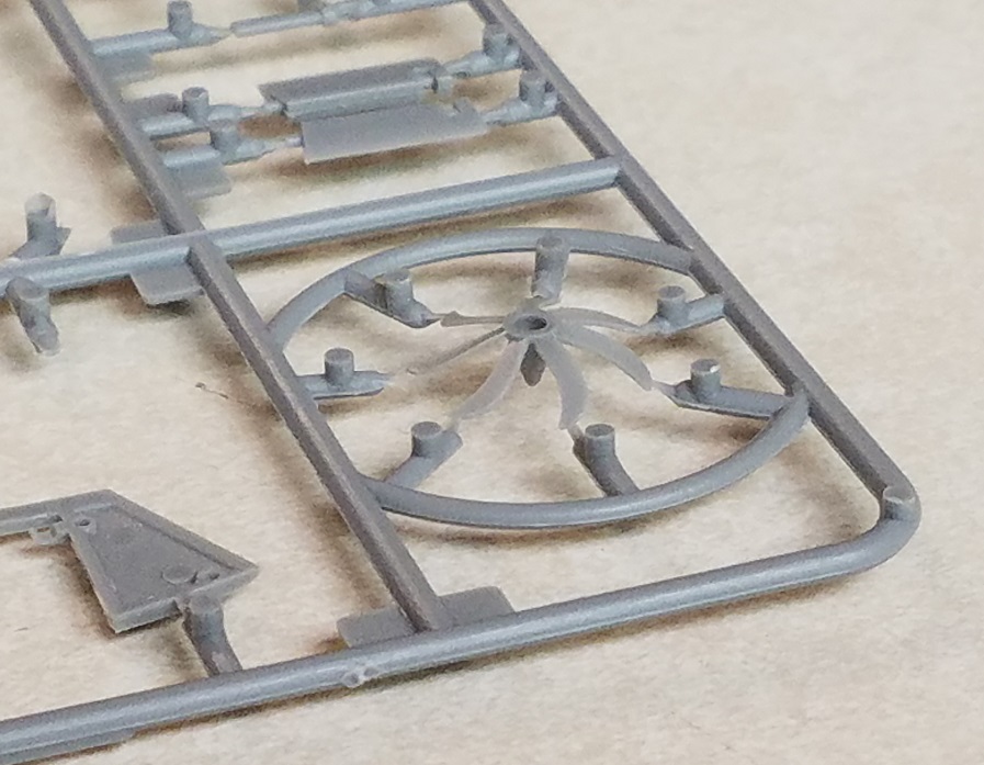

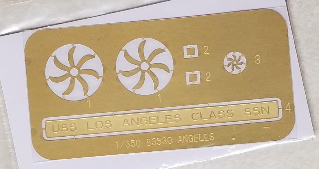

Thanks for your comments, Timmy! The kit comes with both a plastic screw and two PE screws. Let's take a look at the kit's plastic propeller.
I think you'll agree the kit's dish-shaped plastic screw won't work, even if one could fashion a ring around it. In the next photo, you'll see the kit's two brass PE screws. I don't think their profile is quite right for the ringed screw, either, but my biggest concern with these screws is that I would likely make a mess trying to construct a ring around them! :Mad_6:
File comment: I have nightmares of having these brass screws stuck to my hands with CA while fighting to construct a ring around them!
Thank you for the suggestion, Timmy. It's definitely worth considering, but I don't feel brave enough to tackle that project! I'd sure like to hear if anyone else had done that. :thanks: :thanks: :thanks:

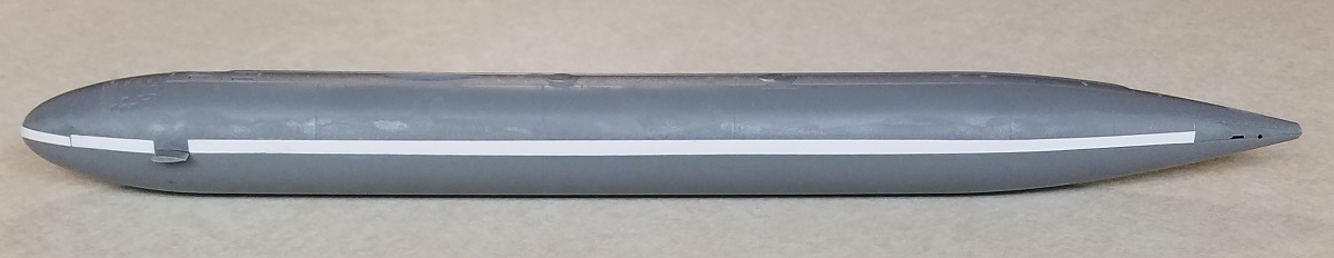

Here's where the model is today. I decided that instead of using filler, I'd cement plastic styrene strip at the seams to even out the seam between the upper and lower hulls. Here's a couple views:
File comment: I glued strips of .005 inch styrene along the uneven seams.
File comment: I hope that the plastic strip will make the mismatch between the hull halves less dramatic.
I'm going to give the hull a couple days for the glue to harden so that the styrene will be easier to sand/file.

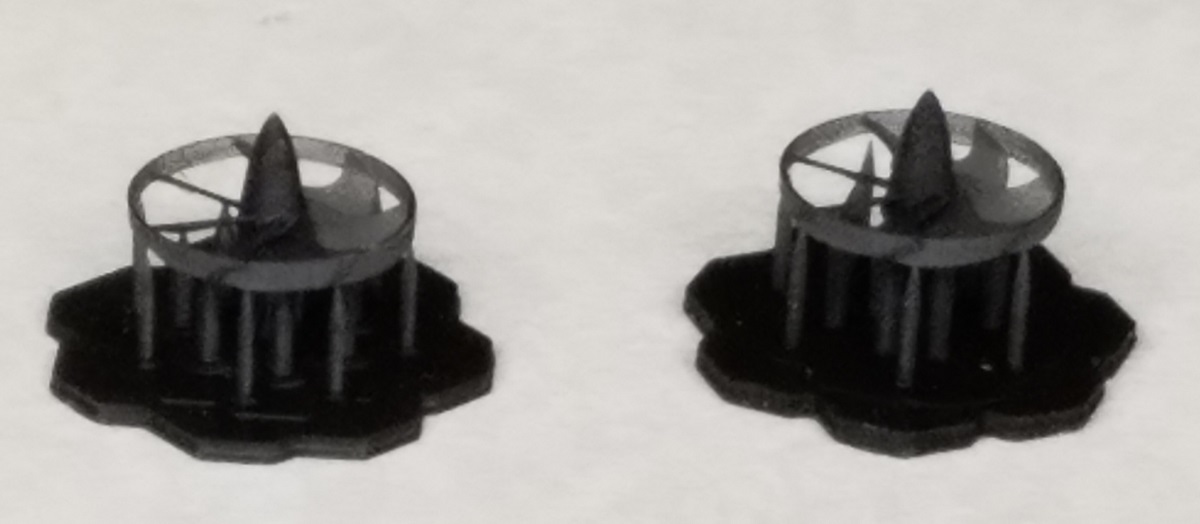

PostPosted: Mon Sep 28, 2020 8:31 pm
Joined: Mon Sep 06, 2010 9:33 pm
Posts: 413
Location: Port Orchard, Wa
Hi everyone,
A quick note of thanks to Timmy C who wrote,
Timmy C wrote:
That's fair, John, though if I were in your shoes I'd love to just try the paper option anyway (since you got the "real" versions coming by mail, there's no worry if you mess up the trial version). I'd glue one tip to the paper strip, let dry, then roll the screw so the next blade touches the paper, glue & let dry, then roll on and repeat. Simple in theory, I was I had a spare screw to try it on!

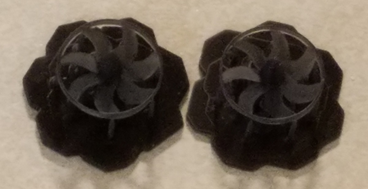

As coincidence would have it, today I received the two 3D printed resin screws. They arrived 2 days early and many days before I could've modified the kit's screws! :lol_1: Here's a look at them:

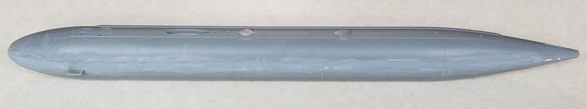

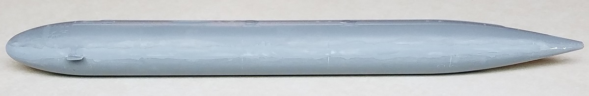

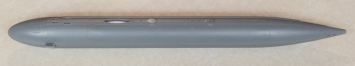

In the meantime, I've sanded the hull seams and painted them over with Light Ghost Gray to reveal defects. I'll repeat the process of sanding and painting until I get the appearance I'm looking for. Here's some photos:
File comment: The seams aren't too apparent right now, but with light at a certain angle, they show up.
File comment: I'll also have to re-do some of the hull section lines, once the seams are cleaned up.

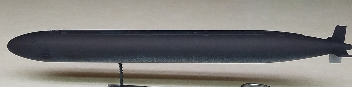

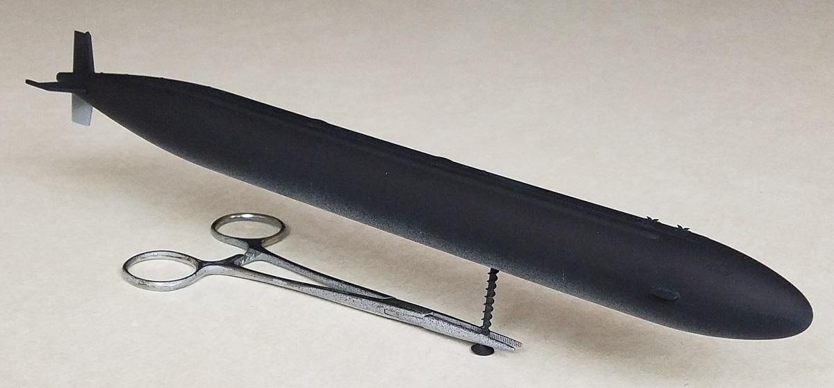

I’ve been sidetracked with several other projects, but decided to try to make some progress on this one so I can finish it up. Since I am more or less building it out of the box, it shouldn’t be as difficult to complete as the other builds I’ve posted threads on here. Here’s some photos of the latest progress.
File comment: I've painted the upper half of the model with a mix of acrylic flat black and flat blue. I'm hoping to capture the slight bluish tint actual submarines exhibit in daylight.
File comment: Next, I'll paint a homemade mixture of flat black and flat red from the waterline to approximately the mid-hull. If you look at photos of the ships in new construction, you'll see this area has a reddish tint because of anti-marine fouling paint.
