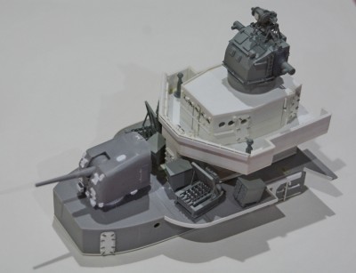

I have already completely finished the hedgehog set, with the usual three coats, a wash and a dry brush. Once set in place it fills the gap, I presume.
Along with mount nr.2 and the bridge structure, the whole lot looks cramped and cluttered, which is my distinct memory of the same place on board USS The Sullivans.
Nice going and very best regards from this side,
Willie.

Yes indeed even USN derived warships in the post war period when much equipment was removed, still ask for considerable justification for any empty deck or bulkhead space! Even a larger ship such as the APA made it into an obstacle course to do "laps". A scale weapon such as Hedgehog has a lot of parts, the individual "hogs" each has to be inclined at it's proper angle plus the supporting equipment and lockers, then there are two!
Pleased to see the sub assemblies come together!

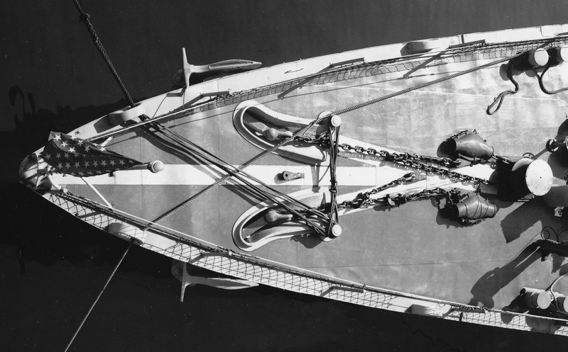

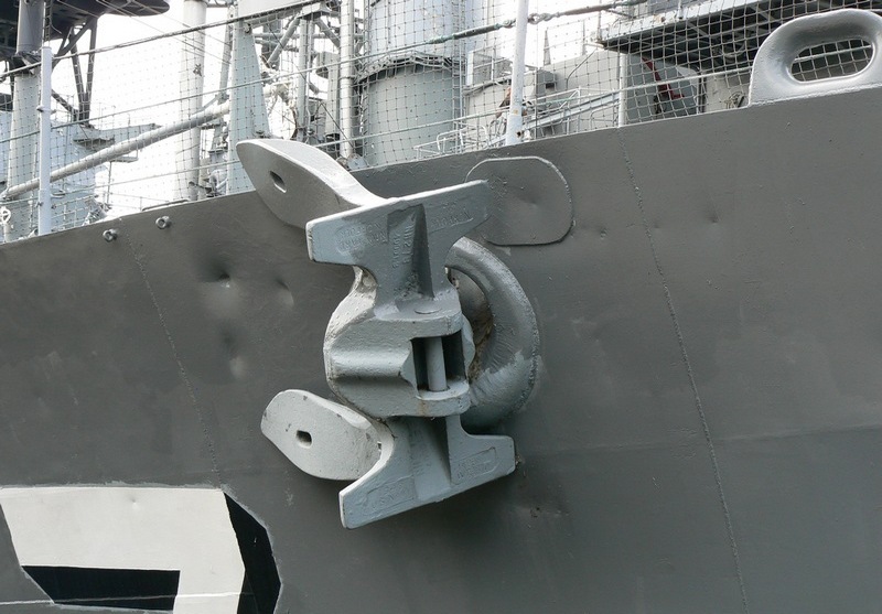

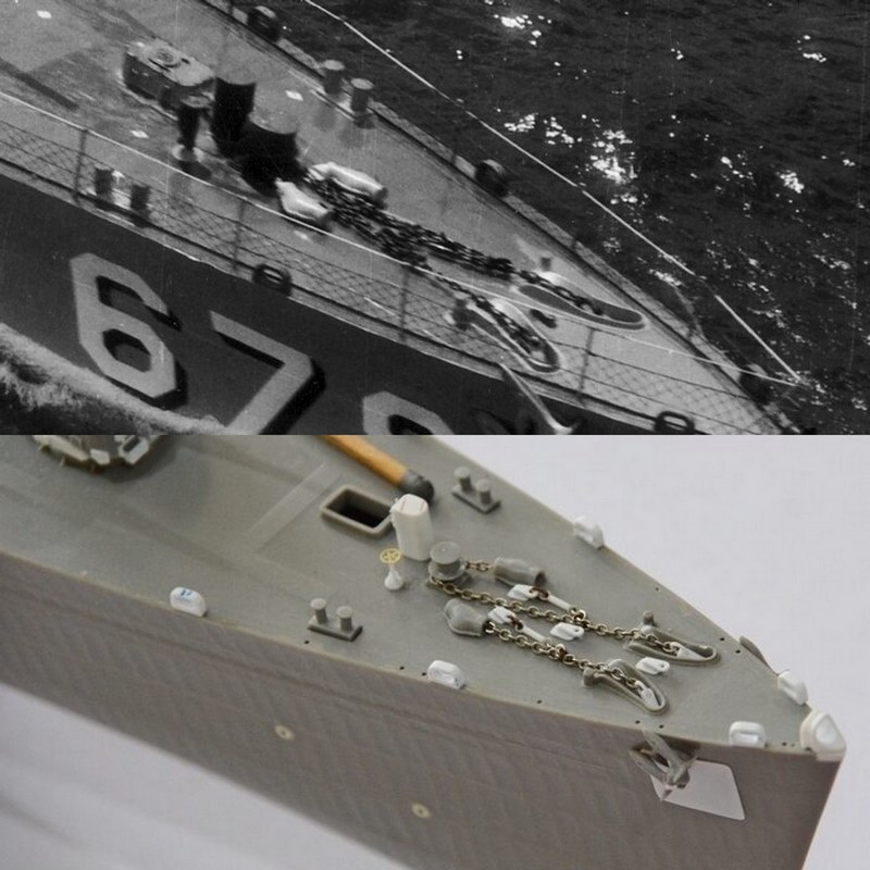

This week I had a go with the forecastle and the anchors, ship elements that I have always liked. The first thing were the anchors themselves.
I have excellent pics of US Navy stockless anchors, taken on board USS The Sullivans:

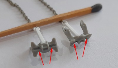

After this, I could see that the ones in the kit are good but can be improved. The flukes are OK after they have been reshaped, but the shank comes with a molded crown shackle attached to an awful looking plastic chain, so it has to be completely replaced.
The only interesting step in this first stage was to open the channel all along the shoulders, but little else. Thew shanks were carefully glued in position, so that they fit perfectly when into hawseholes. I added a crown shackle and a 10 cm. section of chain.
The anchors are set in place loosely, but they keep their position by sheer weight of the chain. The effect is good enough for me.

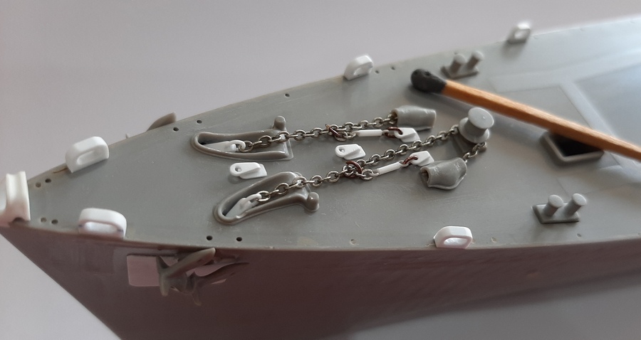

After this, the deck elements. I have no picture at all of how it was on board Jorge Juan, but I have some of other Fletchers, and all of them follow the same pattern:
The first elements were easy to build. The turnbuckles are out of scale, but I am not able to handle smaller diameter rings. I would have liked to see again the tutorial by EJFoeth in his HMS Hood thread to see how he did these elements, but the pics seem to have vanished in the air.
I completed the set with some other chain links in two diameters, and used the kit hawse covers and the winch. It is now like this:

An interesting system with a single wildcat. Letting go both anchors not a possibility unless the idea was to get rid of weight and watch the bitter end rattle overboard. Wonder how they managed this system? For my APA I carved the anchors out of basswood, for Poseidon I will attempt to 3D them. Working with a kit has advantages!
Forecastle looking quite nice! The small deck tackle adds a lot of authenticity. I remember modeling the turnbuckles on truss rods for some Ho N3 rolling sock decades ago. The ARL will have more opportunities for small rigging items!
Nice work! Tom

Very nice Willie; you've managed to really capture the look of the anchors and the forecastle in general. Looking forward to more updates.

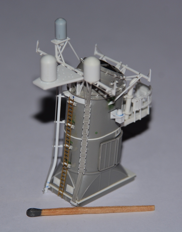

I have given another push to the rear stack, adding some more details. Firstable, the thick double wiring with two sharp curves on the left, going up from deck to the ECM domes. Apparently, as with many other elements common to all the class, there are no two ships having identical arrangements, and I have seen no clear picture of how it was on board Jorge Juan, other than it is there too. I have followed the model of USS The Sullivans, because it is common to many other units and is slightly off-side, in an ideal position to have room later to add the supports for the upper platform:
After this I tried the scale. I have one single good (but blurr) picture of how this scale was attached to the stack on Jorge Juan:
This system seems to be the common one to all Fletchers, so this solves the problem:

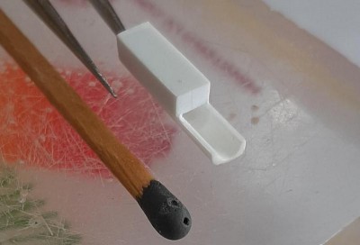

I cut the first elements from a 2.5 mm. Evergreen canal, which is exactly the width of the scale that I have.
When they are set in place with the "sides", the kind of step that follows is ideal to place the scale with absolute precision and no effort at all:
It was afterwards completed with scraps of stretched sprue.
I have also added the upper section of the wiring trunk, so the thing is at the moment like this:
I will try to finish it this week. In the meanwhile, nice going and best regards from this side of the world,

First, your stack work looks exceptional - right to your high standards!! Always enjoyable to see further work on JJ!!

The stack looks really excellent and will be a good detail hi light. Post war much clutter and complexity was removed in the way of K guns, light AA and whatnot, to be replaced by other complexity by way of electronics.

Thank you for posting the excellent photos of the anchors on Sullivans, anchors are one of the design construction tasks I am procrastinating about. It was interesting that the hull had sharp indentations from the anchor flukes, including apparently a patch? I wonder how those occurred? Anchor being flung about in a heavy sea or perhaps kissing a dock or ship coming alongside?
It is very helpful that ships of an era often had equipment in common so your solutions may indeed be of help to the rest of us.

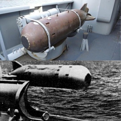

(...) The introduction of the Mk 2 ASW Torpedo launching system (TLS) (using the Mk 4 launcher as seen on USS CASSIN YOUNG) for launching "over the side" the Mk 32 torpedoes (more like a self-propelled depth charge) were installed on many destroyers. Also, there were the PMGL system installed on PacFlt FLETCHER's. The PMGL (Poor Man's Gravity Launcher :big_grin: ) was a fantail drop rail device designed by a yard crew in Japan when the PacFlt was frustrated that they had Mk 32 torpedoes, but that it would take like two years to get the Mk 2 TLS installed on all their destroyers. The Mk 4 launchers were installed in multiple locations on destroyers. The PMGL system was installed mostly parallel to the starboard side 600-lb depth charge drop track and the reload rack was moved forward of the drop track. However, a few destroyers had the PMGL installed on the portside!!
Mr. Davis, I presume you are talking of this, the Mk.32 ASW TLS on board USS Cassin Young:
I had no idea what it was, but now the thing is clear, so thanks a lot for the precious information. I will have to see if my ship had this thing on board or not in the mid. 1960´s. What I have not been able to trace is the PMGL. Have you got any picture showing this ???

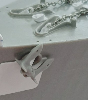

I asume that with such thin plates as destroyers had, indentations from the anchors were (had to be, actually) a common place. I can remember that my ship had a severe dent ahead of the bow anchor, but from the anchor of the CVL Dédalo, (ex USS Cabot), received while getting into port in Rota at too high speed, macho style, crashing into Dedalo´s bow and actually breaking her anchor chain, after what the anchor fell off the hawse hole, and had to be recovered by divers. I don´t know if anybody suffered after this kiss: the officers in my ship did not, as far as I know, and our commander at the time finished his career as VA, so I asume he did not either. You have to break the eggs to make an omelette, was probably the philosophy behind it.

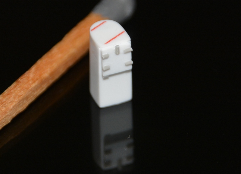

Something I forgot in the previous post. USS McGowan, later Jorge Juan, had a device just behind the capstan, that I am not able to identify:

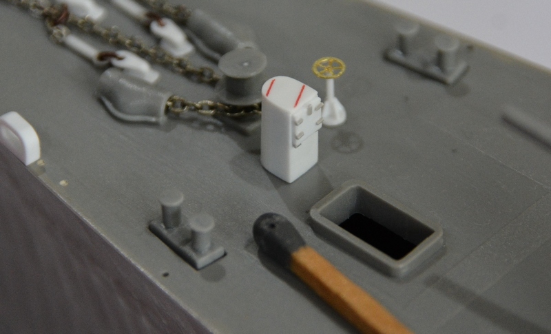

Once the thing was clear, to build it was nothing at all. I made a base with Evergreen 4.00 mm. tube and 4.00 mm. stripe, and then refined it with cover, door and hinges.
I also made the handwheel by its side, using a PE and Evergreen scraps:
The effect is excellent, and with this I can consider the f´castle set as complete. Of course handrails will be added at the end of the construction.

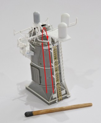

Other than this, I realized some days ago that the vertical wiring trunk on the rear stack is off-side on board USS The Sullivans, but virtually centerline on Jorge Juan. This picture shows in a somehow blurr way where it actually was, but shows clearly where it was not.
Obviously I had to delete all the previous work, and re-do the bloody thing. This has happened to me so many times with this ship that I have the impression that I have virtually built two ships instead of one. At the same time, I have almost made a master at coarse language and rough words in four different languages --no mean feat.
The good thing is that --as it is now ca. 4.0 mm closer to the center-- the wiring can be taken straight to the deck, the way it actually was on board USS The Sullivans, and the most logical one, I presume.
When compared with the older way, it looks now much better as well, I would say.

And a new question for all of you guys. What are the holes on the anchor flukes for ? I have been researching the subject in the internet, but I have found nothing reg. this subject.
As far as I can remember I have seen them only in US Navy anchors, but I could be wrong.
TIA for your time and help, and very best regards from this side,
Willie.
