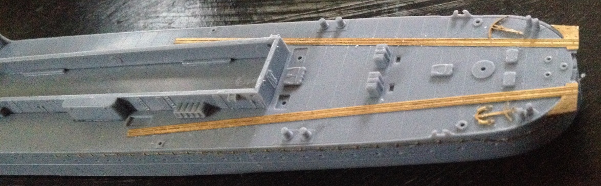

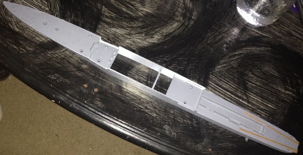

So far I have water lined the kit, removed the molded on anchors on the fantail and replaced with PE, tracks on the fantail and replaced with PE, the wave break which will be replaced eventually, and the degaussing cable which I have started to replace with PE. All parts you see here are glued together.
File comment: The work is started on the degaussing cable and the PE replacement of molded on detail has begun.

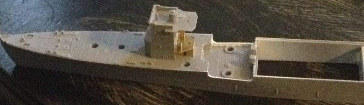

I have started some of the other sub assemblies. This is all bridge work.
File comment: Bridge, O1 and O2 weather decks that will attach to the back of the bridge.

File comment: Test fitting the bridge and the O1
File comment: wide shot of the above

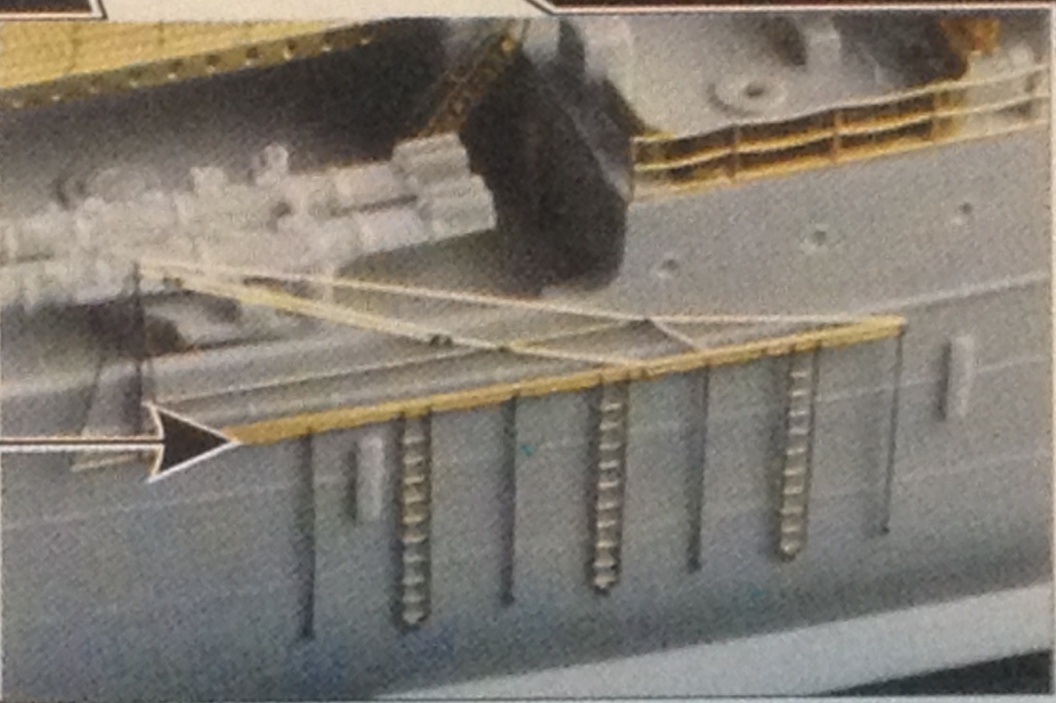

One thing I noticed on the Flyhawk set is the arms that extend off the sides of the ship for receiving people from small boats/launches. At least that is what I think they are. The position of them is right next to the forward torpedo launchers. This seems wrong given they would be in the way of the launchers. Anyone know where these are supposed to go?

This is the part I am talking about. I cannot find any decent pictures of the class that you might see this PE piece. Again it looks like it is right in front of the torpedo launcher. The photo is from Flyhawk's instructions.
Any advise is appreciated!!

In some of the pictures, the part in question (are they called pilot ladders?) are shown, but not so much detail, sorry... I think the PE part should be lower, judging by the photos, even though it would still be on the way of the torpedo tubes. Maybe the aft "structure" is not properly represented.

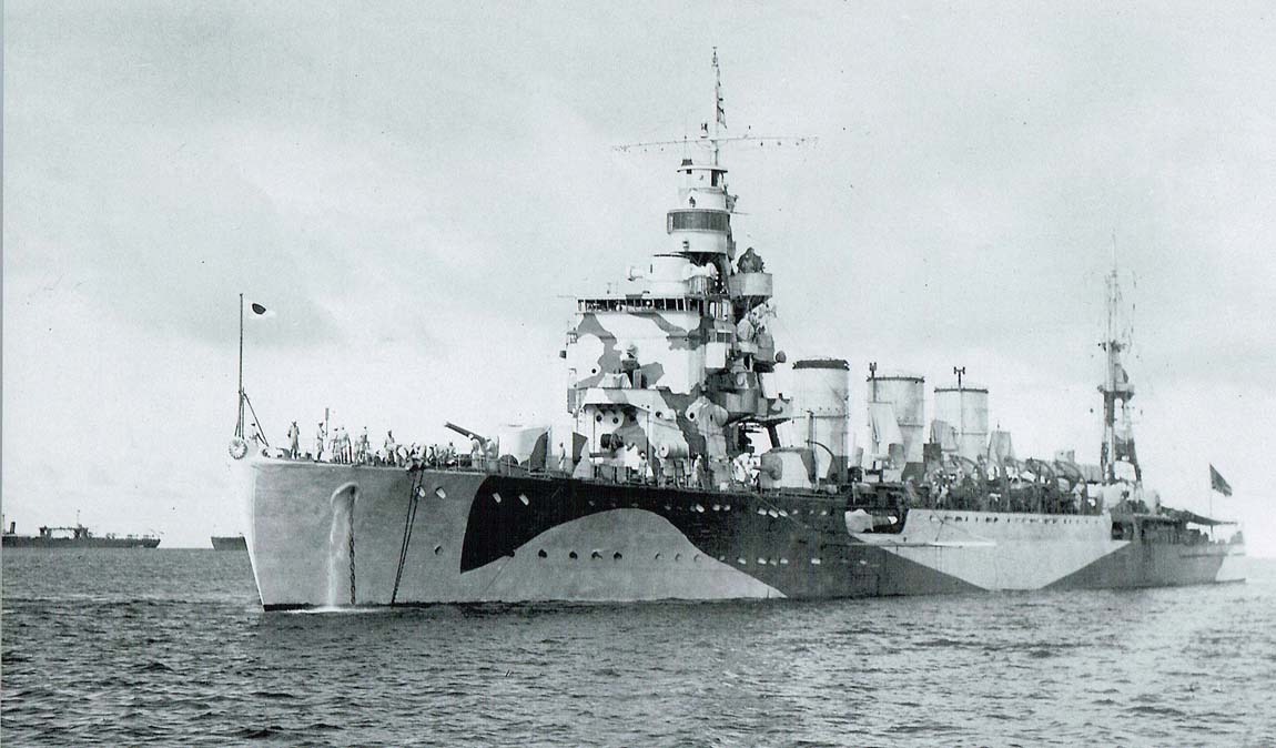

Those are boat booms and yes, they were positioned under the forward TT bay. I'm not so sure about it being supported by a collapsible davit.
Here is a rarely seen Yura 1940, with boat booms extended, also Kuma

Thanks Dan. Those pictures show the booms are connected more forward than the Flyhawk instructions position them.
When the ship is underway the booms have the ladders retracted I am assuming?
