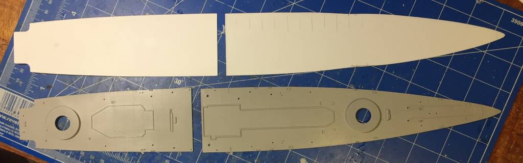

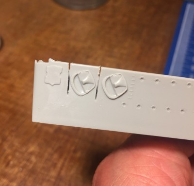

The first major alteration took place at the decks. Because the Graf Spee had a different breakwater-anchor chain configuration and because of the widening of the forecastle deck during reconstruction I decided to replace all the deck parts with ones made from Plastruct and Evergreen plastic sheet.
First it seemed easy to use the original ones as templates but it turned out that Trumpeter made the deck pieces so that the line between them is visible (black arrow) although there's a part of the superstructure that could have hidden it (red arrow)
So my parts are bit different in lengths and the foremost piece is a bit longer and wider
The quarterdeck is in place:

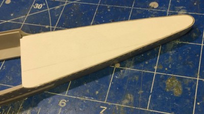

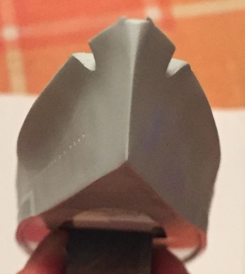

The atlantic bow is almost ready it tokk a great deal of puttying and sanding.
But first the new wooden deck was cut from evegreen plate:
Next it was attached atop the hull then the cutwater was put in place with the skeleton of the widened complex-shaped upper part:

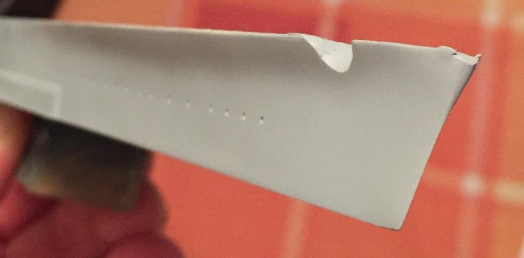

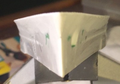

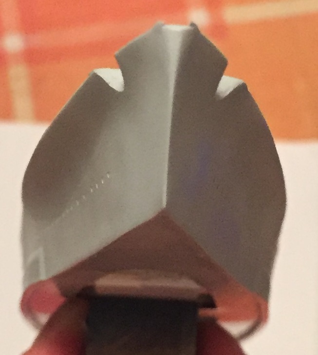

Then it was covered with epoxy putty:

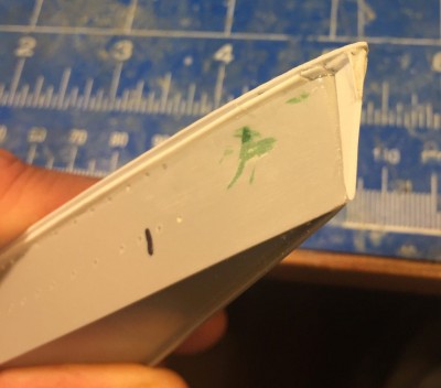

which at first seemed pretty crude but some sanding really did the job and the new cut-outs for the anchors could be created as well:

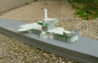

First I converted the base of the forward superstructure which was very different from Spee's (altough the kit part was inaccurate for that vessel too), then top of the turmmast was cut down:

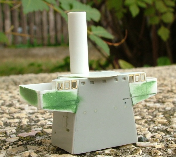

Next step was to build a new bridge platform, a shelter with windows and then I installed the Lutzow-style tubular mast:

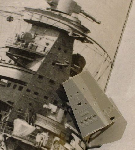

The conning tower and its surroundings also gave a fair amount of work to do. The deck around fore two thirds of it is higher than the deck behind so I raised it (red arrow)
Accordingly the base part had to be tailored to this (black arrow) The windows of the armoured tower were too numerous too large and at a wrong height (red arrows) so magic sculp was used to fill them then I cut out the correct ones.
I had to remove the base of the rangefinder and replace it with a scratchbuilt one (black arrow) as it was near the rear edge of the tower not at the middle as Trumpeter imagined it. The periscope bases were made from plastic discs and through all of these maneuvers there was the funny task of preserving the rivets (blue arrow)

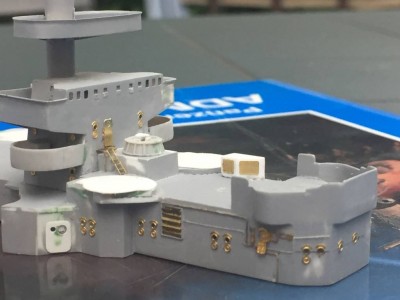

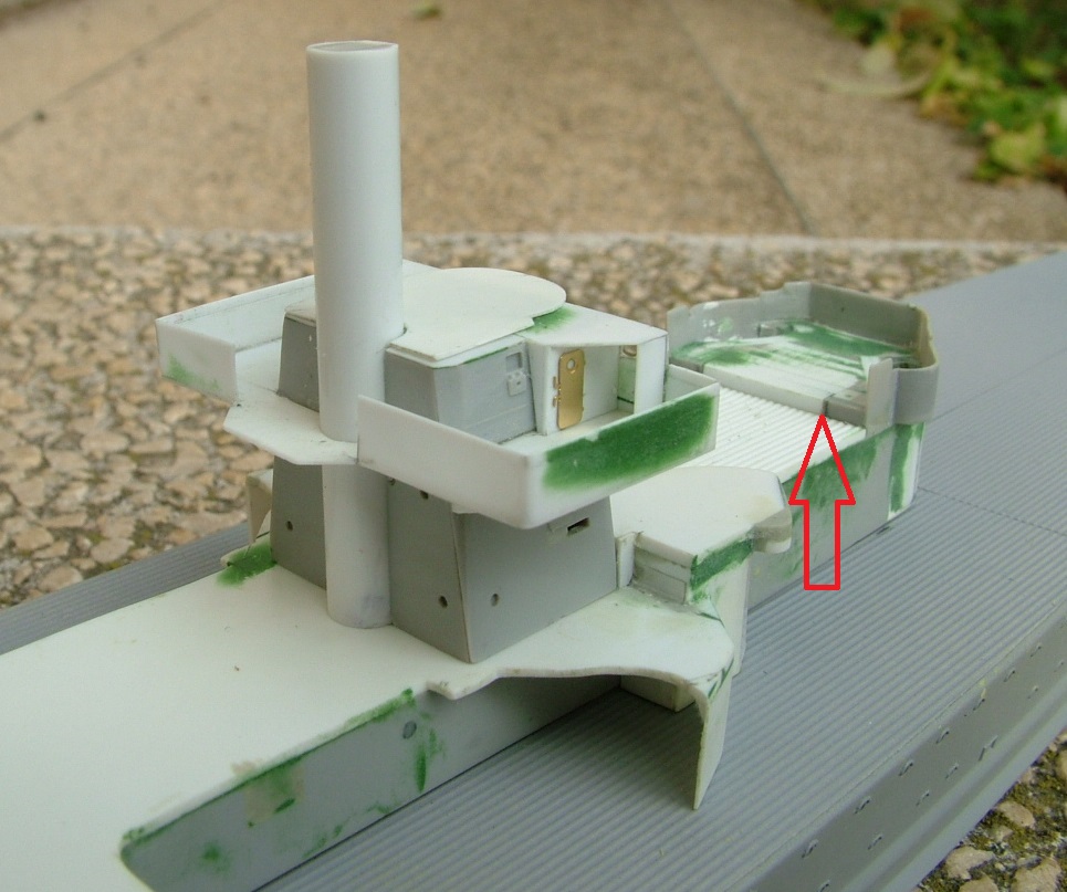

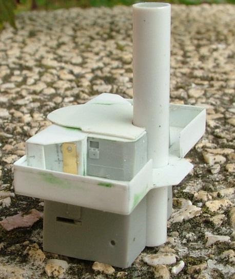

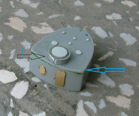

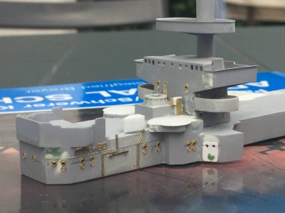

Here are some new details of the superstructure, mostly PE for windows and doors. But the pipes on the sides had to be scratchbuilt.
Of course the window on the white door on the starboard side needs some correction... :big_grin:

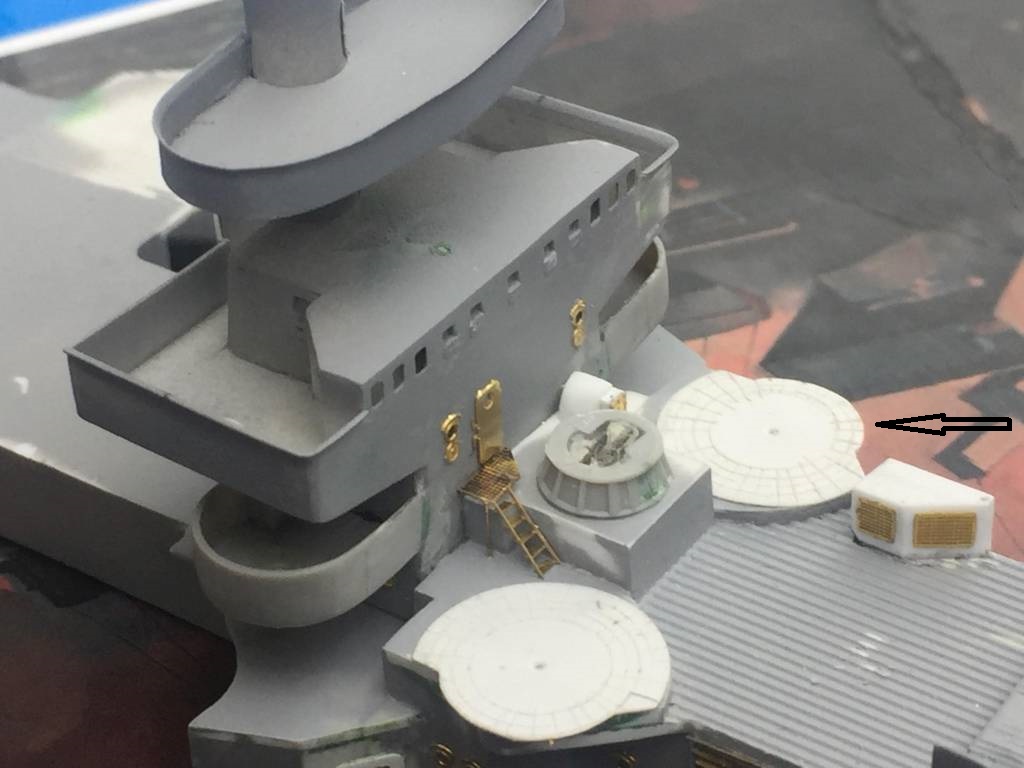

The 37mm gun platform (arrow) was a funny part, because it has some anti-skid surface and no photoetch could be found... so scriber tools solved the problem. The peculiar shape didn't make it any easier.
