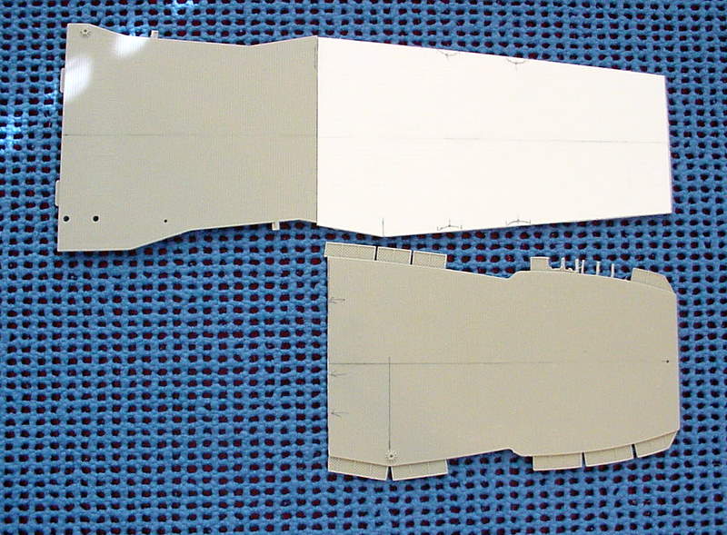

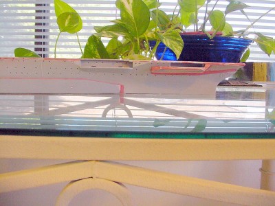

Converting the Trumpeter 1/350 CV-2 to a 1944 CV-3 has been on my to do list for a while. Finally started chopping, this post will show the hull roughed out (it can be argued the my finished builds are "roughed out" but we all build to the limits of our patience and ability). The Saratoga will be built as she looked at Iwo Jima, in measure 21.
I had good references, 1/192 plans of 1945 CV-3 from Floating Drydock and the Classic Warship Pictorial #11 - Lexington class carriers. The book has a set of very good pictures of Saratoga after her "dazzle" refit and she was 99%+ in this physical fit at Iwo.
Overall, I was very pleased with the Trumpeter kit, one BIG reservation being the FLIMSINESS of the hull. the plastic is way too thin and the flight deck locators are way too SMALL. The waterline hull was also bowed up in the middle by 1/8". The solution to the bow and in order to add heft, a wood stiffener was glued/screwed to the hull cross braces.
Hull work included lowering the hull (to match the FDD waterline) by cutting away the waterline plate flange to the level of the two foreward and aft reinforcing ribs, lengthening the forward sponson, removing detail at the 5"-25 locations (to convert to 5"-38 and quad 40mm), filling in the lowest level of portholes (again to match both plans and photos) and adding the large, asymmetric starboard blister. The blister deserved a photo of its own, it was carved as a single curved and twisted piece. The FDD plans do not have hull stations but luckily Friedman's carrier book had a Saratoga cross section with a dimension on the drawing (The blister is 6 feet at the top shelf, which is .21" in 1/350)
One final, editorial, comment. As I worked on the hull I was taken in by the "beauty" of this ship. I say this as many builds progress on line of Akagi, her contemporary (they were both laid down as WWI battlecrusiers and completed post WWI as carriers) which I appreciate as a historic ship and would build in an instant if I was doing IJN but after all these kind words still strikes me as an "ugly" ship.

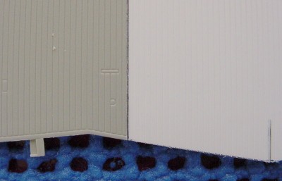

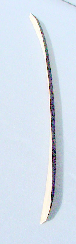

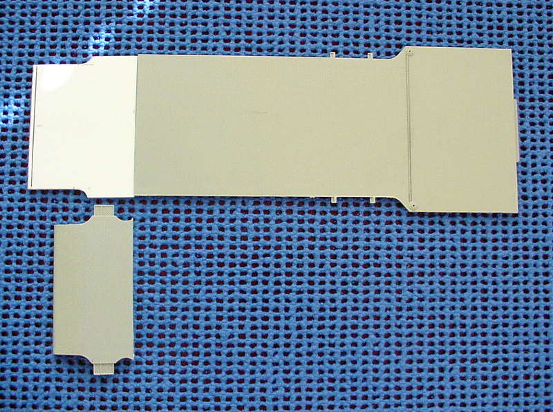

Modifying the flight deck turned out to be easier than I had any right to expect, the Trumpeter plank spacing was appx .039" and I bought some Evergreen .040 scribed sheet that was a very good match. Did NOT have to skin the entire deck.
As the pics show the flight deck bow and stern had to be modified for CV-3. The stern of CV-3 had the big ramp eliminated and was longer, while the bow section was slightly wider forward and had straight sides. Most of the midships area was identical (thankfully) between CV-2 and CV-3. The close up shows the match between Trumpeter and Evergreen.

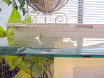

Have made LOTS of parts, some shown in first photo.
The second photo shows a test of the flight deck edge, made from black vinyl (electricians) tape. The tape is .006" thick and cuts with a very good edge. This photo also shows a test of my safety net construction. The frame is a staple and the net is the hem edging I mentioned previously. Comments pro or con accepted.
I do have a question to ask, The hull is just about done and it is a filthy mess. There is Bondo dust, styrene chips, sawdust and general grime everywhere! I am thinking about blowing off with the airbrush (unfilled) at 80 psi, followed by making some "tack rags" from an old t-shirt wet with mineral spirits. Any better ideas?

Roberto, The FDD plans are no help on hull shape, there are good photos of the overhang from underneath in the CW book listed in the top post.
Matt, There is a lot of "fine stuff" that is over scale. The net has a .030" opening which converts to 10 inches, the staple frame is .018' which is 6 inches in diameter! I am firmly in the "impressionistic" or "representational" school.....if it looks OK from 1 to 2 feet I am a happy camper.
Some photos of the hull before priming and a shot of how an "impressionist" dolls up aztec stairs.

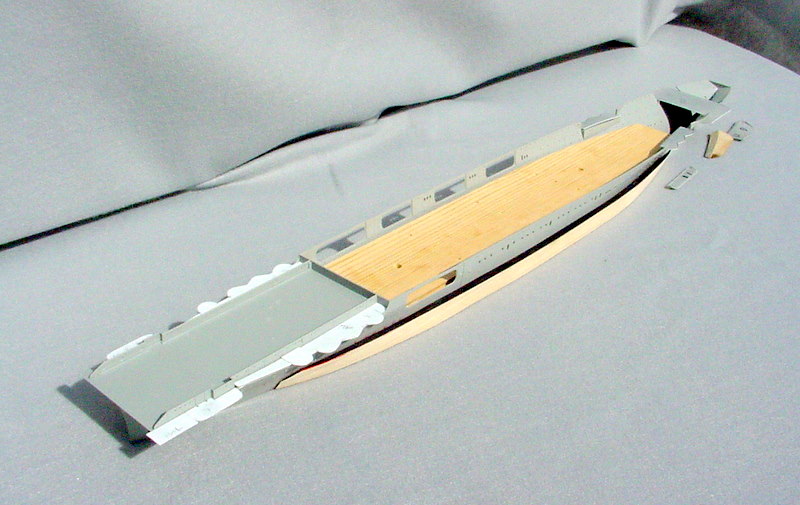

While I was working on 23!! quad 40mm's, I read that Tom Harrison was seriously ill, and now he has passed. The white metal bases for the quad 40's were purchased from Tom a long time ago. 90% of the PE that will be on this ship was from Tom. I will miss him, my ships will miss him.
The hull is finally DONE! I am happy with the results so far, and that is not always the case. Two shots of the ship in general and a close up of the safety nets. I found some PE that was 4 1/4" squares in a row. This made a very good frame. The netting is the material I discussed earlier.
This is my first build with Crafters Pick "The Ultimate" (supposedly identical to "Gator Glue") and I very pleased with the stuff. Used it for "structural" joints on unprimed styrene and it did very well.
