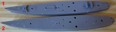

First I removed everything from the deck (1: before 2: after removing deck details).

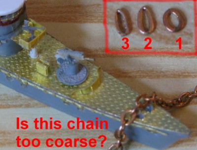

Continuing with the bow area the question arises if a real chain can be used. Here in the picture a chain from an old Heller 1/400 Bismarck kit is obviously too coarse. But the chain is still of use: In Subchaser07 “1” marks one link, “2” another one after tensile deformation of the whole chain, “3” with additional grinding.

On IJN DDs, I use the scale chain from the PE sets, either GMM or Lionroar. Those are scaled correctly and look good. Real chain is not small enough.

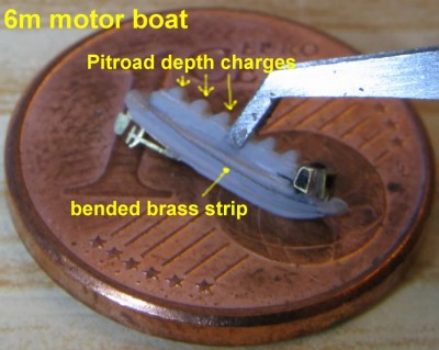

Lion Roar made a mistake here: The guns are only deep etched from one side. Therefore, they should be mirrored. This is not the case. If you want to assemble both with the etched side out one has to be upside down with the magazine pointing down. I fixed this partially.
Depth charge magazine is from Lion Roar, depth charge thrower from Flyhawk and depth charges from Voyager.

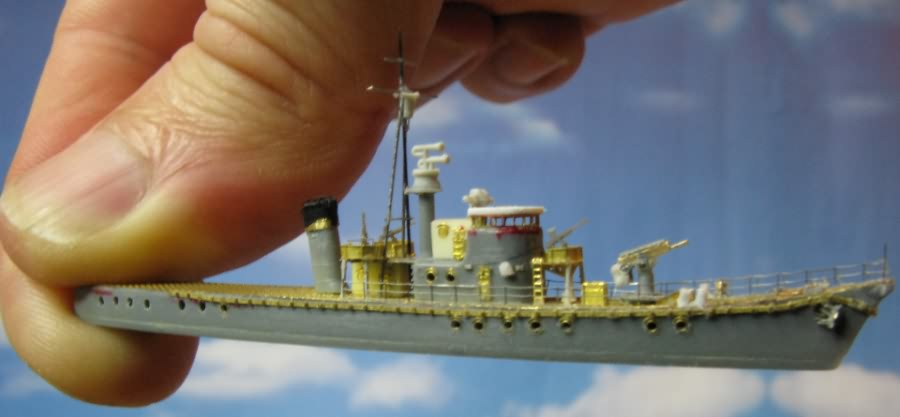

Last pictures before I start airbrushing:
