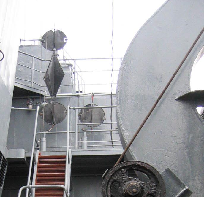

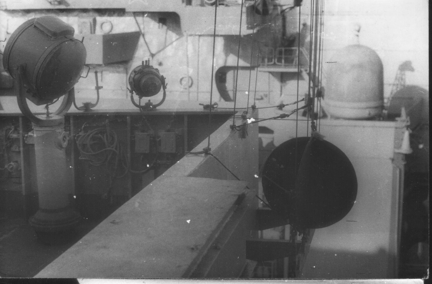

Regarding the bridge wings:
http://balancer.ru/forum/punbb/attachme ... item=89160
http://balancer.ru/forum/punbb/attachme ... item=89182
Looks like a |_|_|_|_|_| shaped thing attached to the lower edge of the outside of the bulkhead, upon which that perpendicular circle is placed.
PostPosted: Sun Jan 24, 2010 6:00 am
Posts: 2432
That circle is a daymark used for navigation. When you are at anchor you have to mount such a "ball" ,because it's in fact one circle and another perpendicular on that one to form a sort of ball shape, on the best visible place. I bet they mount it on both sides of the bridge, because they don't have place that is visible all around to mount it.
Such a ball is also part of the restricted manoeuvrability marks of a ship. Often when they are doing helo operations, they are mounting a ball, a diamond and a ball on one line on top of each other to show that they can't manoeuvre too easily due to their operations.
On regular ships these balls are kept somewhere inside and only attached to a lanyard when necessary. Russian ships however seem to have them in fixed places, ready at all times for use. So technically this "circle" is attached to the two ends of one line. Pulling one end will get the ball up, sliding up, pulling the other end of the line gets it back down.
Here is a picture of the same line-up with both restricted manoeuvrability and anchor balls attached (on an udaloy)
They are attached to both sides of a line to avoid it turning around in the wind (which we have a lot in the merchant) and getting tangled up!

And just for you, Mick - reuploaded onto here:

At night these daymarks are exchanged for lights (although nowadays these lights are just kept on all the time). The ball becomes an Anchor light (all round visible light, posted forward). The restricted manoeuvrability (two balls with a diamond in between) is exchanged for two Red lights with a white light in between. Should be all around visible, that's why on warships occasionally you'll see multiple lights on different places. That's necessary when you have a cluttered ship, where you cannot mount a light that can be seen all around. Mounting it on one side of the mast, if the mast is big, will have it invisible from the other side of the mast.
Most obvious is the lights mounted on the Zeven Provicien class of air warfare frigates of the Dutch Navy, they have the lights on the four corners of their phased array mast.
There is another sign, two balls during the day, or two red lights during the night that indicates "not under command", engine failures, loss of rudder/steering gear. That is why you can occasionally see additional red lights mounted.

Yes, these are part of the international ColRegs. Everybody has to follow these. There's a lot more of it as you can imagine, but the things I explained are the most common. In those colregs there are also rules regarding aircraft carriers and minesweeper/hunters etc. To make sure everybody knows what's happening and how to react on it. Some Navies however think they are above the rules and don't give way when they should... Slightly annoying :big_grin: Same counts for most container ships, they always think that they are king of the sea because they are in a hurry...
The black ball and the ball-diamond-ball are the most commonly used for them, so I guess they have them stand-by most of the time.
