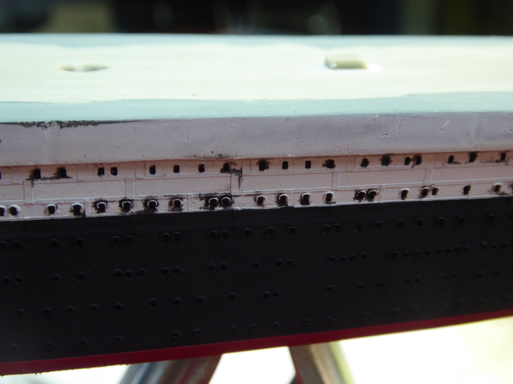

my last update on this 24 June... arghhh!--
well in mitigation we actually had an almost hot summer, classic cars and holidays et al caused
a bit of a squeeze on model ship time...
but there has been " some " progress
but ....alas not much in truth... :scratch:
BUT...
I have now completed ALL the eyebrows =
= about 1100 or more all told -with the round and square topped variants.
and add some much needed texture to the models otherwise very bland hull surface.
In oblique angled photos of the real ship they are distinctly visible
and a distinctive relief feature
Of course on the model it is all pretty overscale-
especially when viewed very close up... :Mad_6:
but looking at the model as a sum total--it does -in my view work
Placing the eyebrows in the black area I found that simply seeing the square topped ones to align-- pretty hard--
so gave them a light airbrush dusting of white to assist alignment.
I could no longer procrastinate... especially as all the superstructure sub assemblies are already made and mostly completed...
so applied the 'anti-fouling'-- using the very slight stepline of my added strip around the bottom..
.( remember ? ==> now 10 months ago !!! ) on page 2

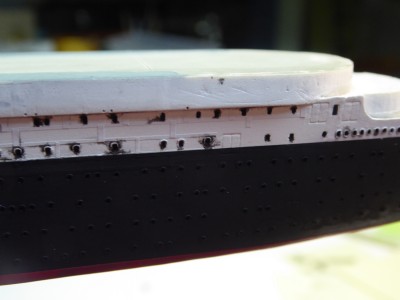

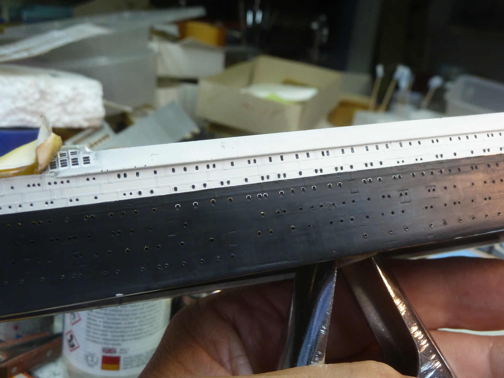

RotRing pen Ink... I have been using it for years in RotRing pens for blacking portholes etc...
great stuff great pen...
only to find that I mixed up my Rotring permanent ink bottle on the latest refill for an elderly bottle of non-permanent RotRing ink
So after spraying the hull with my Winsor and Newton Artists water-based matt varnish to seal the matt black paint etc on the hull...
This is what a really crap afternoons work looks like... :censored_2: :censored_2: :mad_2: :Mad_5: :Mad_6:
images below
so now ...a glass of red and an early night....
to try and win back the energy, strength and the will to live try and rescue it .....
Good night
JB
Pieter
Posts: 1623
Post by Pieter »
If it is Rotring non-permanent ink some careful work with distilled water and cotton swabs should be able to cure it.
marijn van gils
Posts: 2770
Post by marijn van gils »
Aaaaarg!!!!! Not fun!
I hope it is not ingrained in the cured varnish, and you can clean it of (leaving a nice pin-wash maybe :) ).
Otherwise, some white paint will solve the problem.
But not fun...
JIM BAUMANN
Posts: 5728
Post by JIM BAUMANN »
>>>> @ marijinn .....==> I hope it is not ingrained in the cured varnish, <<<<
It is... and has settled nicely into the white enamel.
I have been scraping and paring minute shavings for the last 3 days with a variety of scalpels--
as white painted over-- the black ink still bled through and made a shade of grey...
I usually never count hours , but it is well over 15 hours so far.. ( arghh! )
One side is ok and rescued to an acceptable level....
-the other is still wok in progress....
Pinwash indeed ... hah hahah ! :big_grin:

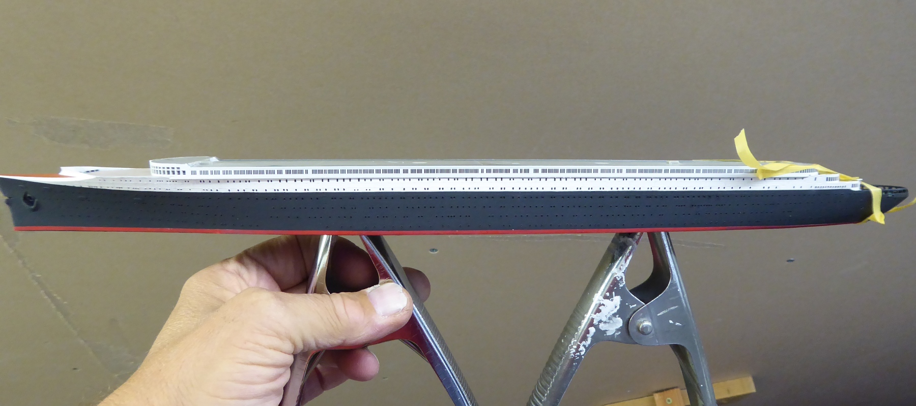

Thank you all for your positive comments and sympathies - and advice--on and off this thread!
I have mostly now rescued the windows to stage it was at before
I was unable to put it off for any longer....
almost 1 year later (!! )
procrastination over--

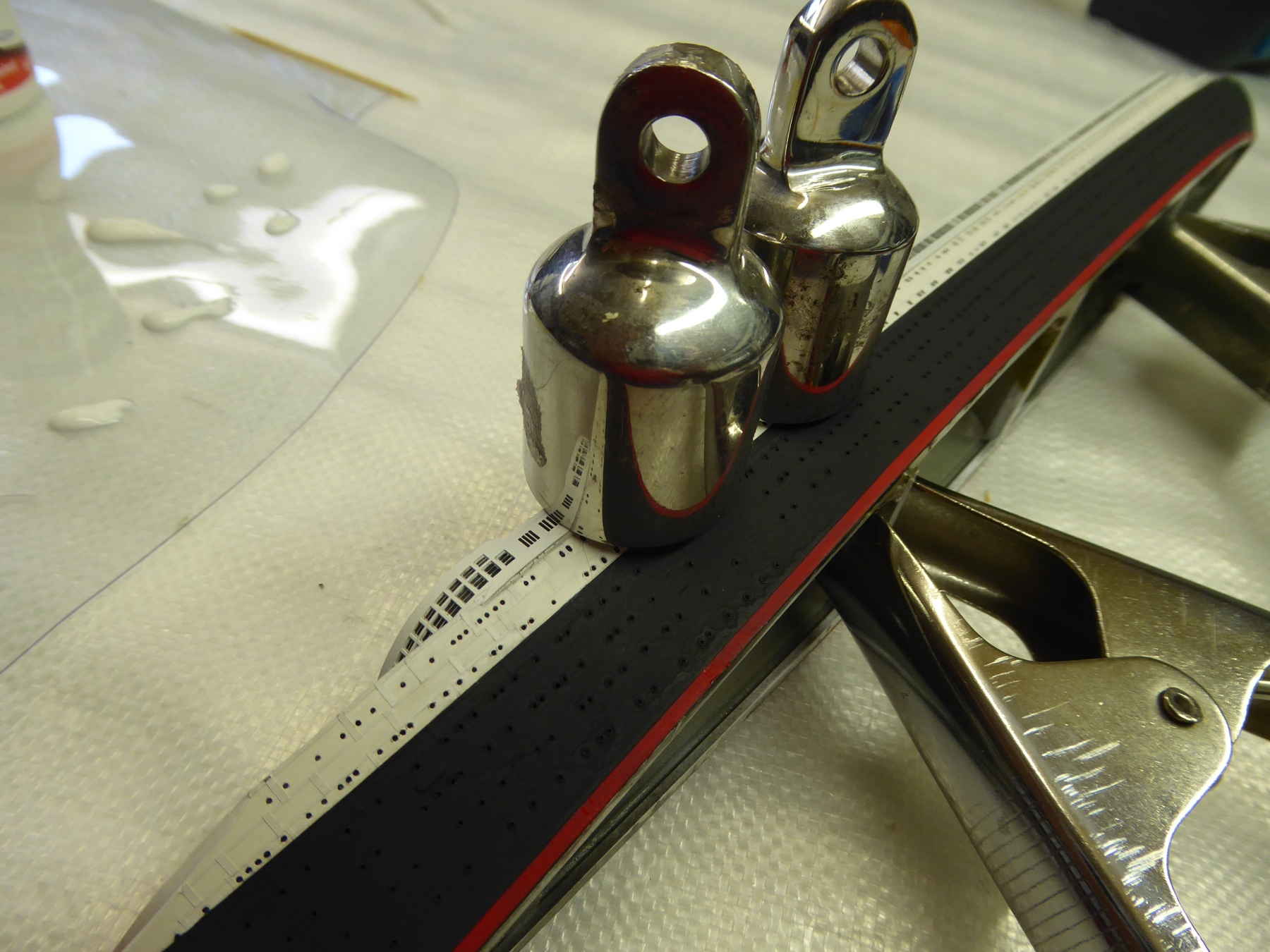

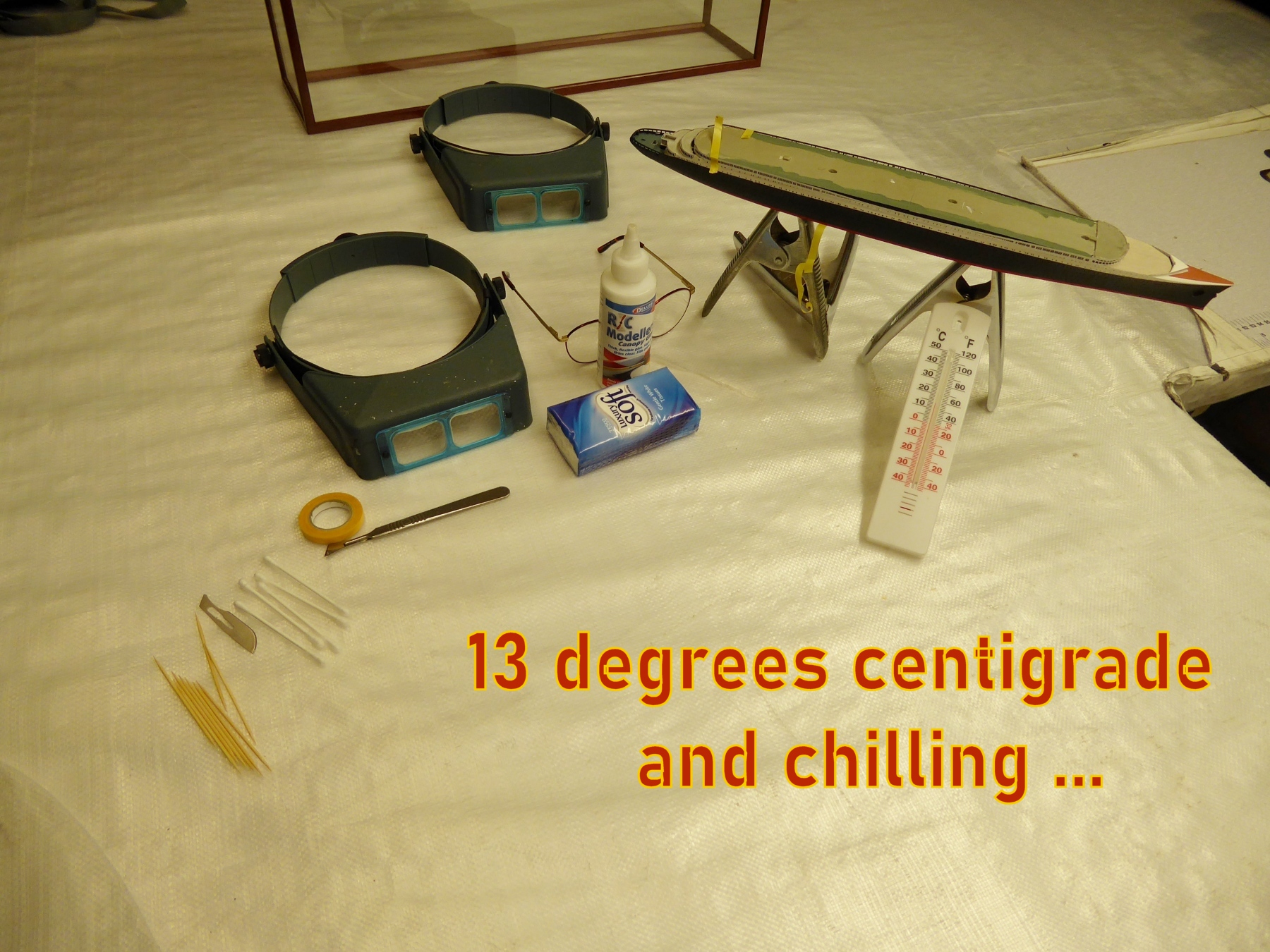

and a nice cold spell of weather meant I would not need to refrigerate the hull.
I placed the model in our sewing workshop overnight-- outside temperature was 08 degrees C
and inside the workshop overnight it dropped to around 10-11 degrees and the model reached pretty much that also

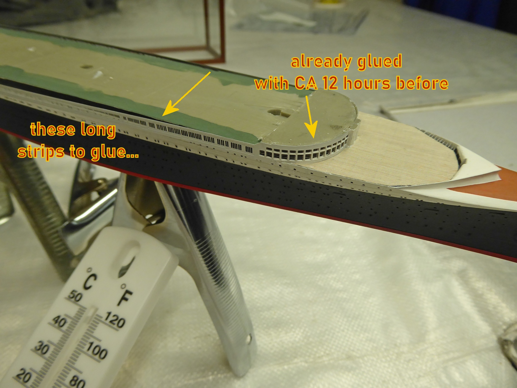

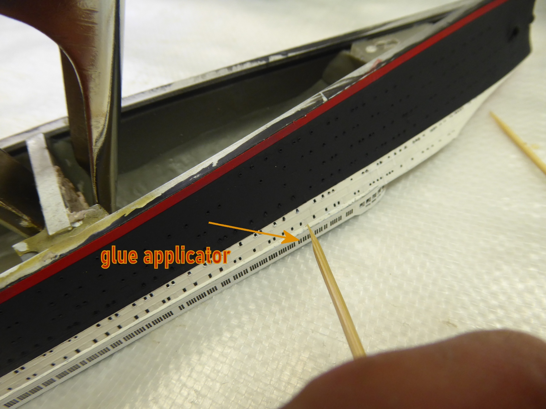

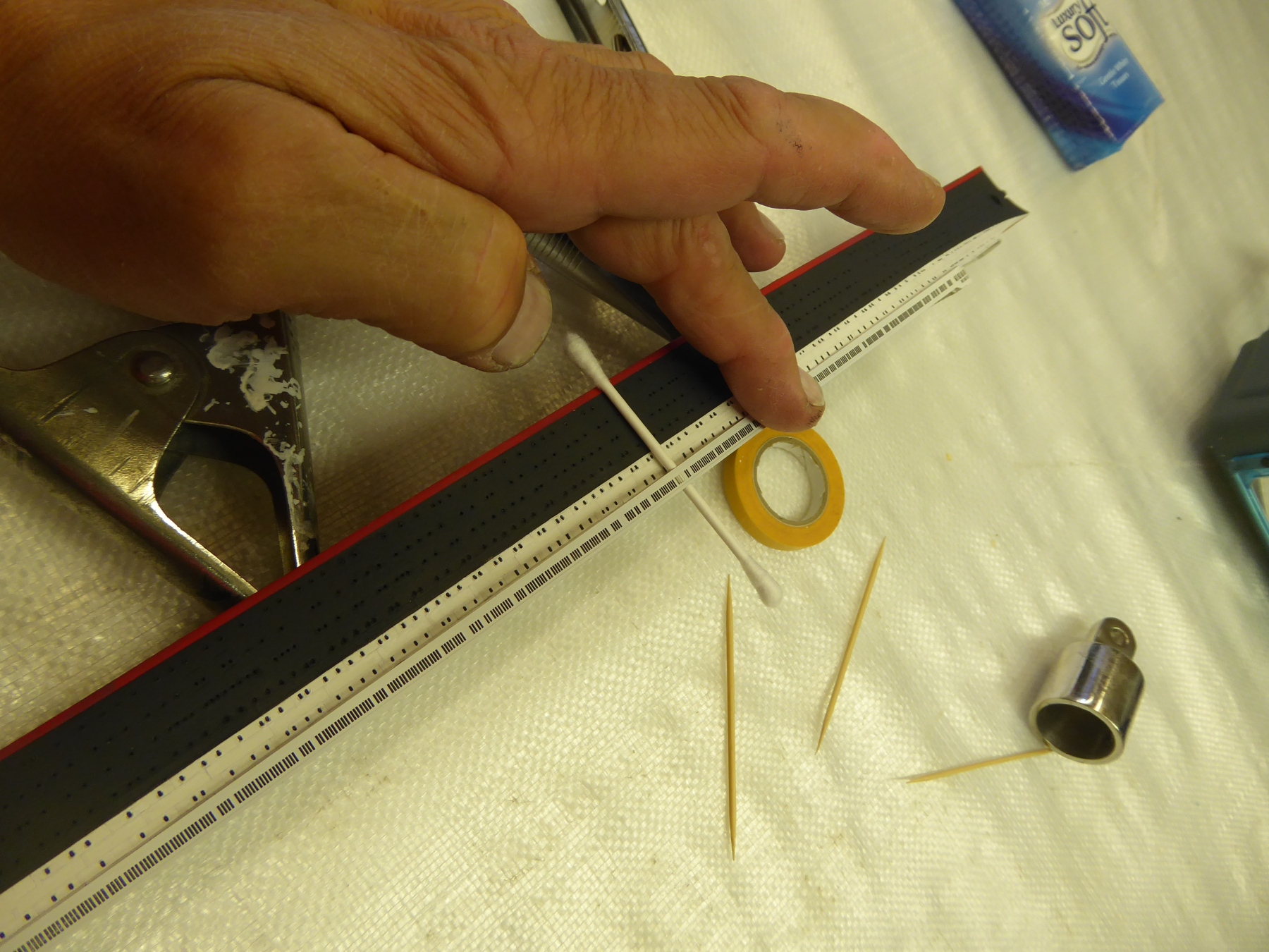

I had already secured the long promenade window strips with CA at the curved fwd end to anchor them
and now needed to glue on the long PE strips with the flexible ' canopy' glue
My experimentation , outsiders review of the canopy glue used with PE
... and my findings ....( from last December (!!!! ) recap here :
viewtopic.php?f=59&t=168156#p748951
Back to the present--
blade sharpened-to-chisel shaped point cocktail sticks where used to apply the canopy glue to top and bottom edges of the strip
--avoiding the window areas in between
...( a litte tricky ! )
The adhesive grabs very well--so I had to ensure the painted PE was lifted clear
as I proceeded... steadily----
==> with teeth chattering --not nerves-...just plain damn cold !
If all this does prevent thermo expansion issues of snaing/ buckling etc --
then the end effect probably is worth it !
Once both sides were secured and the ends taped,
careful back filling of adhesives in the voids was done from underneath !
( just as well the ship is not mounted in her seascape yet...!!! :big_grin:
localised weighing down helped keep it in plane
I shall now wait and see ...
Tomorrow evening the hull will be slowly warmed...
we shall see!
I will report back -hopefully with good news--- and thereby me still retaining the will to live !!!
wish me luck :wave_1:
JB

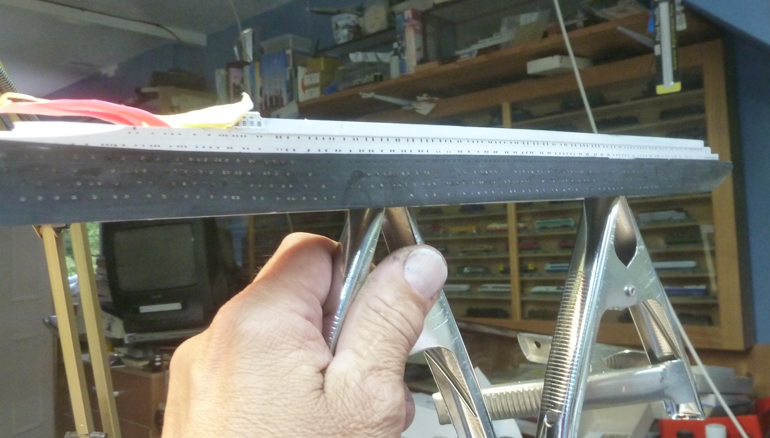

JIM BAUMANN
Posts: 5728
Good evening all gents ! ( and any ladies...)

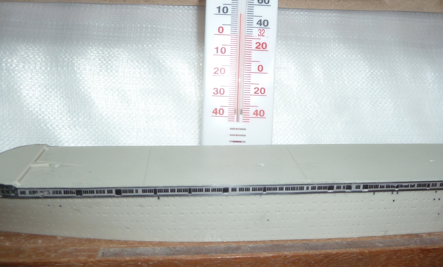

Well-- the weather in the UK is now cold
so the hull and its promenade deck overlays are experiencing the full gamut of
( very !) warm central heated evenings , pleasant daytime heating
and stone cold nights ( heating goes off at 11:30 pm and comes on at 8am)
modelroom has large windows and is not well insulated-
-so when heating goes off temperature falls drops very effectively to around 10 -12 deg C deg
I have studied the hull when cold at night ( with some trepidation in case of ' snaking')
and in the very warm evenings in the modelroom et al
amd I can report no sign of differential movement that is visible.

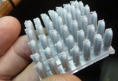

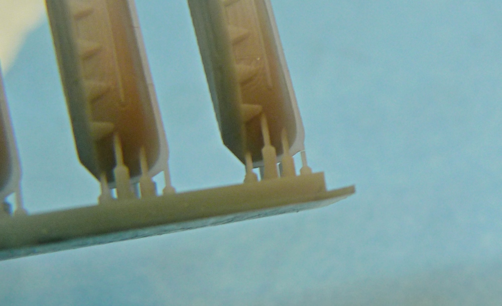

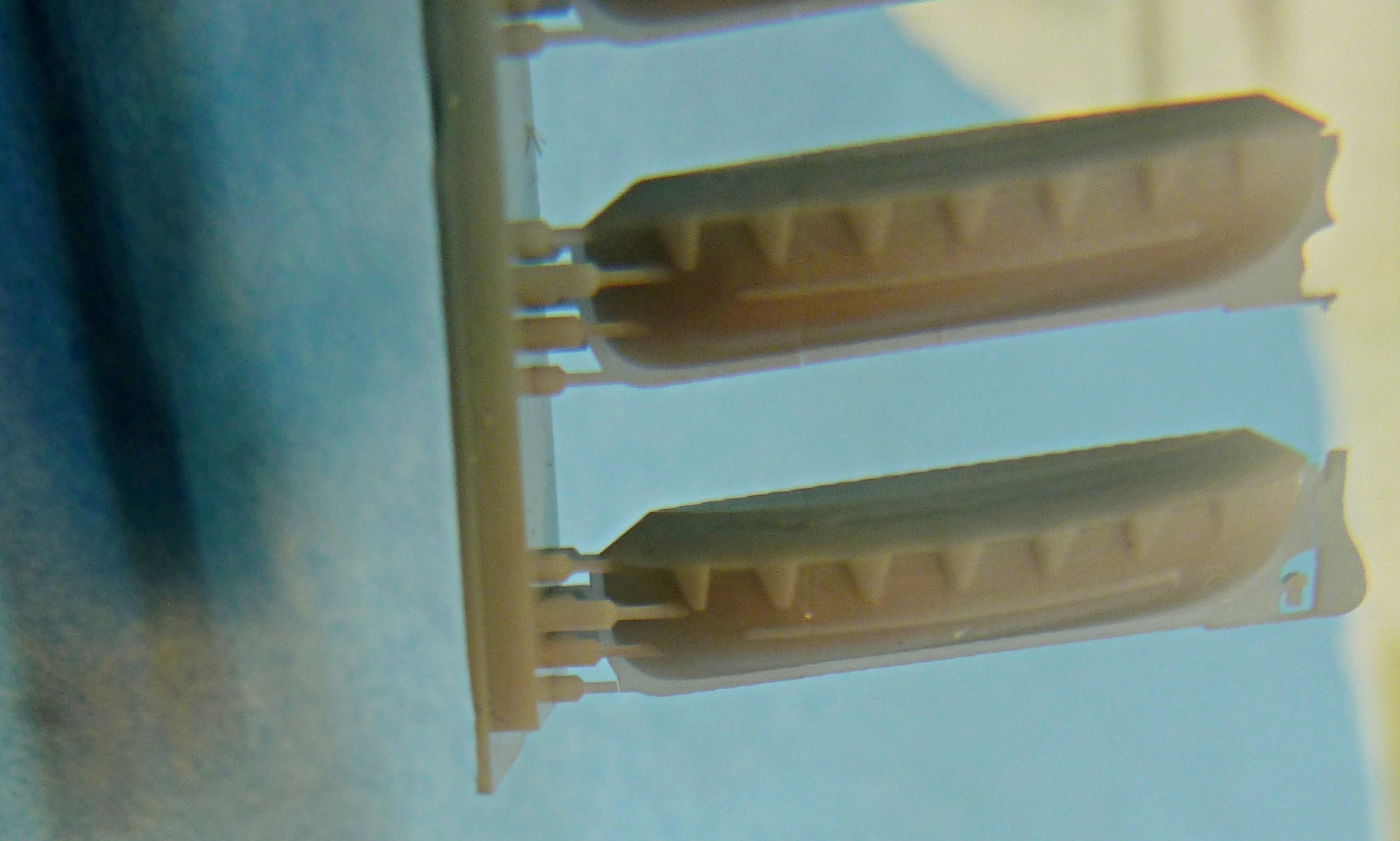

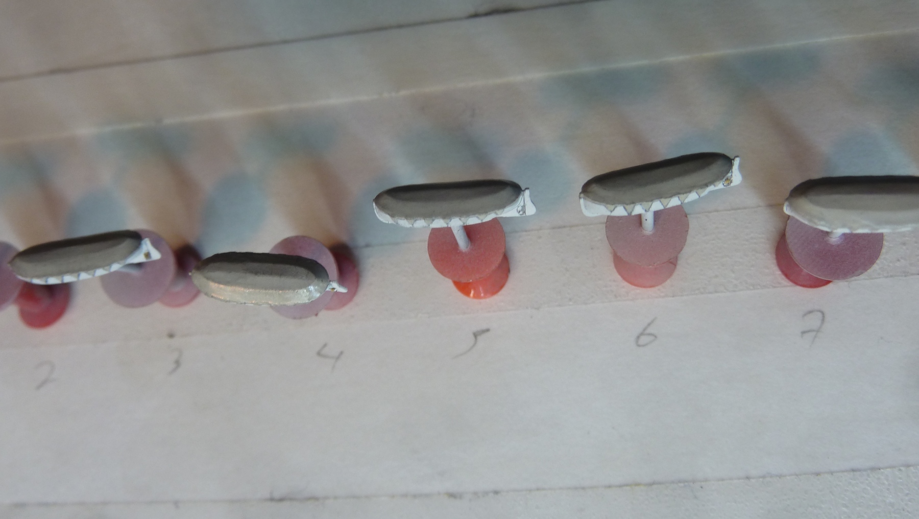

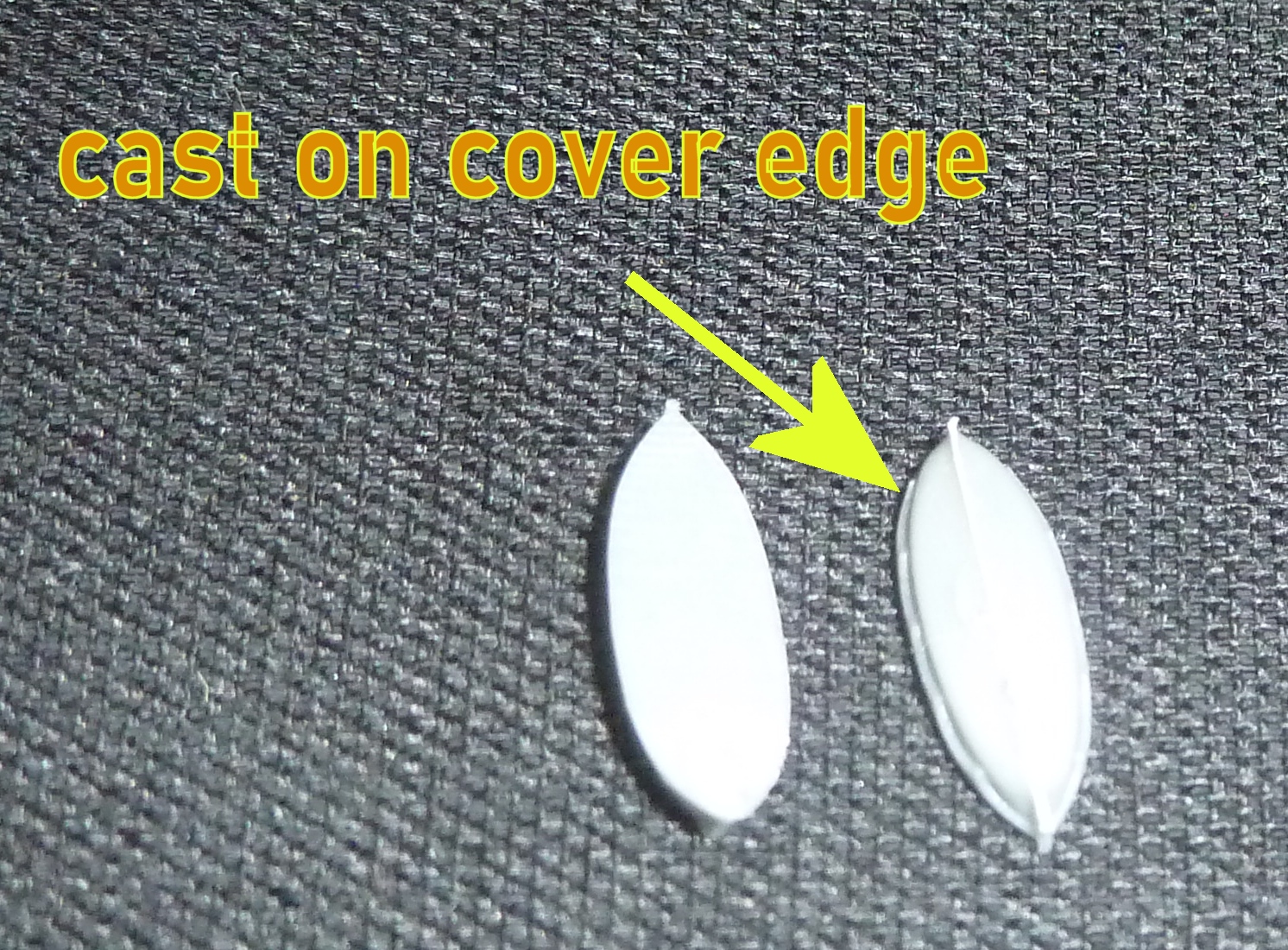

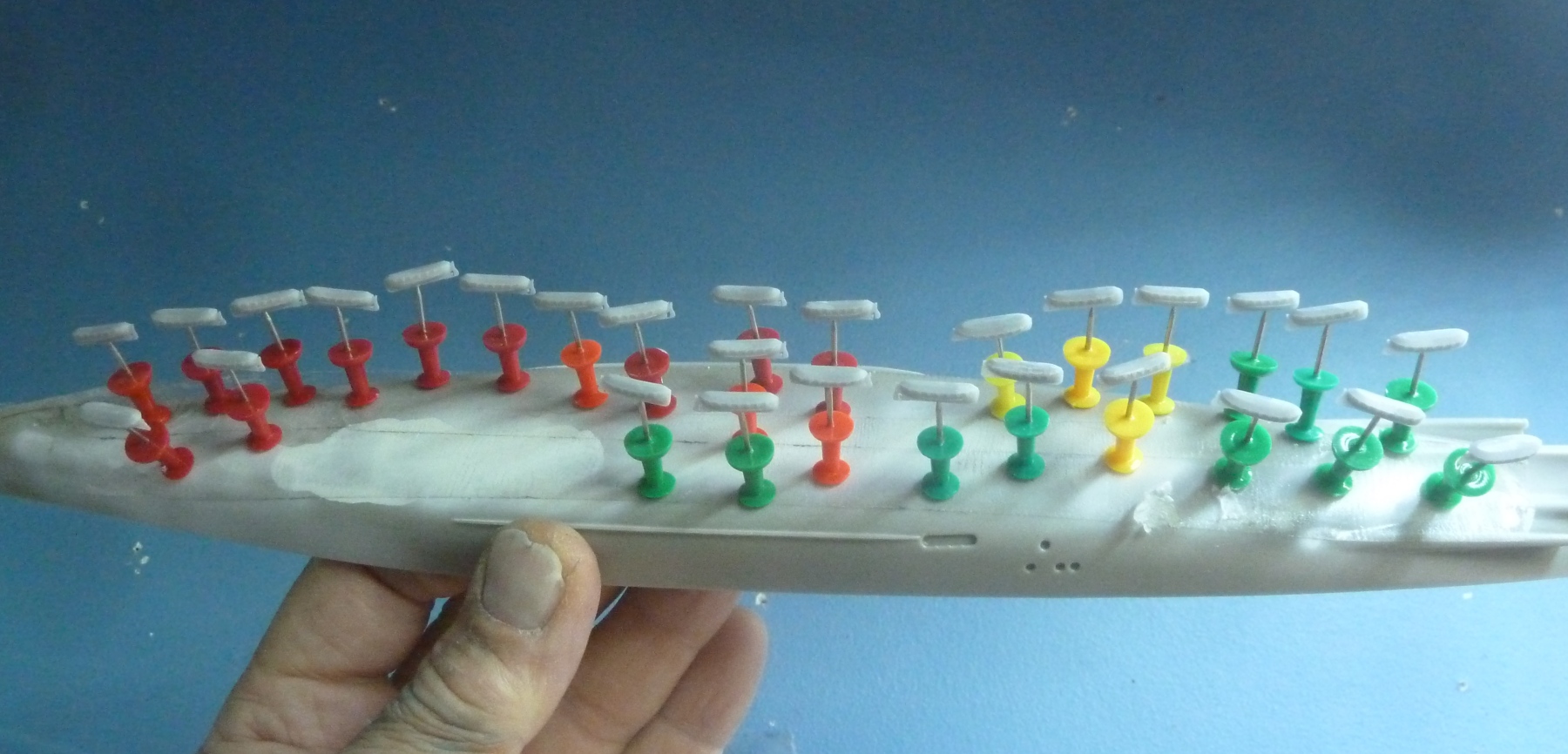

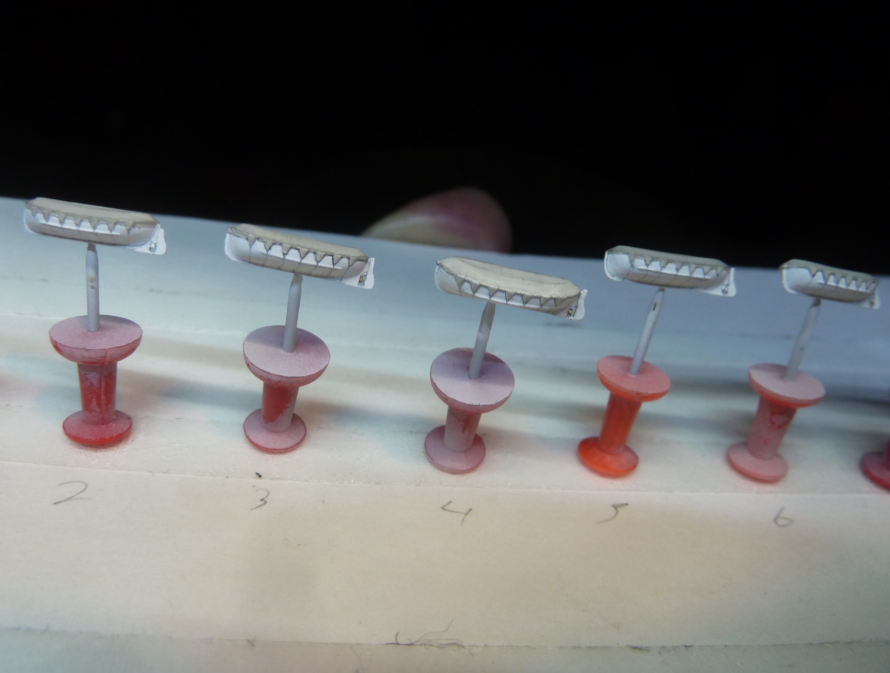

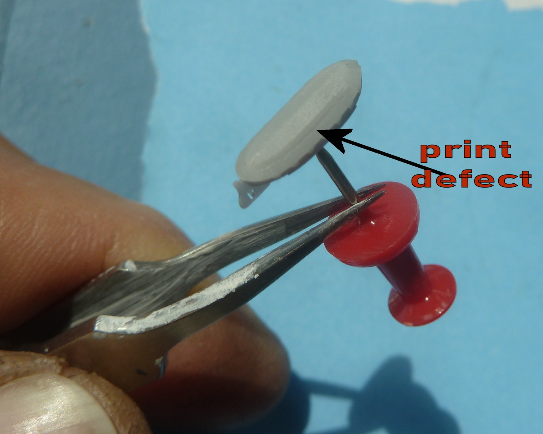

In the meantime I have been busy preparing the lifeboats; the kit items being rather undersized
and not completely correct in shape-
but the biggest issue was that the kit lifeboats are single boats--whereas the real ship has smaller boats nested inside the larger boats
and in the early version--at all times the boats had a cover that went over both boats
( light grey canvas for the pre-rebuild-- and a rather lurid orange for the second half of her career )
the launching methodology for the nested boats is illustrated here
I am fortunate in actually having a ( dog-eared!)
copy of the 'SHIPBUILDER Magazine of 1935 )
so was able to see how the real boats should look...
Now I was also fortunate in having a " friend " who drew and 3-D printed the required boats ,
:thumbs_up_1: :thumbs_up_1: :thumbs_up_1: :big_grin: :cool_2:
in fact more than double the number required were printed.
just as well-- !!! as despite effective packing from France-- the combined postal carriers of France and the UK had contrived
to drop something heavy on my boats- :Mad_6: - the result being a pretty spectacular rate of breakage of rudders and screws.==> requiring careful, finicky repairs
simply finding and keeping the broken parts-( On the sticky part of a post it note! )
-and identifying which boat had which rudder ( almost forensic examination of break patterns...!)
the boats were attached to the printing runner at the bows
which was a tricky bit of cleaning without loosing the contours of the bow and hull
handling the detached boats was another challenge
after clean up they were impaled on pushpins red and green...
The pin hole will not be visible ( on the inboard under side ) on the installed boat in the davits ( at least not without and endoscope and a mirror!!�)
I prepared double the required number so as to be able to pick and choose the best ones
( some of them had small printing defects which needed filling )
the airbrush was unable to shift the 3-D print material waste from paring,
sticky>?)
so resorted to self help tack sticks !!
They have had a coat of light grey as a guide coats which highlighted where more work was needed...
2 x white coats and the canvas next
will update.

JIM BAUMANN
Posts: 5728
Thank you for your words of encouragement Frank !
its a process of whittling the finalists down...
18 port-side boats that were deemed good enough actually need 13 per side
The processing was as follows, using a pencil ( H 3 pencil sanded to a chisel point on 2000 grit sandpaper)
Draw on on cover tie lines with pencil, accentuate the stem/keel/stern post deadwood with a fine pencil line
Draw on the hinge twixt rudder and sternpost, outline the screw aperture with pencil
Outline the cover tie down triangular gussets with pencil ( simulates the "stand off " shadow ( I reckon anyhow! :big_grin: )
Paint the gussets and the top of the covers.
When dry--
with pencil dust on brush outline the shape of the cover over the nested smaller boat .
Then wipe with thinners on brush to soften the outlines and add a bit of colour variance
with a white paint-and-thinners wash tone down the cover ties and outlines etc
Discard the less happy lifeboats !
Still to do....
paint the screws a dull dark beige to simulate lightly tarnished brass
and touch up where needed.
Oh... and repeat the whole process for the starboard side ... ! :Mad_6:

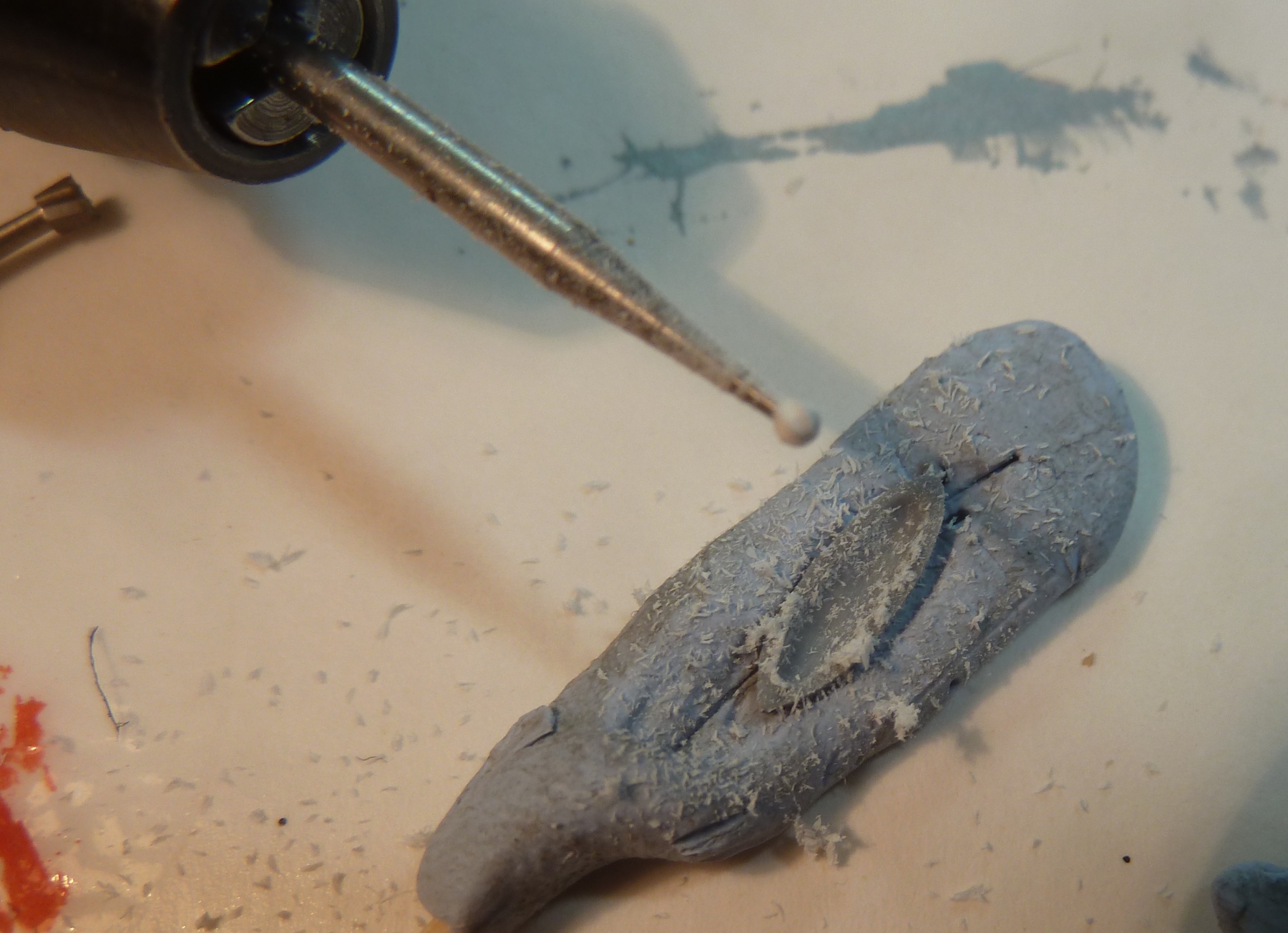

The two seaboats at the fwd end of the boat deck; were open -without covers.
The original kit resin boats were not a bad outline shape, but a bit fat in the beam and of course solid topped.
The fatness was due to the cast on cover tie downs being rather thick
Once this was pared away the boats were a pretty good shape
There-after it was time to hollow them out....
This was fraught--but successful ==> with small burr in a motor tool
and thereafter the coamings will be be scraped thinner with a blade
